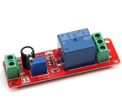

I never used the fogs but kinda remember the front/rear fog switches were somehow interconnected where rear would only work with front - or the other way round.
Might put tiny fronts under the bumper then I won't need to worry about how the switches are arranged

I think it must be that the fronts will not work without rears. As rears are the only legal reqt.
I fitted rears on the Kobra and more modern than P700 headlights. It would be a very rare trip to drive mine at night and definitely not in fog.
