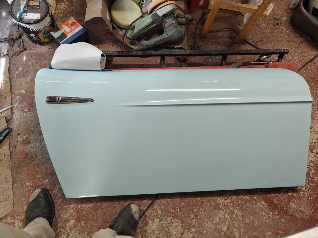

First door on, worked a treat - offered up the door card to work out how to get it back on .... and .... deadlocked the car :(

So the door card is on and you can't get a hand inside to see if you can loosen the pull-cable to the lock? Did you fit the pull-cable too tight?
Piran
Oct 21, 2022
41
Sorry. Don't know. Post I saw about that wire-on-battery trick didn't mention there being a difference.
No I didn't get the door card on in the end so I put it to one side. I can get my hand inside and there doesn't seem to be any tightness on the cable - it worked the first 10 times without a problem.

That lever in the door. The one that, people say, causes the deadlock. Get your hand in and push it back (towards the inside of the car). Make sure it's all the way back. I think there's a return spring inside the catch but not very strong. Maybe the 'pull-cable' method needs an additional return spring behind that lever.

Yeah, tried that, next step is to try unhooking the cable from the new handle but I don't think thats restricting the movement. Of course I can't get much off until I can open the door

Ok, got the cable off and the door opened. Have tried moving the attachment point forward to get a bit of play, put it back on and it's opened a few times. Now to put things back together and start the next door 😔

Do you think it was tension on the cable that caused it? You said it didn't feel tight.
