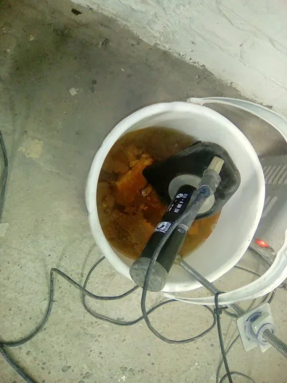

that is some lumpy soup - no wonder you needed to electrocute it ...Got the inside of the boot lid painted today, this should dry a nice satin as I mixed the lacquer with matting paste, I will be doing the engine bay in the same shade of grey
And thanks to our @Faheem I made myself a little kit, its bloody brilliant
