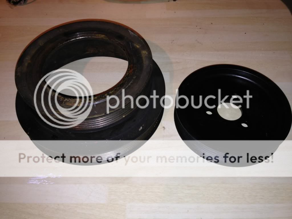

I've now got the merc drive pulley for the charger which I'll be modifying to fit the power steering pump. Although when I held it next to the oe pump pulley the inner pulley on the merc pulley which I was going to machine off is nearly the same diameter of the oe pas pulley. So what I'm wondering is would the inner pulley on the merc one do my zeds power steering as well with it being about 5mm larger in diameter? I know this will make the pump spin slightly slower I'll have to work out the ratios when I can measure it more accurately. Will this affect the steering too much or not?
Oe pulley in my hand vs merc pulley which will be cut down to the side of the small pulley.

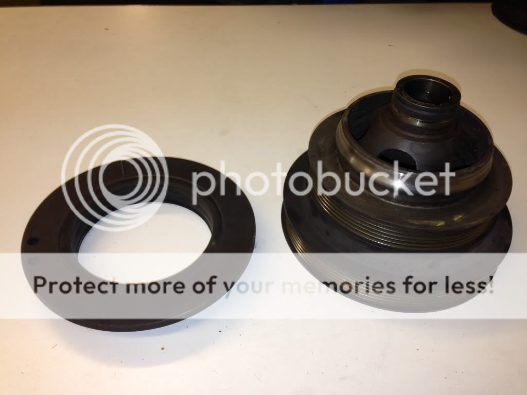

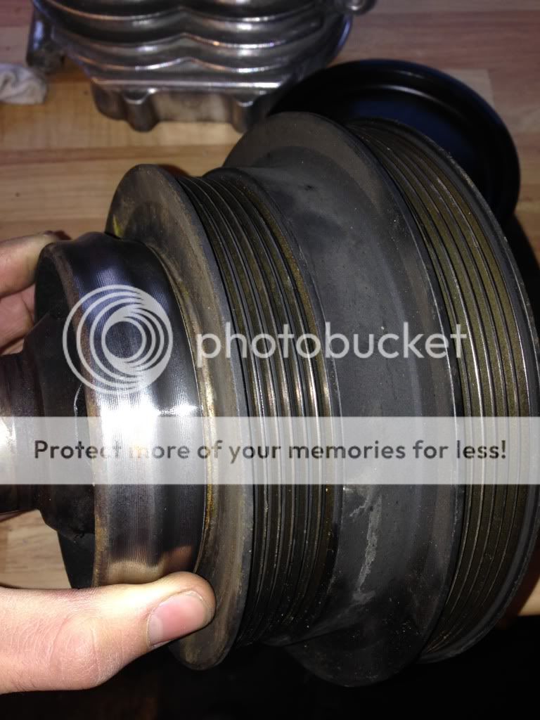

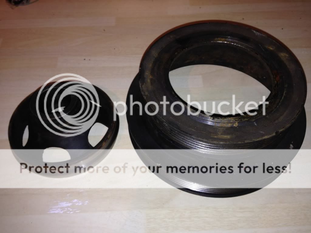

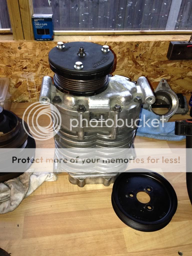

Got a bit of work done on the pulleys. I've converted the electromagnetic clutch by drilling and tapping some holes to make it direct drive. Also the lower pulley which is going to drive the PAS and supercharger has had the harmonic balancer removed and been machined down. I now just have to make a new plate for the centre so it's the right offset to marry upto the existing pulley mount.
Charger with pulley converted to direct drive
Harmonic balancer removed
Pulley machined down
Pulley centre to replicate for PAS pump
