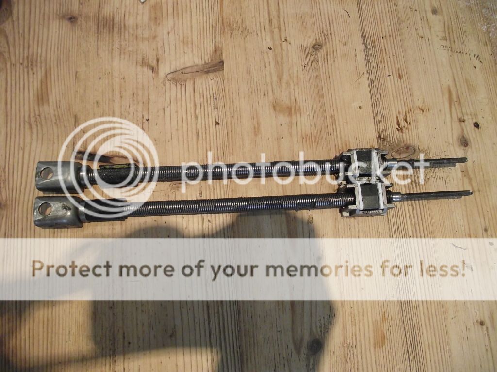

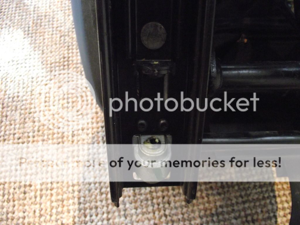

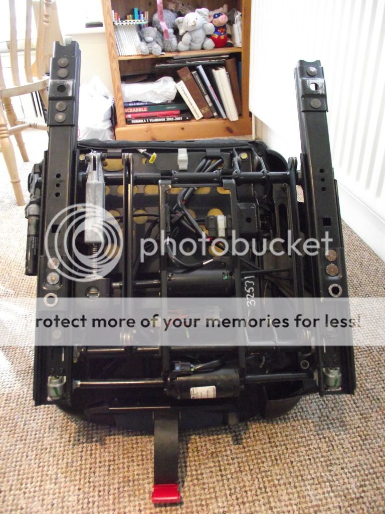

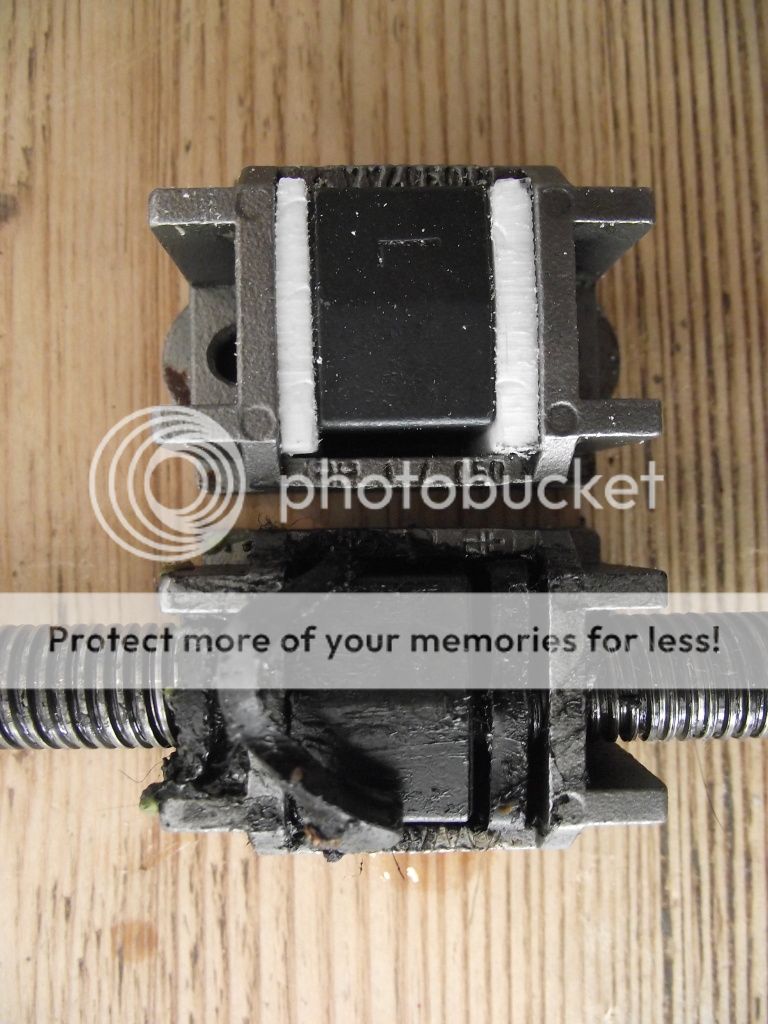

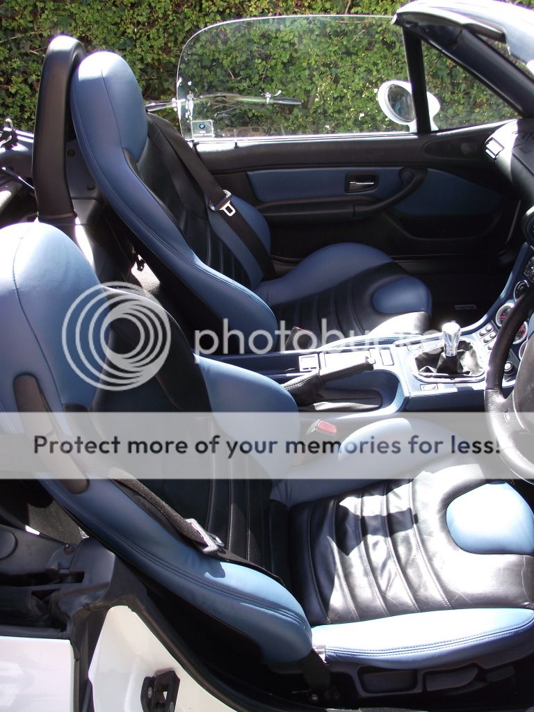

Well this morning I finally got round to finishing the seats. I've put new seat bushes in and got them plonked in the car.
Old and new:
The threaded block which the new bushes have to be sanded down to fit either side:
Underneath with the threaded bars removed:
The threaded bars there's a left and right thread so don't mix them up ;)
Collar where the square shaped spring locates on the thread:
The bushes were very easy to do all you need is some rough sandpaper, a T25 and a T50 torx bit.
Unbolt the three bolts one T50 and 2 T25's on each side slide the runner up and pull the thread at the same time.
There not amazing but a damn sight better than before:

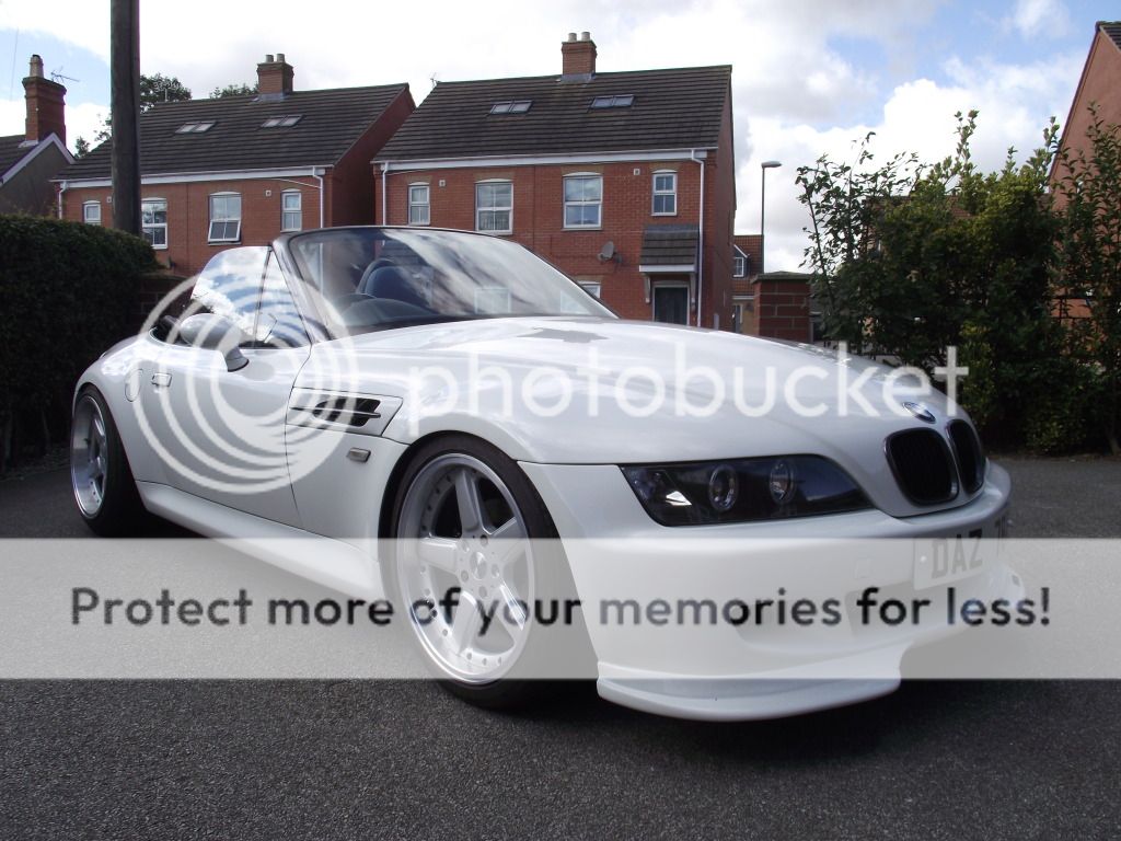

Re: My 2.8 Alpine White III Progress

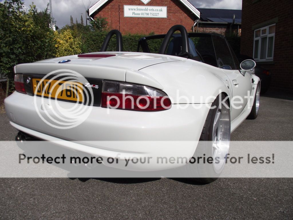

Got the hardtop sprayed this weekend due to a slight problem. I had re-dyed the roof and planned to put a new rear window in however when I removed the old window I found the zip is knackered so I'll be getting a new hood at some point. If anyone wants to buy a zip in rear window drop me a pm ;)
I'm planning on getting the car MOT'd this week so we'll finally be on the road whoop whoop :coolsteer)
Next thing on the list is to spray the wheel centres graphite but not till next year.
