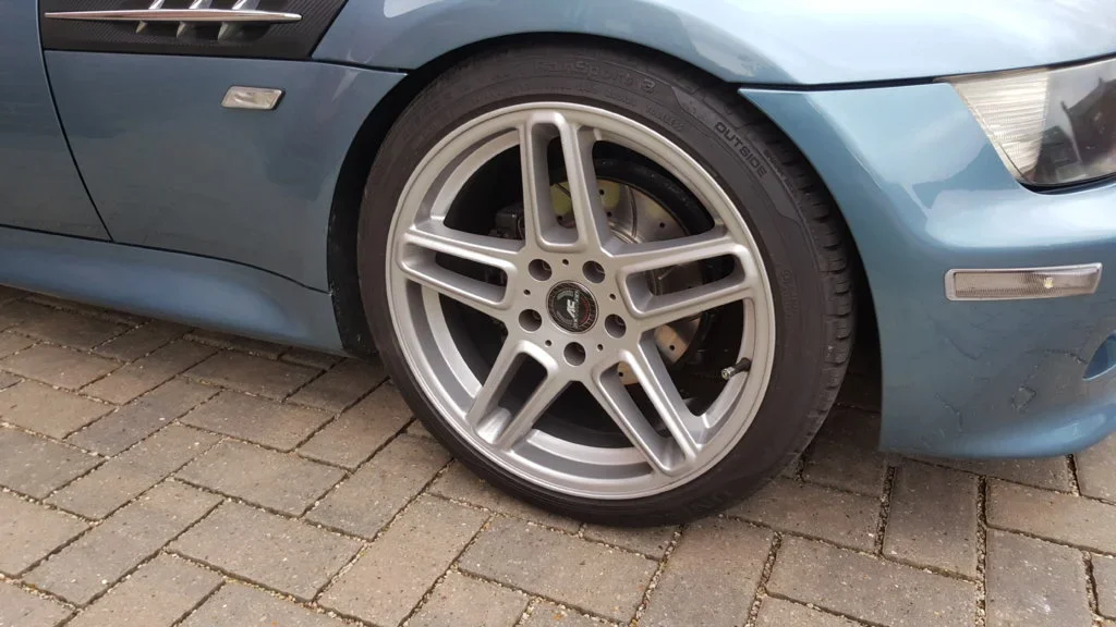

Just thought i'd add my updated.
Fitted @Southernboy Gear surround a nicely made bit of trim looks at home.
Have been looking at getting the brakes sorted and came across a seller that was selling a complete set up cheap and thought i'd give it a whirl.
Arrived this morning.....
Not a bad job to do and a couple of hours fitting the four corners and a good drive out to get them to bed in and happy with the look and they work well.
Will get them all painted over the winter they are already painted but may change the caliper colour as well .

Neat brakes ! And I really like the wheels too. Maybe some caliper paint is next ??

Looking great Ant, Who is the seller for the brakes as I need a full set also.

They are virtually bedded mate they where terrible when they where first used but they are working great now :thumbsup:
The first time i applied them it just sailed on but i picked a striaght open road .

Looks great, I'm thinking off upgrading the brakes again on mine. Seen a similar set somewhere, what are the mintex pads like? Have the grooved discs made a big difference also?
Its still early days really ive used Mintex pads before and they have been ok the discs are made by a company called LPB not found alot on them but they where cheap enough to give ago maybe Chinese but then theres not mich that isn't nowadays.
They feel good under foot quite progressive but you can feel the bite at low pressure and seemed to stop the 2.8 with ease from speed i suppose its a time will tell purchase .

Im thinking maybe blue Jim but not sure yet will have a look and see what may suit.
