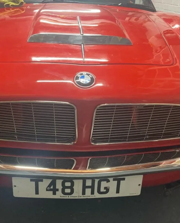

A couple of bonnet upgrades. The air intake is wrap but will be changed to either Ali or Stainless steel later on. The streaks up the bonnet are stainless. I think the upper one is too long but will see how it looks once I get the car outside
Watching with interest - I'm hoping to start my build soon. What did you use for the strips on the bonnet? are they off a herald (like the door handles)?
looking fantastic🙂👍
Yes, the bonnet stripe is a herald. I have a spare one for sale if you need one. The large section is aluminium plate buffed up to a high shine. I think I’ll add some black vinyl rectangles to make it look as if it’s an air vent

One of my other projects is a herald so I have a few spare :) but thanks. Still working on ideas for the large section. Shame that the original ideas for the door handles didn't work out.

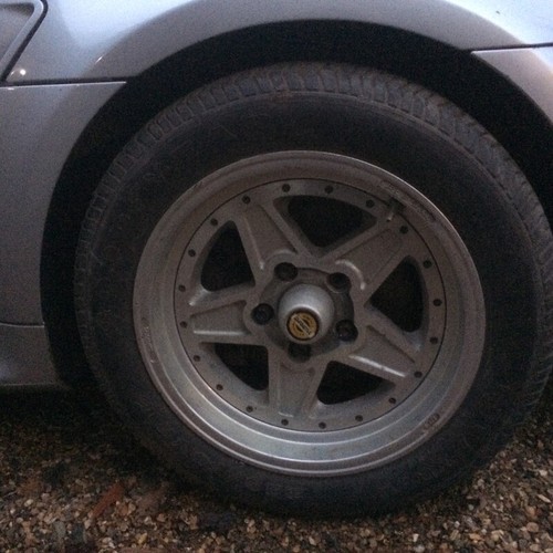

Pingu, I have some alloys available that I bought for my 365 project, they could work on your car.
I need 17" as I have M calipers. I've tried 16" and they don't fit.
