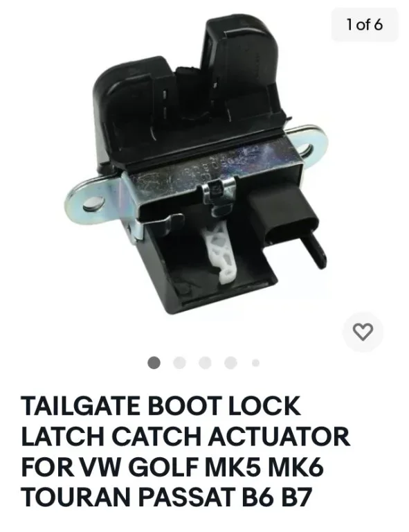

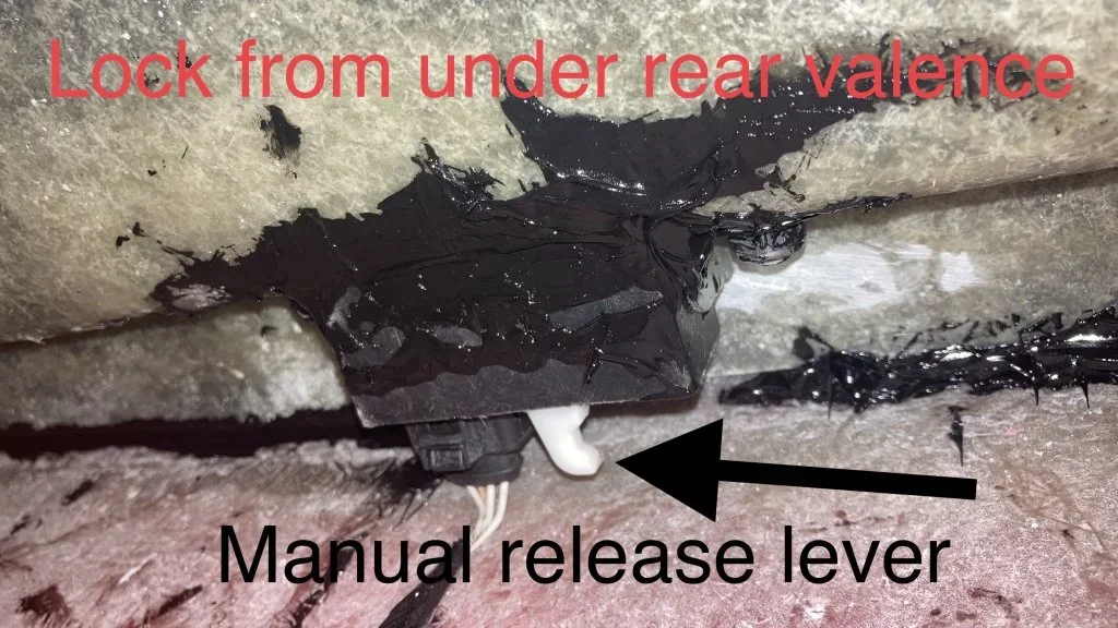

I can’t recall if there were 3 or 4 wwires on the fiat 500 handle under the foam gasket. It was easy to split these into pairs as I think there was a common ground for the boot handle and lights. I thought it best to keep the circuits separate.
the lock is from a Golf or Passat and has 4 wires. Using a multimeter meter and a battery it was quick to work out which two wires operate it. (Brown was earth and three white wires)
I ran the wires into the car first so I could fit an immobiliser switch to keep the boot locked then back upto the handle and out to the lock

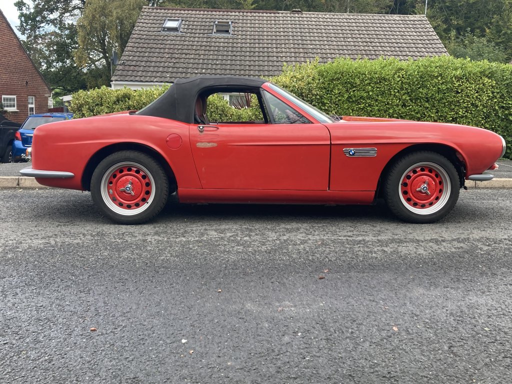

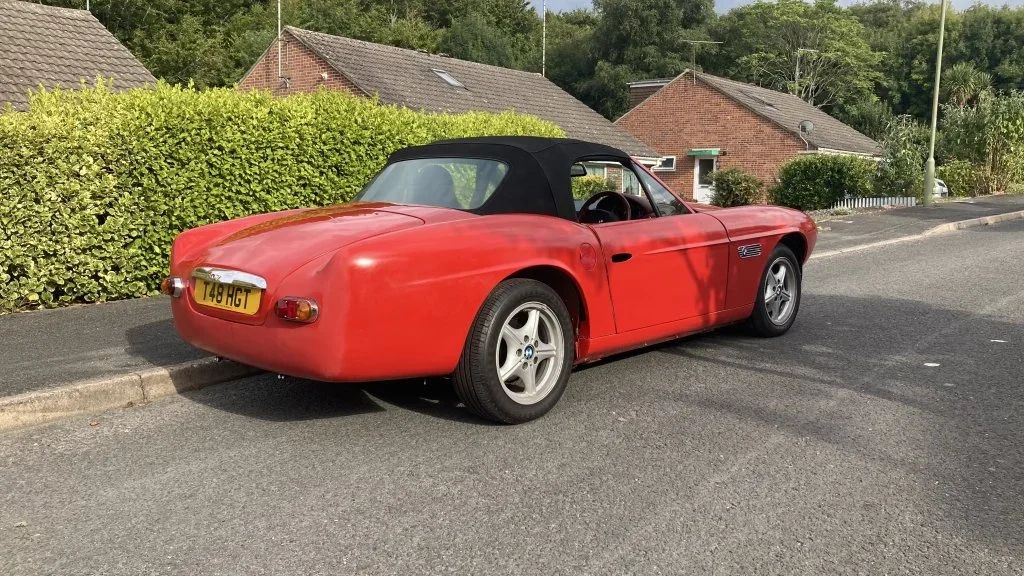

Here’s the wheels fitted with centre caps and spinners in place.
door handle changed to a Triumph Herald as the original Alfa Romeo I wanted to use proved too problematic.
basically it only had a 10mm push action which wasn’t enough to operate the lock and allow the central locking to still operate. This handle has approx 25mm plunger and works fine.
Door skin will be tidied up in due course

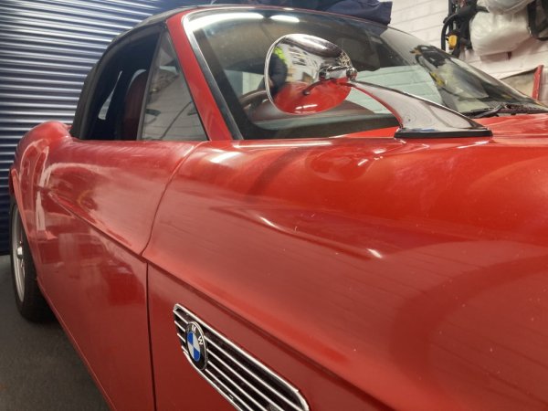

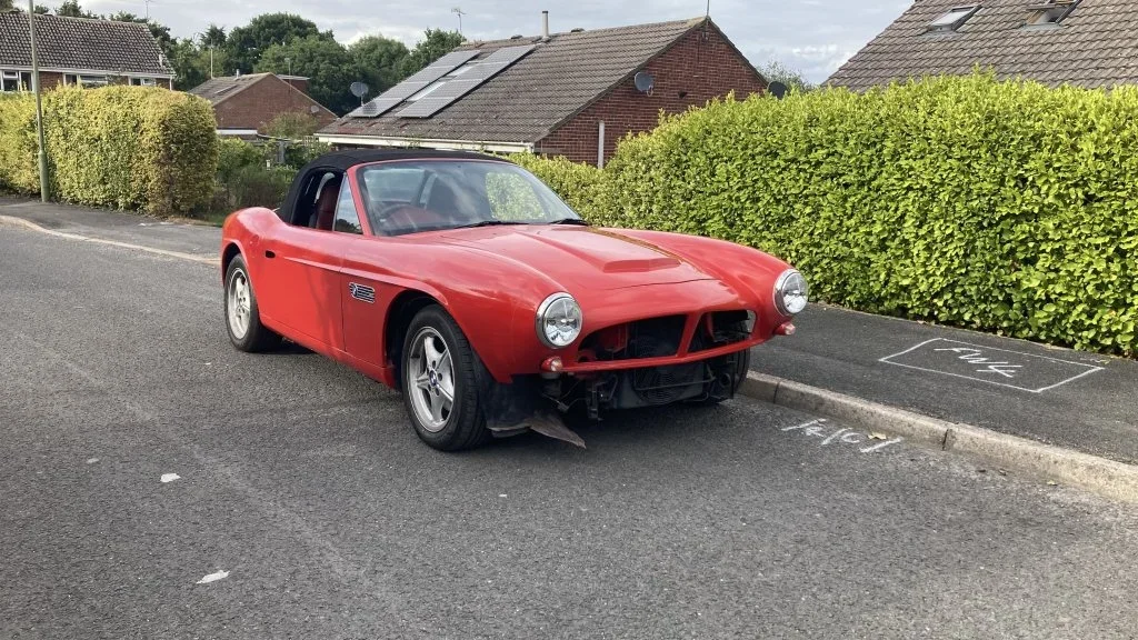

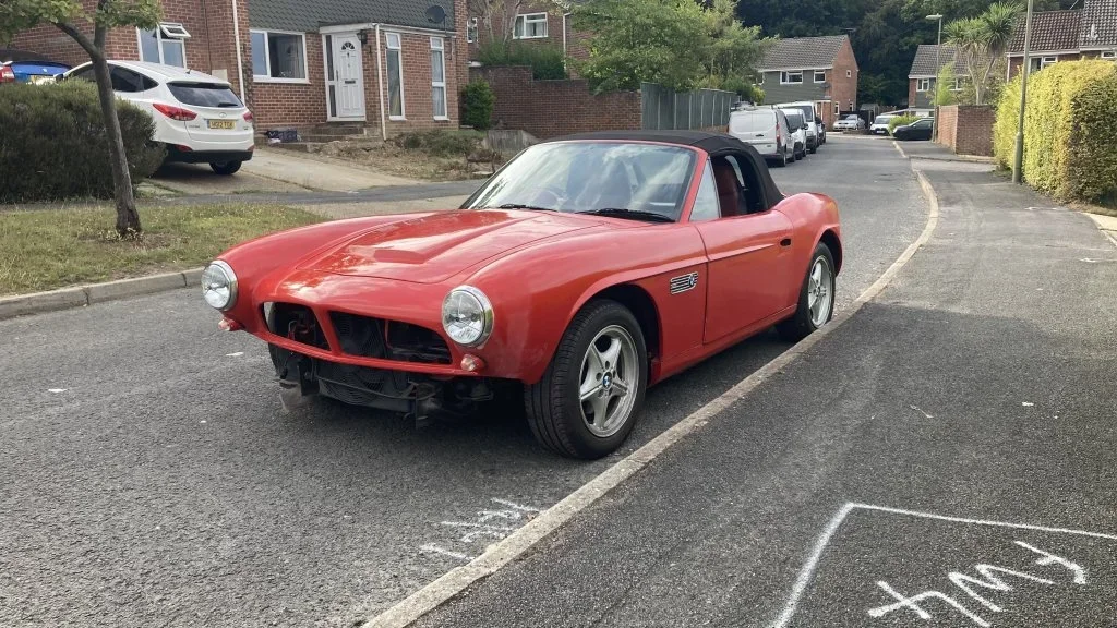

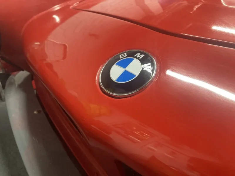

Door skins just getting ready for final fit. Bonnet badge recessed in traditional bmw style.
lower front valence fitted with number plate, and wing mirror installed. Nearly mot time 😁

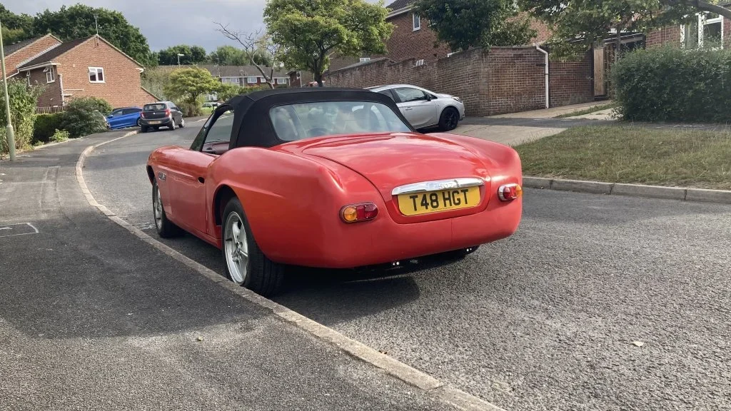

I’ve bought a rubber boot seal from Woolies which should clip on the grp. I will put seam sealer inside it to make sure it’s water tight and fingers crossed the water will run to the bottom edge. I will do the same on the bonnet infill too, so the engine bay doesn’t get soaked

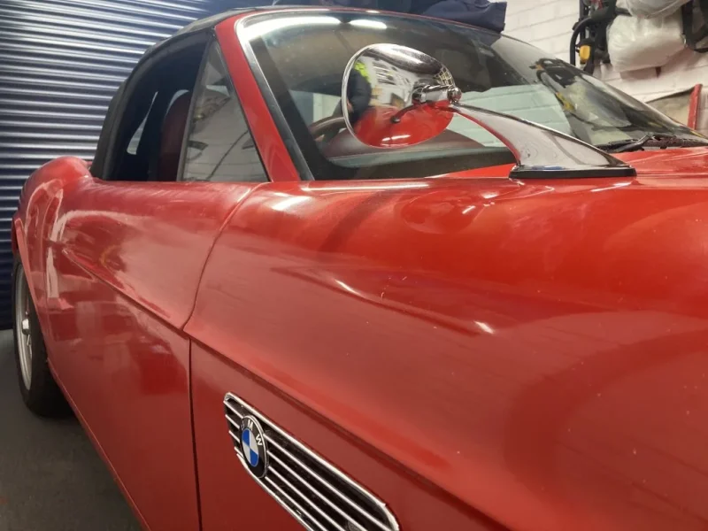

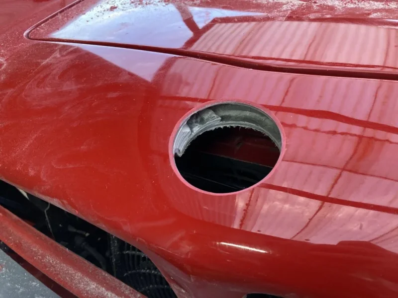

You may want to rethink the wing mirrors. They give a very poor rear view, door mirrors are far superior.
I have wing mirrors on my old Jag and they are pretty much useless so I also have small overtaking mirrors on the doors. Ideally I would like two remove the wing mirrors and fit door mirrors but that will entail welding up the holes on the wings and getting them repainted.
If you as Chris for a little gel coat you will be able to fill any holes in and match the finish/colour perfectly.
How did you resolve the door opening?
I went with the wing mirror as it mirrors the original cars, not for actual use and practicality. 😁
I'm not sure you know what I mean. I think you are talking about the boot leaking - I don't mean that.
When it rains the rain may sit on the boot. When you open the boot lid, that water goes in the boot. It looks like your problem won't be as bad as mine, as your boot slopes and the rain may just slide off it.
I think the boot slopes enough in all directions that it shouldn’t lay on the bootlid.
Fingers crossed it’s ok
