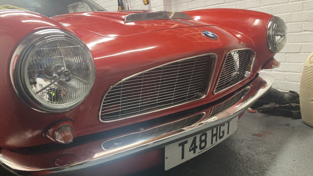

Well I’m told the bumpers and grill are now ready for collection so a 5 hour round trip to collect them tomorrow. Passenger door should be mounted by the end of the weekend, maybe drivers door too if time allows, and then it’s ready to go for mot.

I used Chrome Spray in Basildon, but have since found ChromeFast in Essex and Prochrome in Derbyshire.
my turnaround time was nearly 4 months which wasn’t a problem on this occasion but I’d hope to find a quicker place next time I need parts painted.

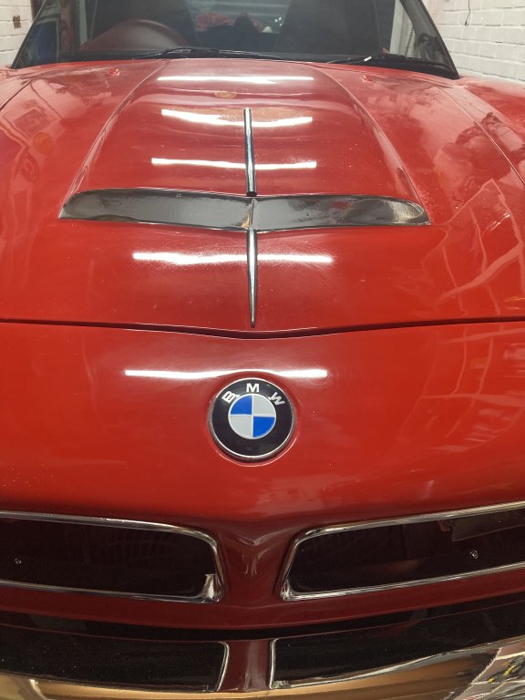

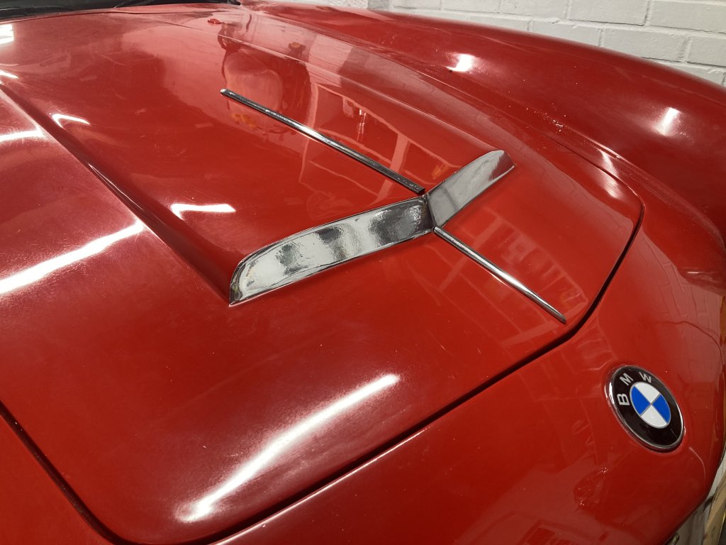

A couple of bonnet upgrades. The air intake is wrap but will be changed to either Ali or Stainless steel later on. The streaks up the bonnet are stainless. I think the upper one is too long but will see how it looks once I get the car outside
