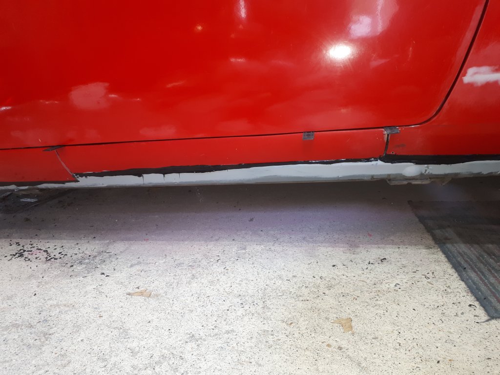

Body and sills all bonded and lined up. I had to cut and re-make the sills, as they were a Country mile off fitting when attached to the shell.
Lots of tidying excess Tigerseal and filling/ blending the joins but it all fits quite well now. The sill pieces don't line up at the bottom, but these will be hidden by a slim stainless steel cover, then painted black below that on the original car sills.
Just have to re-enforce and close the gaps on the rear where the GRP meets the Z3 boot.

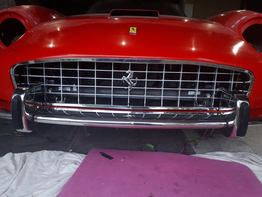

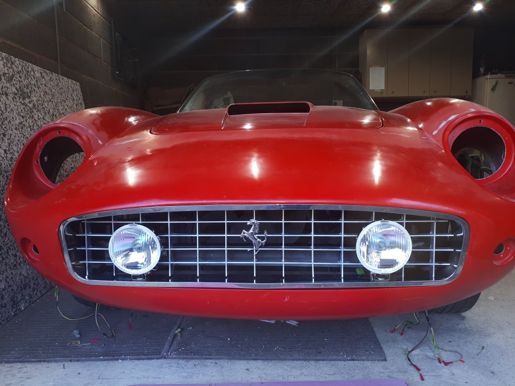

I have spent the last few weeks trial fitting all the exterior ancilliaries.
Front bumper, lights, intake cowl and grille and of course the all-important badges.;)

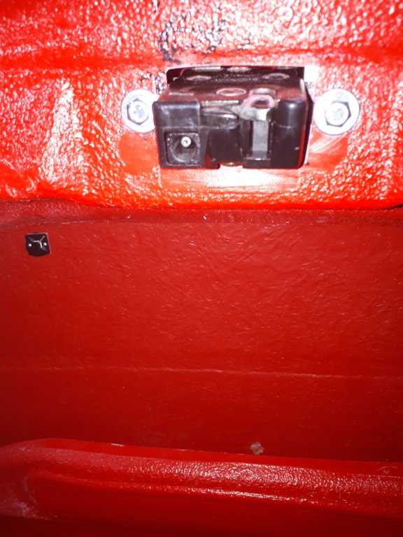

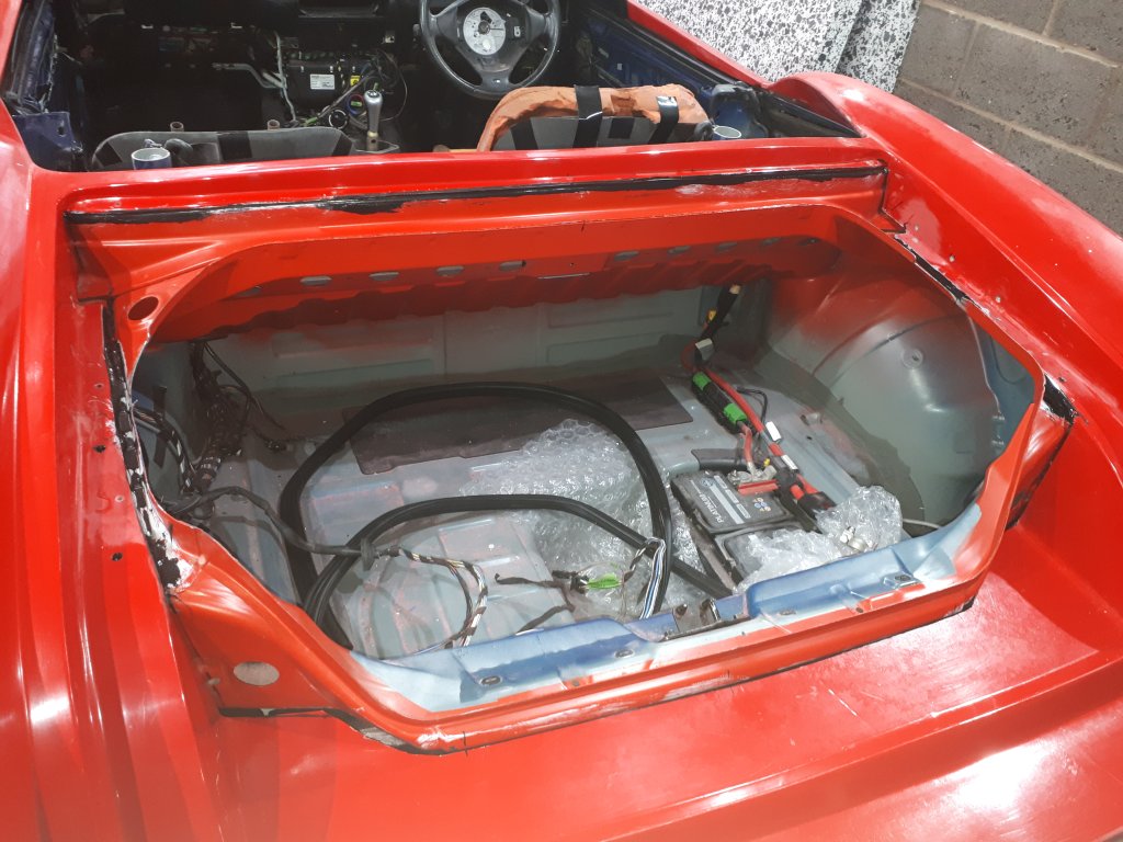

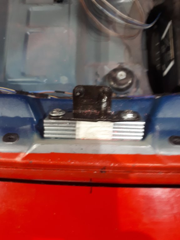

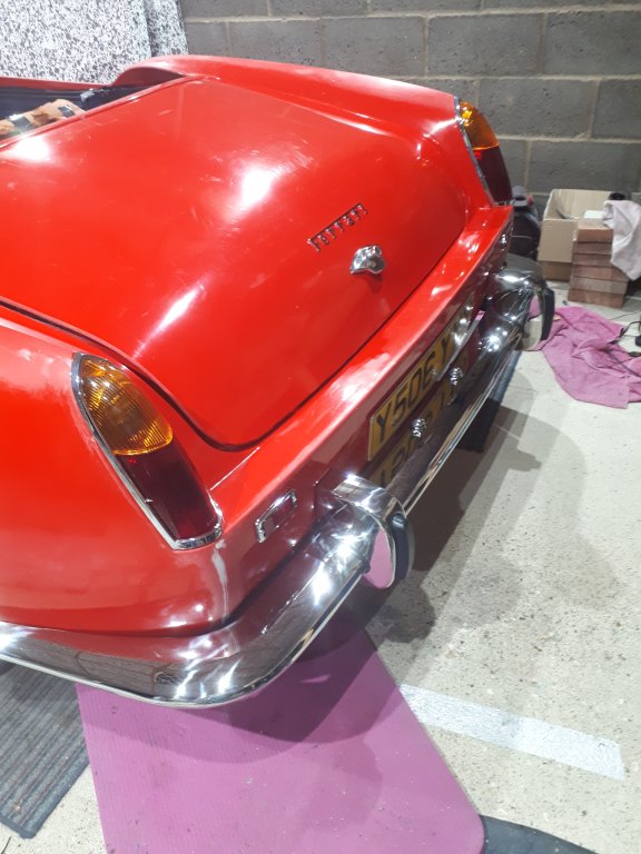

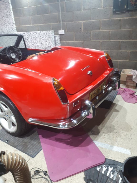

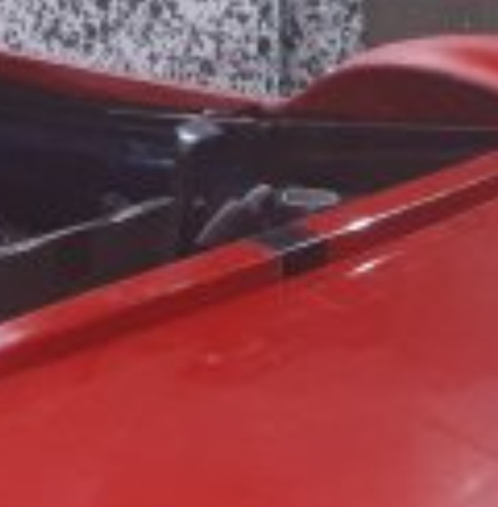

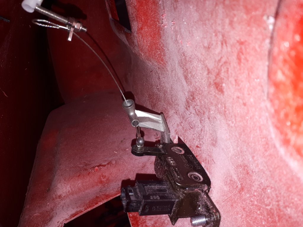

I have finally fitted the rear bumper, lights, and boot latch/ mechanism. Latch mechanism and boot lock assembly is from Russell @ Grassbank. It works well although is a pig to fit but that is the car, not anything to do with Russell.
My nemesis, the bootlid, still needs work (bodyshop are doing that as I have run out of ideas with it) but it shuts and locks now.

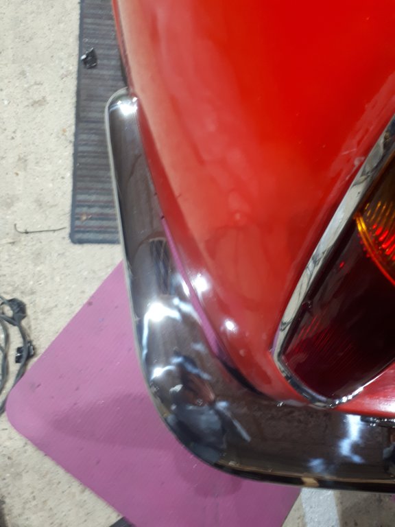

The rear bumper needed a LOT of grinding back on the nearside quarter, as the angle was wrong, so it hit the car body. I chose to go with overriders, as I find it more of a 1960s authentic look. They were an absolute pain (front and rear). Drilling polished stainless is hard enough; trying to drill it on a 'point' is much more difficult. I had to buy a really expensive set of cobalt drill bits, as my others wouldn't touch it.
One major advantage, though, is that I drilled all the way through the bumper mounting bracket and bolted the overriders to the bracket, thus giving a strong mechanical fixing for the bumper in two places aswell. The bumper has also been Tiger-sealed to the bracket.
The bumper returns on the rear are quite long, need some support and were not square. I shaped some treated pieces of timber, bonded those to the inside of the bumpers, covered them in Tigerseal and painted it (to prevent rot in future). I then used two woodscrews either side to fix through the GRP and into the timber. They are virtually invisible and make everything nice and solid.
I had to pack out the boot clasp by a LOT (around 20mm) to line-up the latch. I will make it prettier later.
The rear (apart from the bootlid) is done and ready to dismantle everything and be painted.
I need to sort out fixings for the headlight covers and shape the stainless covers over them, as they don't fit neatly at present. Then the front is done and ready for paint.
A few pictures of the bling and Grassbank's boot mechanism for your delight... some pics are a bit fuzzy; I have an old phone!

Thanks for all the detail, especially the boot lock, I need to take a closer look at the Grassbank lock, will do this when I dismantle mine.
Duncodin
Sep 8, 2021
139
Pontrhydyrun
Z3 M44
@ruan You're doing a 507 kit aren't you? Other 507 builders use a VW catch mechanism with the catch mechanism in the floor. Although I did mine using the original Z3 mechanism in the lid and the original strike plate in the floor.
@Pond that looks like the original z3 latch and, I assume, the bit that grassbank supplied is the cable guide and cable. Can't see in the picture what's on the other end of the cable?
Pond
Dec 26, 2016
124
Spaldingski, Lincs
Z3 project and E89 Z4
It is the Z3 latch, clasp, solenoid and lock barrel. Russell supplies the pretty stainless 'lifter' that the barrel fits into and the hardware to make the three work together being remotely situated. It is basically replacing a rod with a cable. Sounds simple; it is not!
