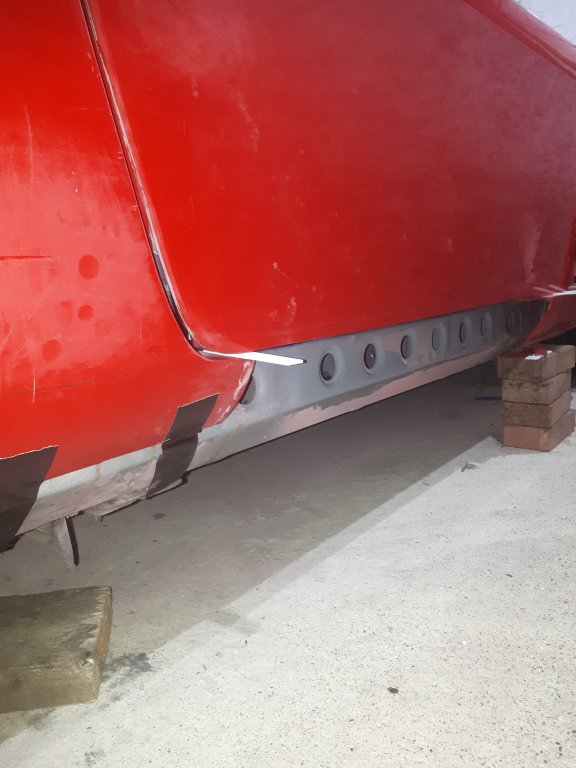

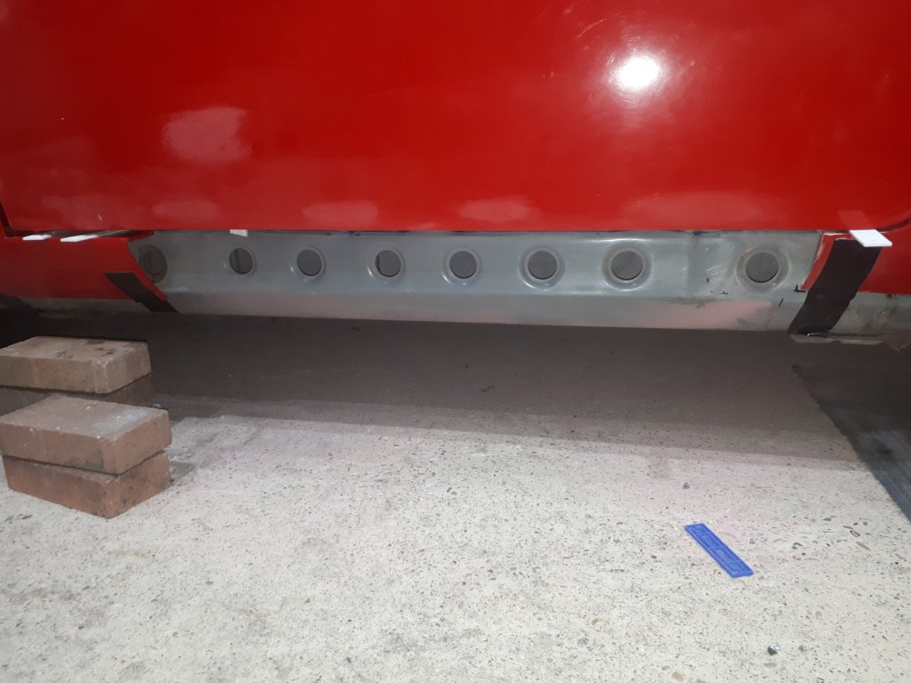

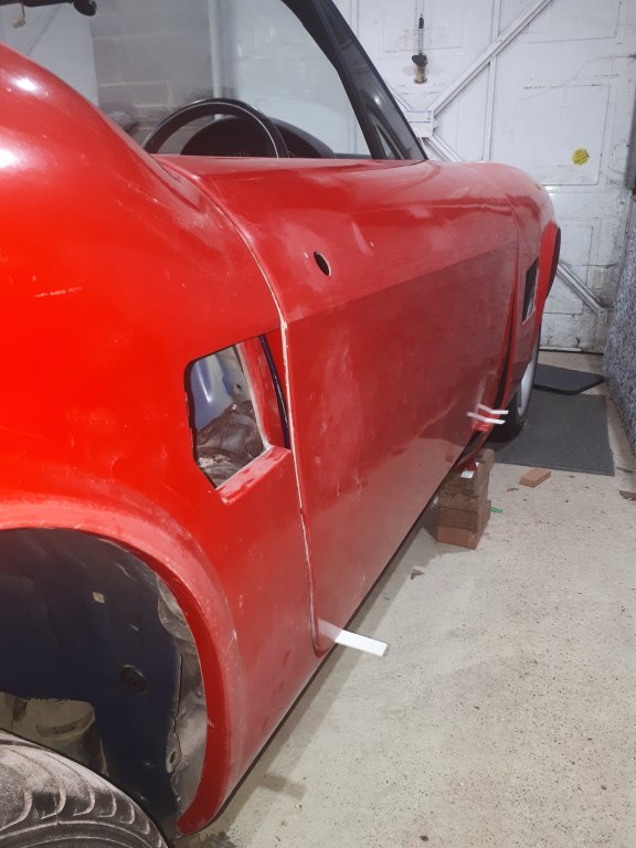

After nearly 2 weeks of trying to get the panels to fit the car, I am finally making some progress. I have had to cut off both cills, as one was so buckled there was no way it was going to fit and the other (they are different for a reason I have no idea about) is a 'stepped' one which has been moulded completely wrongly so the driver's door was never going to shut. It was moulded approx 15mm narrower than it needs to be! :mad:
Anyway, cills aside (which are a new topic on their own and will need loads of work), I have managed to get the body to sit flush and panel gaps acceptable (around an even 5mm). The swage lines will be spot on, which is good news. The bonnet is going to sit OK and the boot is looking OK aswell, although there will a 6mm panel gap all around it.

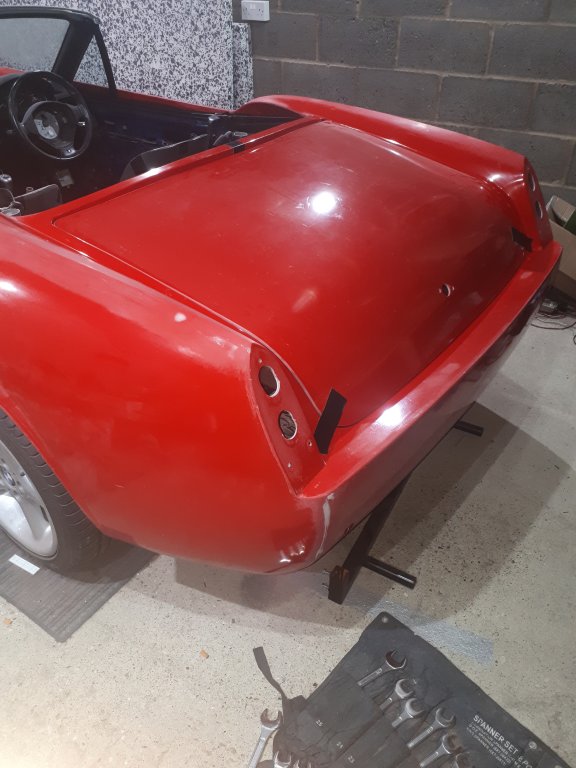

The one thing that I cannot do anything about, is the boot edge will be a LOT lower than the rear 'scuttle'. The moulding has a big 'bow' in it which I can't get rid of,, as it would push the rear wings out much too far.
I have had to pack both doors out to get the rear half to sit flush. There is still an awfully long way to go but I am now confident I make it look like an acceptable 250 Cali replica. A few pictures from today......

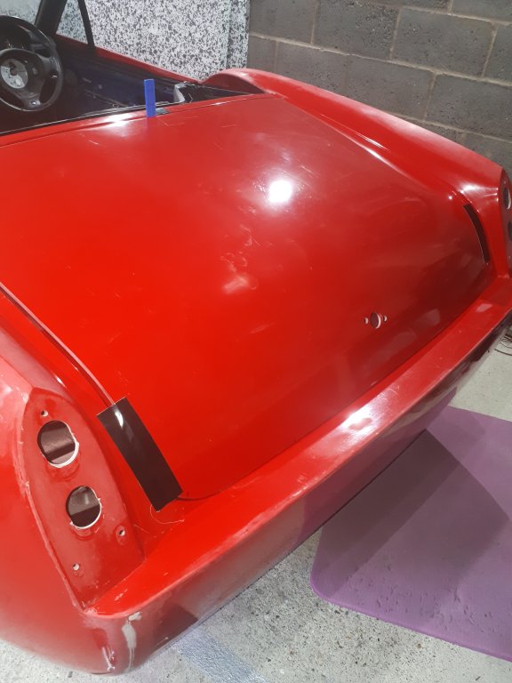

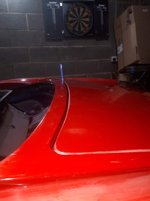

I couldn't leave the front of the bootlid sitting below the rear 'scuttle', so hooked the boot brackets on and had a play.
Now sits flush, albeit with a lump of wood holding the middle up at present. Hopefully the bootlid will 'mould' itself into the right shape. If not a permanent 'wedge' will have to remain?

Can you add a metal former to the inside of the boot lid to correct the shape? Prebent and glass fibre it in place?
I will see how well the panel bends itself into shape. As it's quite warm in the garage, it may 'form' in a short period. It may not, though! The other thing I was thinking of was somehow using a strengthened weatherseal to replace the Z3 one. Difficult to assess this, as you can't get to it with the boot shut!
I now have the 'bit between my teeth' so really want to push on. I don't want to wait for weeks (or months) for any of the panels to do their own thing. I really want to get it all bonded now! I have an industrial quantity of 'Tigerseal' waiting. Patience is not one of my strong points (nor is car building TBH)!. :D

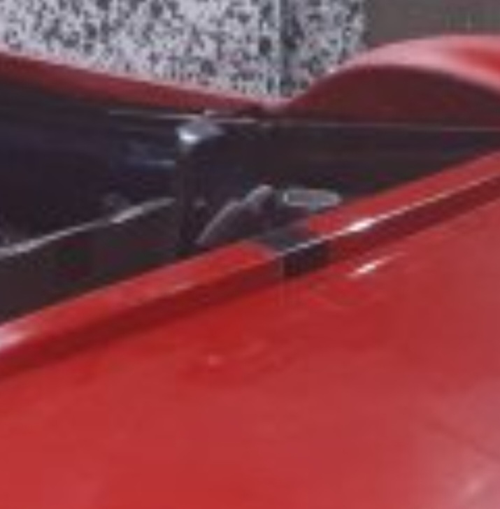

Does the rear 'scuttle' or bow as I would call it ( the narrow section across the rear of the boot lid) flex at all? Is is pressed hard down onto the BMW bodywork? I found that to align the boot lid and the bow needed a degree of manipulation of both.
I've never seen that body shell but, if it's anything like mine, that GRP section across the top of the rear tub is one of the few contact surfaces where the grp should rest flat along the metal. If there's a big gap in the middle then it needs adjusting

I agree, from the photos it looks like the boot lid is lower than the bow, so I was wondering if it wasn't touching the metal and needs clamping down during bonding.
I have cut it down the 'bow' on the GRP as much as I dare (or can). It doesn't quite 'rest' on the metal, as it has more of a bend angle. If I push it down flat, it pushes both rear wings out, which stops the doors sitting flush. I have packed the doors out as much as I am comfortable with already, so can't do any more.
Like everything on my kit, it is a consequence of not being moulded very well to the correct angles and tolerances. Although the word 'tolerance' is not one I would used for GRP moulding in general TBH!
Mine is a 'mould of a mould of a mould', so presumably every time a new mould is made from a shell, it gets further and further away from the original. I am still not convinced my body wasn't designed for a different car; maybe a Ford Cortina! :D

I now have multiple pieces of 2"x1" timber all cut to different lengths (and marked) to push many parts out, off, in, etc to get the angles and profiles to sit flush with each other. A consequence of being sat in a garden, under it's own weight for years, and the moulding not being very good in the first place. A 'perfect storm' is what I have!
I am going to have to tec screw everything to hold it in place and give references for when I bond it all.

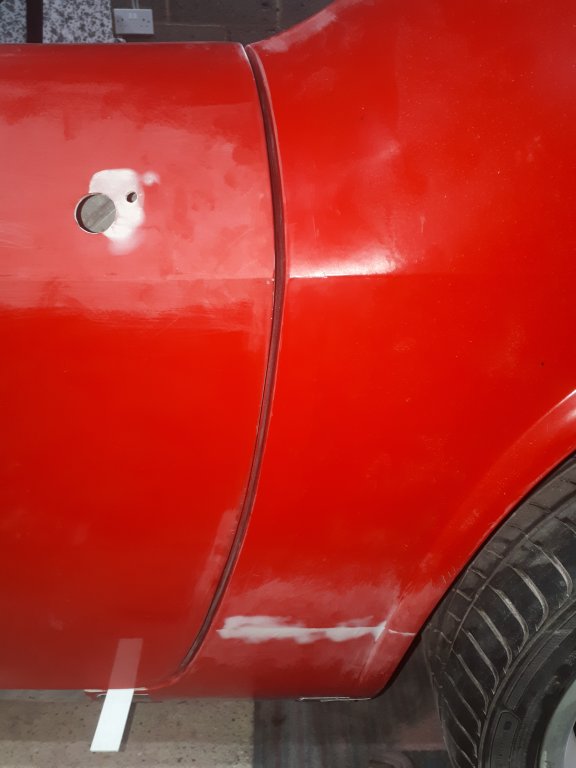

When you re-attached the Z3 rear wings (or what is left of them) did you adjust the position at all? Undoing those screws that hold it on gives adjustment in and out which might make a difference and lessen the need to pack the doors out.
Done that! They are hard up against the door shuts now!
I have had to cut the GRP door returns down, as they were just moulded too thick on the edges. These will need filling and blending later aswell.

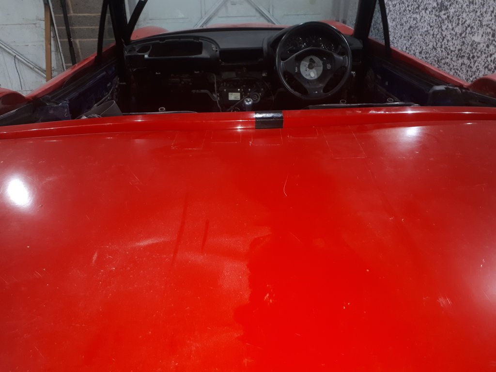

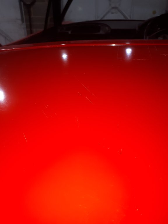

I just looked at this picture again.
Wow. That is bad. May be an optical wotsit but the boot lid looks like it's curved down in the middle. In any case it looks like the bootlid could do with a bit of a curve.
I assume it's a flat sheet of grp with a grp frame on the underside.
If it was me I would (not saying you should) cut the bootlid away from the frame and put it back on with a little extra material between the frame and the lid to raise the surface a bit at the front.
