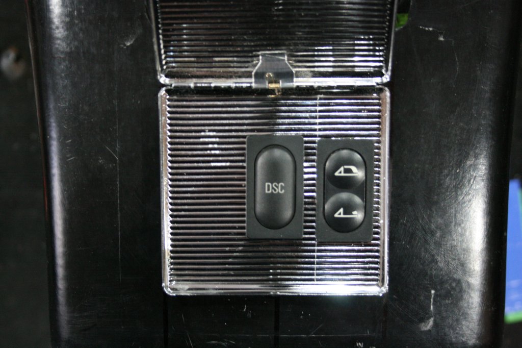

A question about the window switches, can you open both windows from drivers side switch in some way? Really like the idea
No, there is just one switch for each window. Just like in the old days! ;)

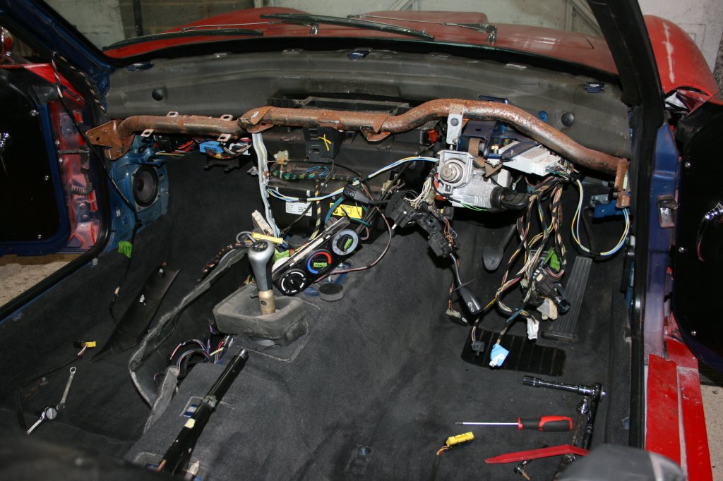

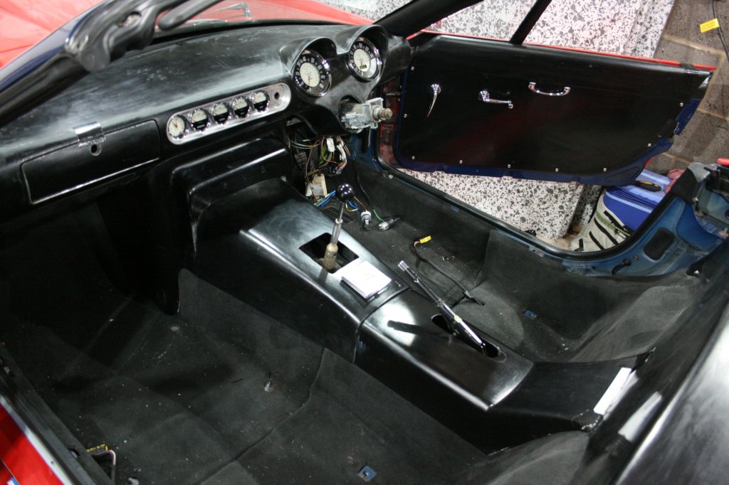

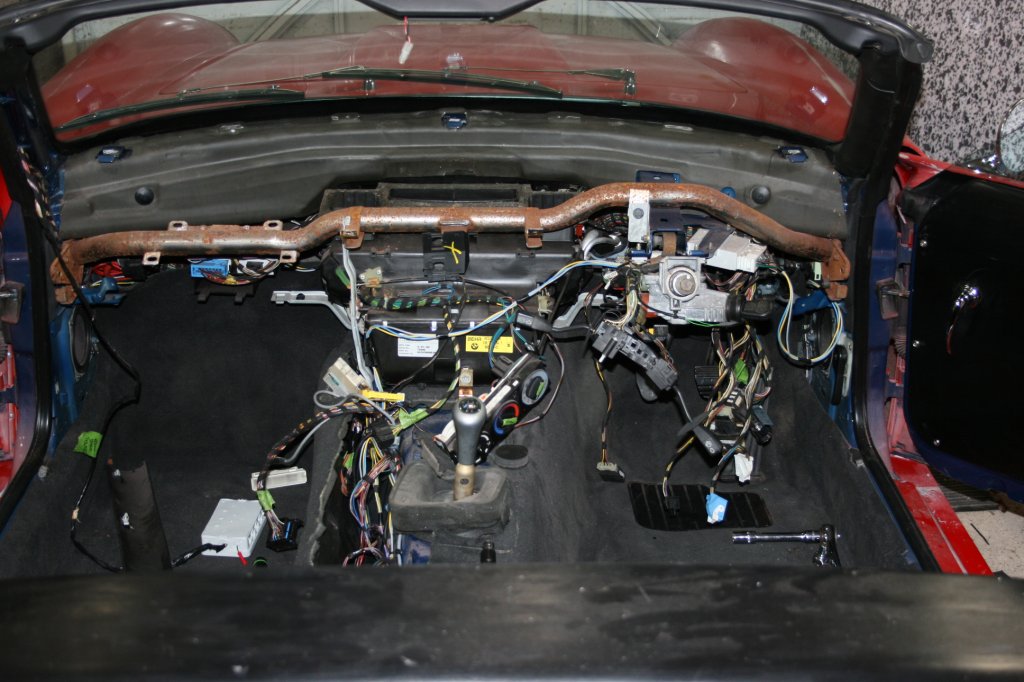

Getting on with changing the wiring and switchgear.
I have removed the ignition barrel and electrical connector. Old ignition barrel will be re-mounted in the new dash as a 'dummy'. Just for somewhere to put the key next to the immobiliser antenna. A new ignition switch is wired and tested to be fitted in the centre of the dash.
I have replaced both foglight switches with toggles (with leds in them).
I have cut down the headlight switch mounting bracket ready to be fitted in the new dash.
New 12v power socket has replaced the old fag lighter.
New fan selector switch has been wired (3 speed only as can't find an aftermarket 4 speed)!
Next job is to cut off most of the ignition switch housing/ steering lock so my new dash goes over it. I will be keeping some of the housing to re-fit the column stalk assemblies and the mounting points for the column covers.
I have replaced both stalk ends with bakelite-looking ones with chrome ends. Getting the old stalk ends off was a challenge (especially as my car had the BC stalk end with wiring in it). But they are done now!
I have also moved the central locking PCB from the rear view mirror to under the dash. The antenna has been run from here back up the A pillar to the centre of where the rear view mirror was. I am having a dash mounted rear view mirror (which has caused a lot of aggro).
No pictures of all this, as it isn't very attractive yet!
I am going to replace all heater flap controls with new cables and pull-push knobs, as the whole heater panel needs binning (it won't fit in the new dash).
I would like to keep my A/C but can't find anywhere to hide the switch (as it's big and I don't want the aggro of changing it and the recirc switch). So I am going to ditch the A/C but leave everything in place in case I change my mind in future. My A/C works but needs a top-up of refrigerant (which I could do myself ironically).

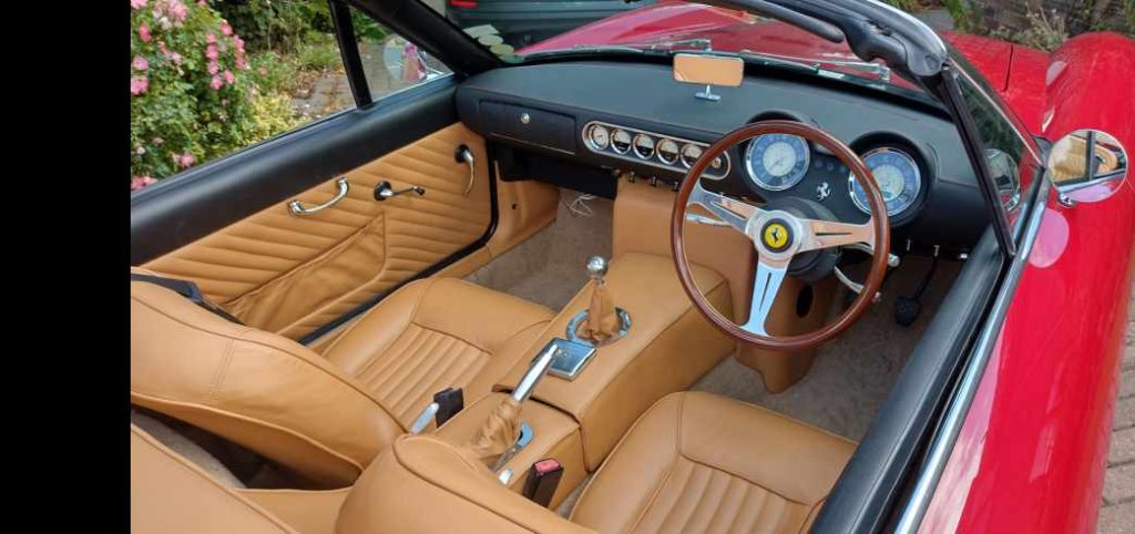

It's worth the effort though. Won't be long before it looks like this!View attachment 329023
I'll believe it when I see it! I haven't even thought about the instrument wiring and additional sensors yet.
Yours looks lovely Jez.
The wife says she is not keen on the biscuit/sand colour interior :rolleyes:, so I am going to look at a darker 'tan' colour.

More like this?
