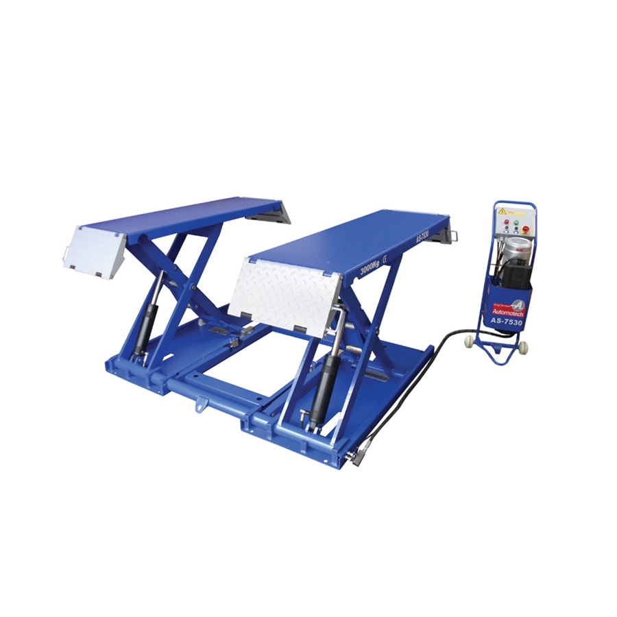

Only problem with this type is it severely limits the access under the centre of the car, that's why I changed mine to this.
That type has limited lift of only 1m max. by what I read Niall. The one I’m looking at (haven’t decided yet, so all info happily received) only has the cross piece at the centre unlike many that have 3 cross pieces. I don’t think I will be doing any gearbox drops at my age. Did you have the same one I’m looking at please by the way?

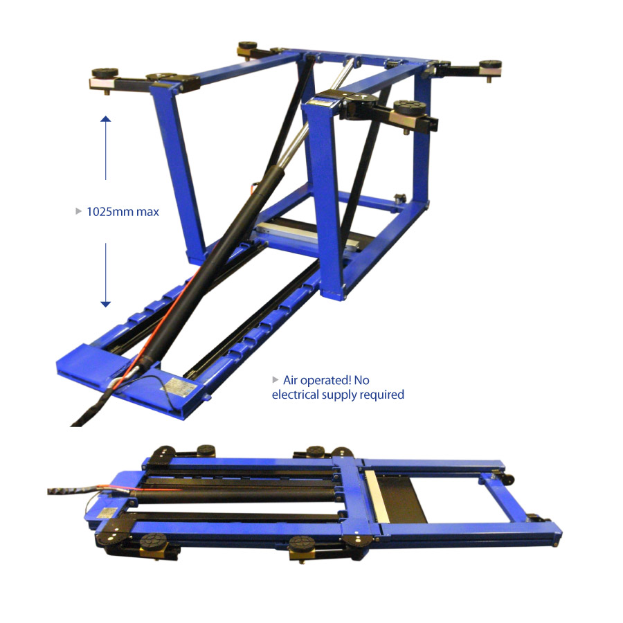

How high do you want to go? It puts the centre of the wheel at chest height for me.. No my previous one was this, similar issue with central rams, but worse than the one you are looking at.
The one I'm looking at raises to 50” which is why I went to the extremes of raising the garage door lifting mechanism. Also using it outside the higher lift height will be useful.

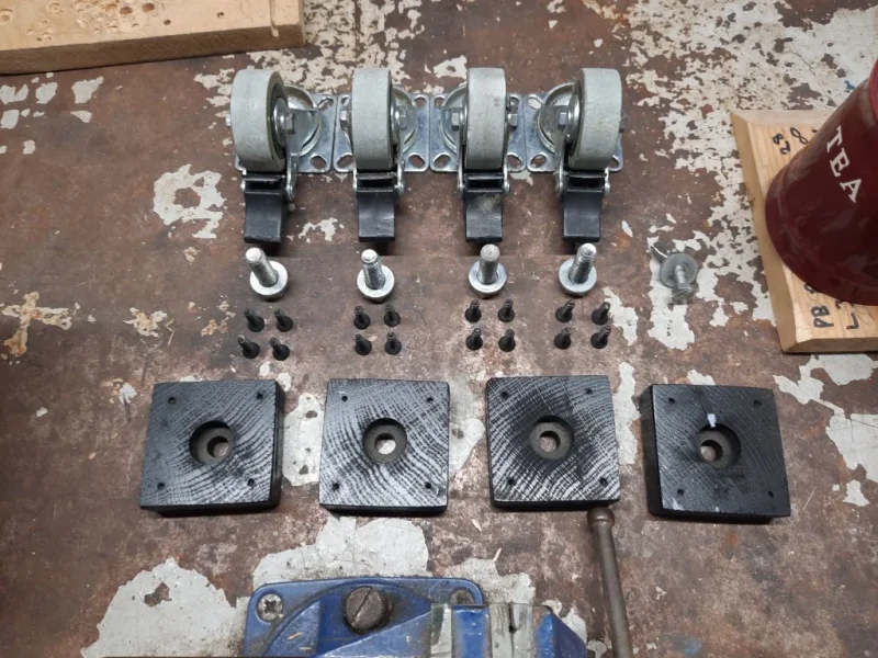

The Eagle eyed amongst you may have noticed the casualty laying on top of the table saw. I made some 2" square block from reasonable quality plywood to attach castors to the legs of my old engine trolley. This afternoon when I moved it it hit an edge of one of the pit boards and the ply split on 2 of them and the castors fell off. One top of the upturned blue mop bucker are a set of new ones made out of a piece of Oak that Gary gave me. I painted them last thing so should be ready to put back together in the morning.
Trolley repaired this morning.
New blocks fitted and castors refitted.
This is what had happened with the plywood blocks.
And its back in action.
