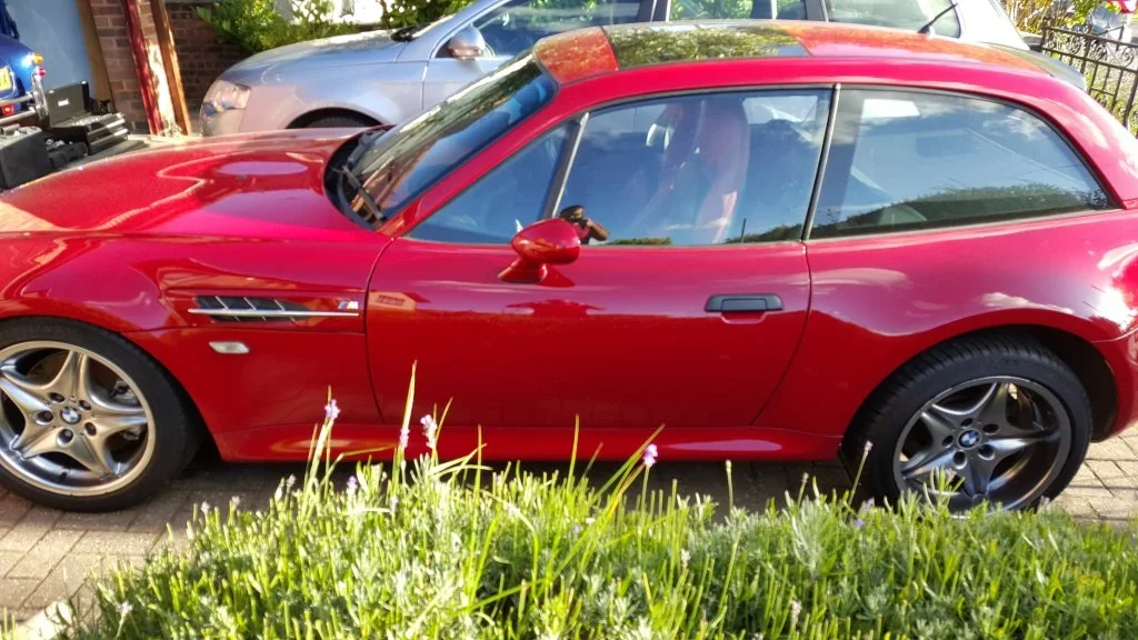

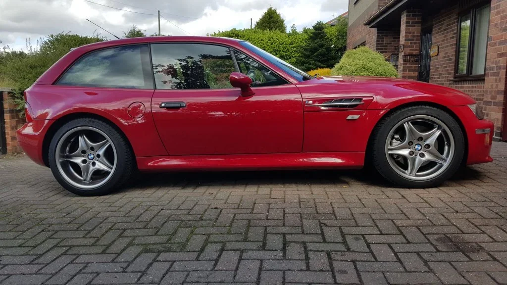

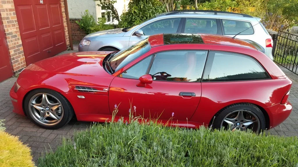

Finally (almost) finished. Everything went back together easily enough, although the front was too low and the back too high
Adjusted one front side to level it with the other and dropped the back as far as possible. The back sits OK now the front still needs raising.
I went out for a test drive and my good lord what a difference. The car feels planted, rides bumps so much better and all of those creaks and rattles I had? Gone!!
All I need to do now is raise the front 5-10mm and add some small spacers to the front as I have a little rubbing
:racecar::highfive:
