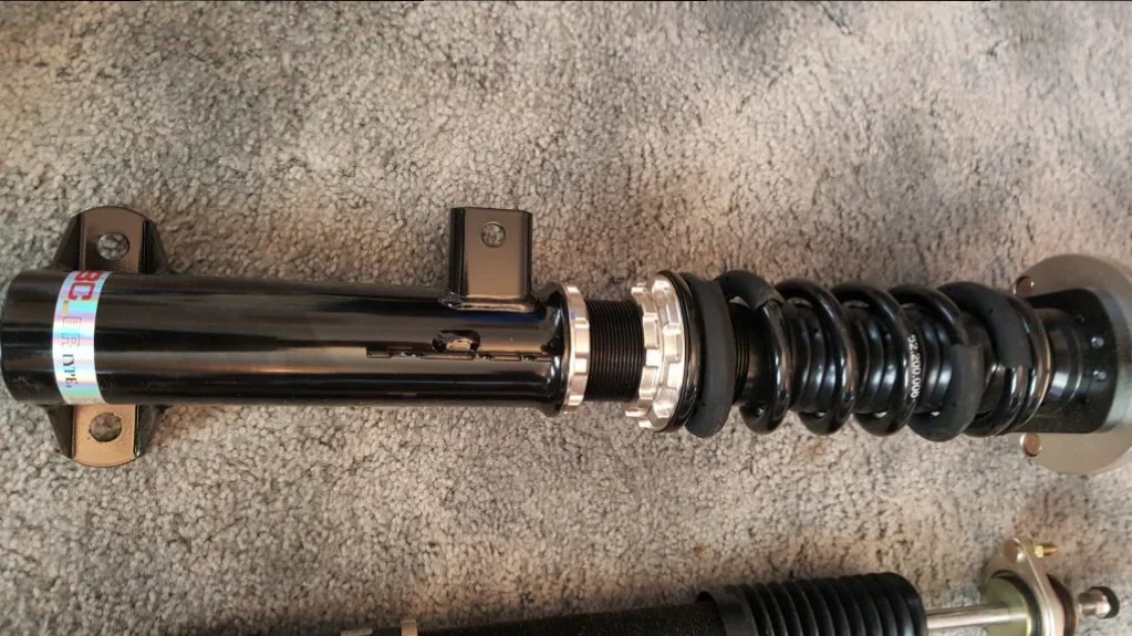

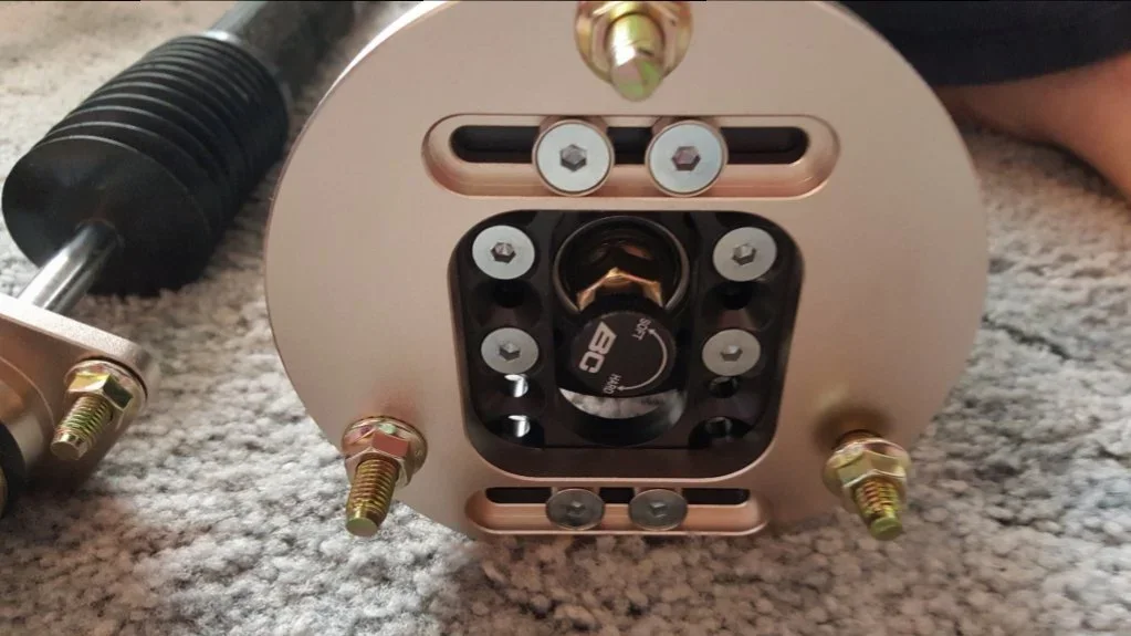

Got started on these yesterday. Front left came off and attached OK. It immediately sits lower (didn't get pictures of the coilover fitted).

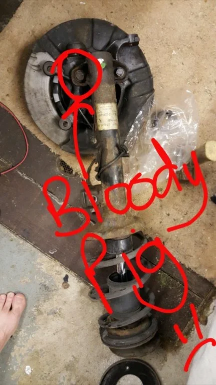

The front right was (and is) a pig. Stuck nut so had to take the hub and disc off to get better access. Still stuck now but have an 18mm impact socket on the way tomorrow

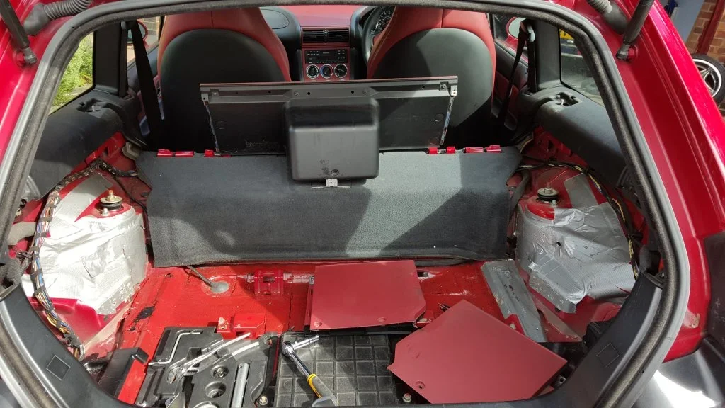

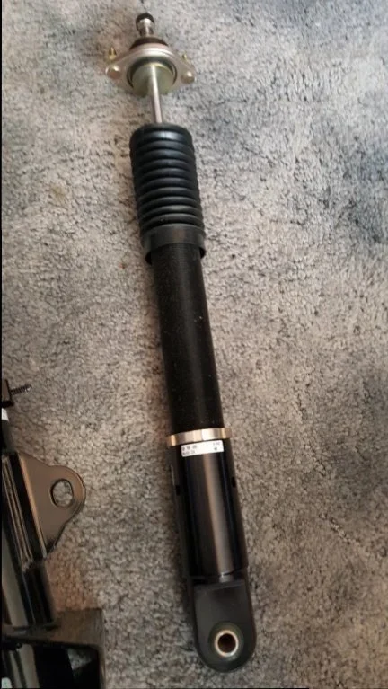

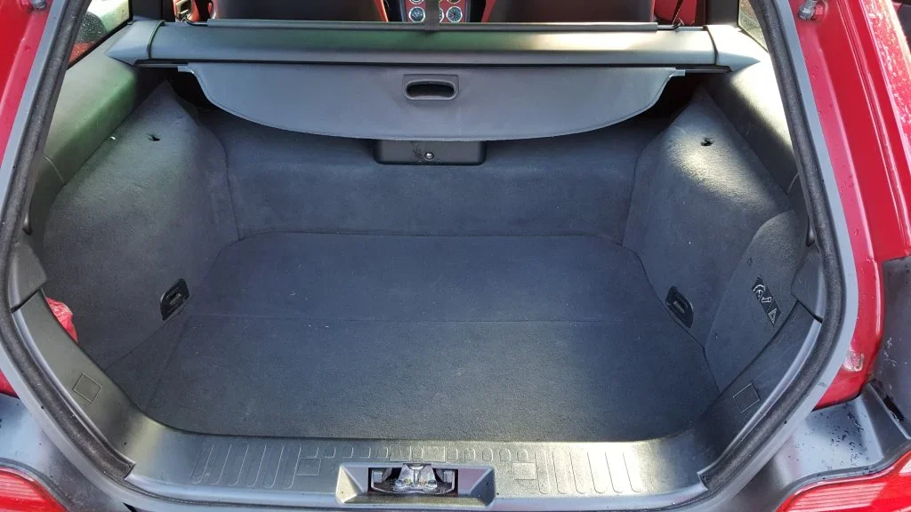

The rears went on simply enough however that did involve stripping the boot to get to the rear top mounts. What have I done???

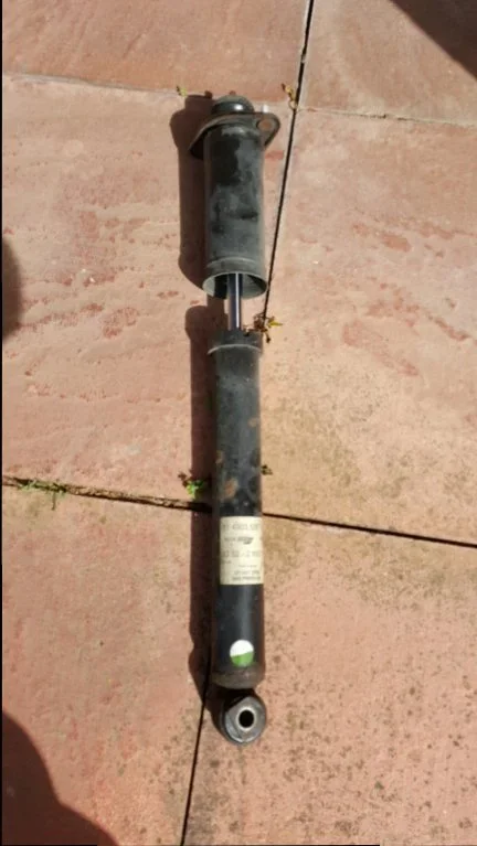

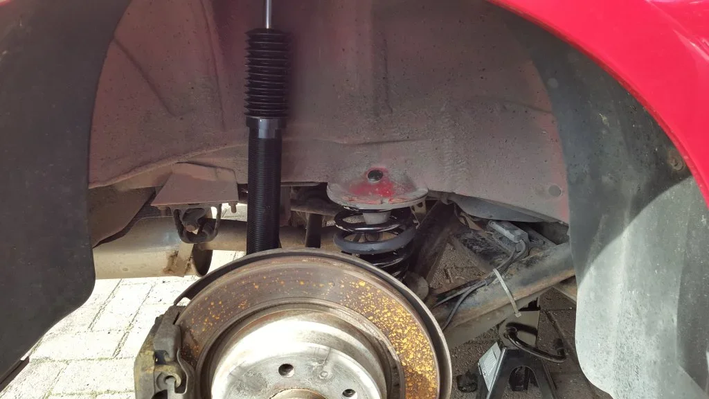

The rear damper were absolutely shot, hardly any resistance in them and squeaked. I guess that's the reason for poor handling and squeaks!
New damper and spring in place

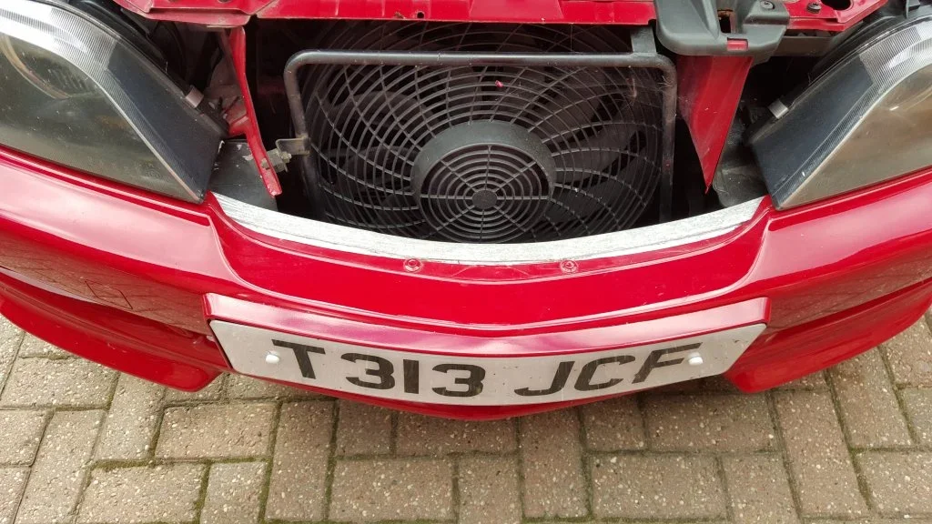

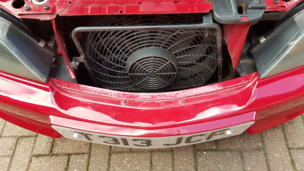

Some of the day was left so stripped some of where the front strip had been painted and shouldn't have been :pompus:
How it shouldn't be:
How it should be :thumbsup:
Tomorrow I need to get the pig nut off, refit the front, put the interior back together ( the right way this time, previous owner just shoved it in) and set the ride height properly. Happy days!!!

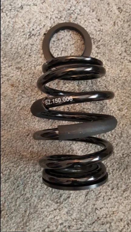

Great work, Not sure if you have a solution or not but you may wish to give some thought regarding the rear shock adjusters before you piece everything back together, you can buy extension pieces that attach to the top of the shocks so you can remotely change the shock settings. I see you have the 6kg springs in the rear, be interested to hear how you get on with these.
Mnbrennan
Jul 25, 2015
153
Aylesbury
BMW M Coupe / 2.8 roadster
Yeah I know about the adjustment. The rear is sitting slightly too high so will need to readjust.
I was surprised at how stiff the chassis is. If you jack up one corner I end up with three wheels of the ground!
The 6kg springs... I imagine I'll upgrade to 8kg.soon but will try things out soon
