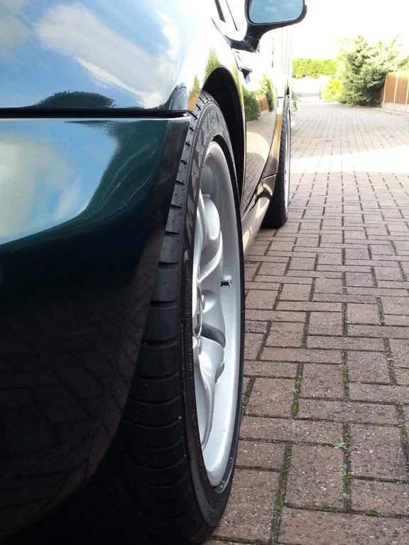

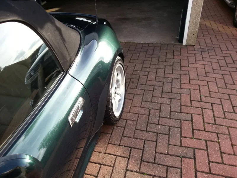

Hi Koen, no the rears are simply shocks and lower springs. I only fitted the spacers to push the wheels out to edge of the arches. Had the same wheels before that. Fronts are adjustable.Hi Tony,
Did you need to have the spacers because of the coilovers? Or could you have coilovers without spacers (and have the extra space for "more tyre/rim")?
I was under the impression that because of the E30-suspension at the back, the Z3 wasn't able to have real coilovers at the back.
Just a lowering spring and separate damper (possibly a damper with adjustable hardness).
