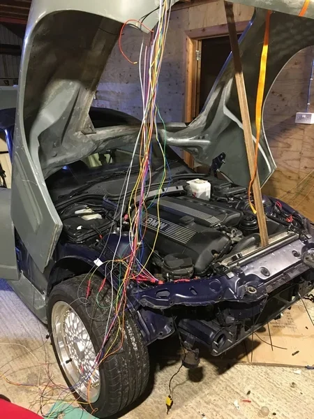

Now to the stripper pics.
It should take less than a day to strip it all down. Took me longer (nearly two days) due to
Lack of knowledge
Constant need to help someone with other stuff
Attending conference calls with the US (work getting in the way of play)
Lack of skill.
It’s all off bar the outer cills (I bl00dy forgot to get them off before the pics taken).
I’m now at the stage where I begin preparing the body to fit (needs a bit of offering up and fettling as I go). Next week I hope to have rear clam-shell and boot fitted. Perhaps bonnet if all goes to plan.View attachment 76246 View attachment 76247 View attachment 76248 View attachment 76249 View attachment 76250 View attachment 76251
The mad-max look, I quite liked mine like that, shame it is not road legal!
I spent a good deal of time laying on cold damp gravel including lifting the Zed up on the coil-overs. They might come back down though.
I cut and drilled holes for the front headlamps and indicators in the bonnet. Replaced the bonnet gas struts with some a bit more oooomphie and re-fitted the side wings. Now these fit on all the exiting bolt holes for the OEM sills AND winglets so are a pig to get right. I have lots of gapping to do around the Zed doors.
By the end of maundy thursday I was a bit down-cast as not made as much progress as I hoped. So my mate (who's place is where I am building the kit) saw my mood and suggested a trial fit of the bonnet. We then put on the rear clam (using a few bolts to hold in place only) and then I placed the boot in position. It cheered me up and I have a day next week to get the rear clam offered up properly as well as an inner boot piece. The Kobra boot is longer than the original so needs extra grp panel fitted.
Anyway here is the artist's representation of what it could look like one day..... More to come soon.

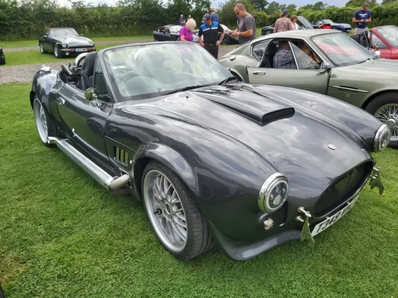

So I put the Kobra away before going on holiday first week of July. Then when I got back the project I was being paid for went ballistic and I didn’t get a chance to drive the grubby car until last week again.
I’ve tidied up some of the body work in readiness for some quotes to paint it, colour still to be agreed. Dammit ...
Also fitted a black mesh grill and moved the plates down.
Also during this period I sent off the necessary paperwork to re-register the car. Bought some shorter plates to go with the new reg and been driving it. The summer isn’t done yet !
Here are some pics from today’s ride out to an arboretum in Oxfordshire (cool place).
Dave
I like it in the "Gangsta-Matt" finish!
Cheers Sean. I'm now nervous about driving the damn thing. When it was dirty black i was less concerned.
More pics to follow once i get rest of lights and fittings on.
You soon stop being "prissy" about the new paint, with UK roads and winter crap it will look like the "Gangsta-black" again in no time! Says me - who cleans his car at least twice a week!!!

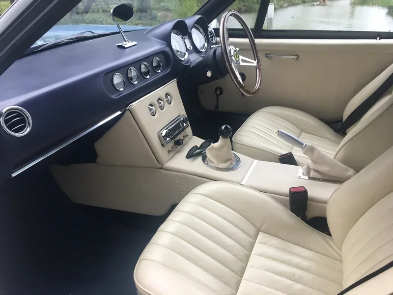

Interior shot today. Have kept it very easy by staying pretty stock.
Just a Momo steering wheel and gear knob (in red of course) to break up the interior. I removed the factory roll hoops as they don’t suit the car in my view. Having a wind deflector is a must on the fast roads though.
Next job is to put in better rear speakers (vibe slicks as Sean has) and following that replacing the Z3 seats with..... ......
MGTF seats.

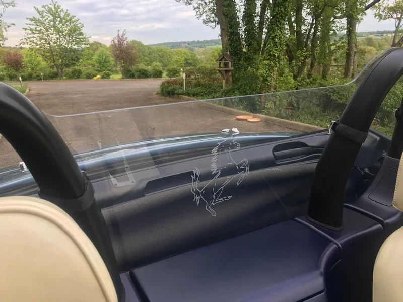

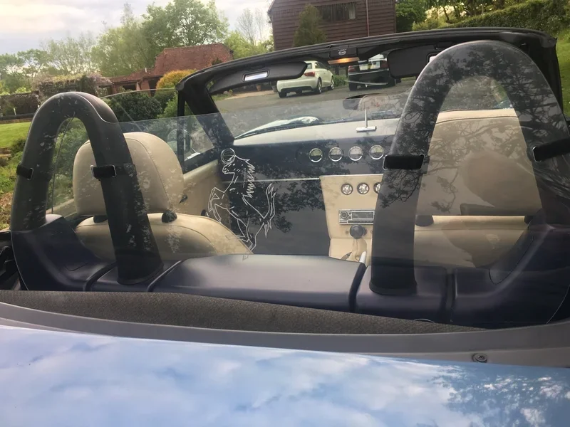

Some last minute details:
Wind Break - looked on evilBay for the mesh ones and nearly fainted with shock at the price.... rummaged in the barn and found an old sheet of Lexan (offcut from a shed window), made a card template including cutouts for velcro fastening, made sure the top of the storage bin would still open and cut some perspex.
After a bit of polishing out of scratches (Brasso does this brilliantly) I thought hmmm.... this is not blingy enough. Enter a printout of a Prancing Horse and the dremel et voila... Bling.
Add some long velcro straps and there it is. It even works, which is a bonus.
There are a few more pics of little details which I hope are self-explanatory!
Enjoy.

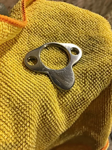

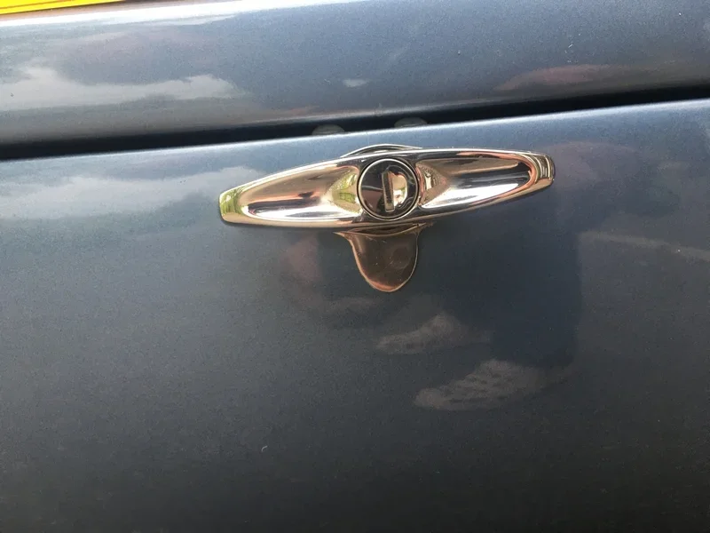

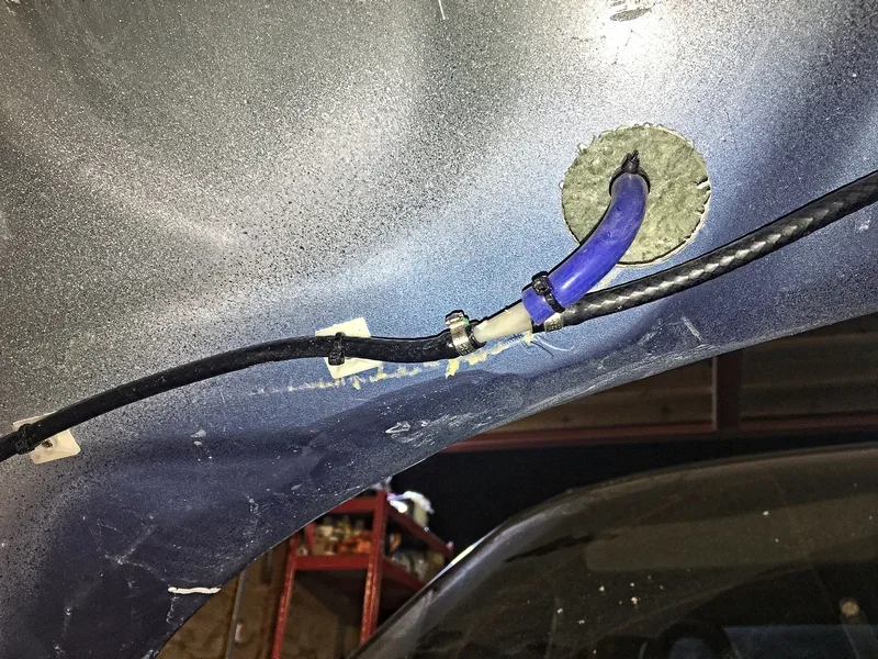

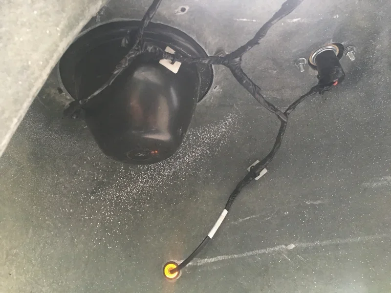

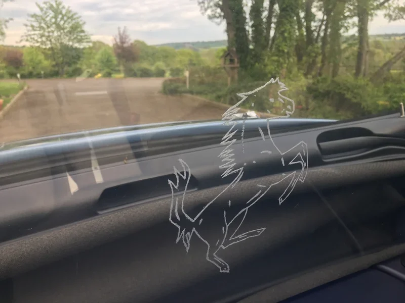

Dremel, tape, a paper printout of the Horse vector, a steady (ish) hand, 10 minutes and Bob's your uncle.
The logo sits dead centre of rearview mirror field of view, which is nice/annoying depending on the weather!
