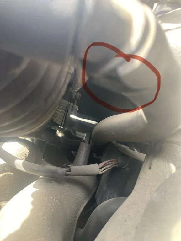

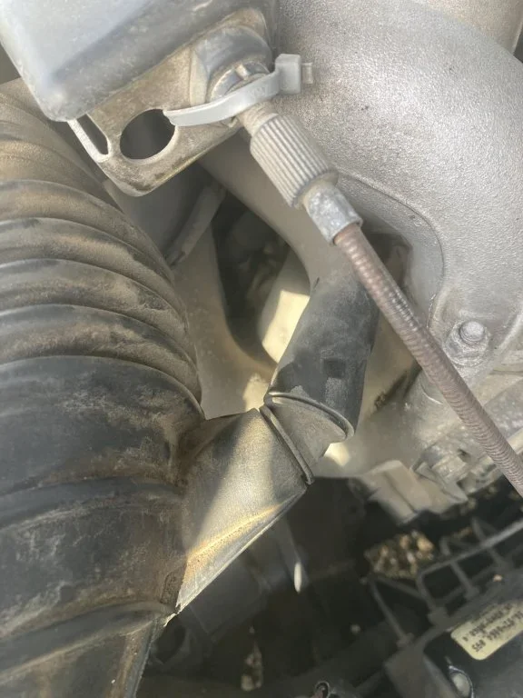

Ok - this is embarrassing so please 🙏 nobody take the P.
I did a bit more research (which I seemed to have missed in my search 9+ months ago) and found that vac leaks can cause cold start problems.
Had a closer look at my M44 inlet piping and found a cut on the underside of the smaller pipe that exits the MAF boot. Pics attached.
I’ll know next cold start as I’ll tape it up until I get a replacement pipe. It’s driving me crazy.🤪

The fat lady sang. All sorted. It was the non visible tear in the pipe. ( pic above).
End of a 10 month saga 🥴
To be fair - I also removed and cleaned the idle control valve to feel useful. Not sure if or how much it contributed.
