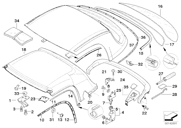

Mike,
Half-moon shaped tool for adjusting hardtop - item 28 in the parts diagram attached. I've got the hex key.
David.

Its the hook thingy to adjust the spike thingy that goes into the hole in the fixing kit on the car
that was a very technical explanation :)

OK, now I get it, never had to udjust mine as it was on when I bought the car.
