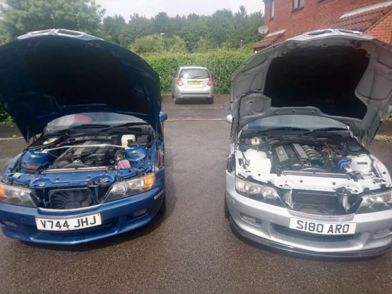

Had a visitor on Saturday to see if we can get one of the kits to fit the M52TU
@Disca came over and we fitted one of my kits to his car
it needed a bit of fettling to fit as there are a few changes to the M52TU engine bay
  • Carbon canister moved
  • radiator expansion pipe in the way (looks like z3M one will solve this)
  • built in airduct behind the headlight reduces available space
so a quick trim of the pipe and a new style of bracket and its all done!

Yup we officially have an M52TU kit now and I am very much enjoying it!
Very subtle during everyday driving with a hint of rushing air whistle when you gently accelerate at low speeds, reminding you it is there.
Full bore at 4k+ with the roof down there is a very notable roar!
