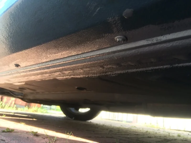

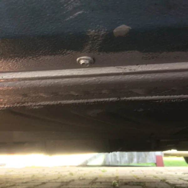

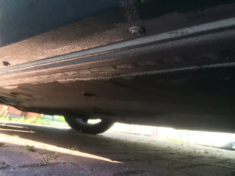

After spending two days removing the old undercoat and all the rust this is the result:
First treatment of rust bullet on front arch:
Rear wheel arch rubbed down waiting for second coat of Rust Bullet:
After nearly writing the car off due to what I thought was excessive corrosion, and spending hours removing any corrosion and loose underseal and then coating with rust bullet:
Will leave the Rust Bullet on for a week to cure properly, have ordered some Aerosol paintable undercoat to do the underside of the sills and will then use loads of filler undercoat to get rid of all imperfections around the wheel arches, it should be ready for the top coat in a few weeks, not sure how good a match this will be until it goes on, but fully prepared if necessary to hand it over to the professionals if needed.
Soon looks much better Jim and then the doubts change to satisfaction.:) Even if you do have to get the top coat done by a pro you've done nearly all the prep.

Looks better already Jim, great photos. :)
