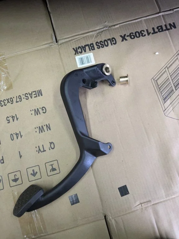

After years of running a heavy clutch the pedal was feeling a little vague. Worn plastic bushes out and new brass ones fitted. Feels much better now and no more squeak.

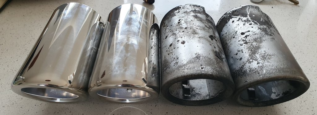

New exhaust tips for the E89
Old ones had seen better days so I tried to polish them but they too far gone. Bought a cheap pair from Ebay. Offered the guy a low price and it was accepted so £15 later they arrived. Was actually surprised as looked and felt decent to be fair.
Getting the old ones off was more difficult than I anticipated and had to use a bit more force on the left one with a chisel (carefully). When it came off the amount of stuff that was sandwiched between the fixed pipe and old cover was amazing. Looked like tarmac.
Whilst doing removing I also noticed a loose earth strap that had lost its nut so was a good job that I checked around.
New pipes fitted fine, had to use a rubber mallet and foam to protect them to secure them on.
Pleased with the result, not sure how long they will last but as they were cheap its worth a shot.
Debris that was sandwiched between the pipe and cover.
Earth strap missing a nut
New and old
All done
