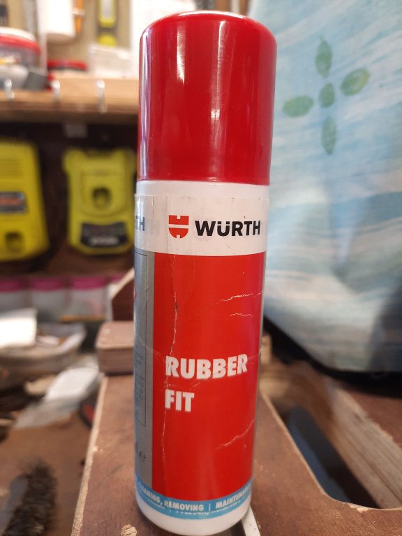

OR, you could ask for this. Simpler, safer and slightly cheaper.
