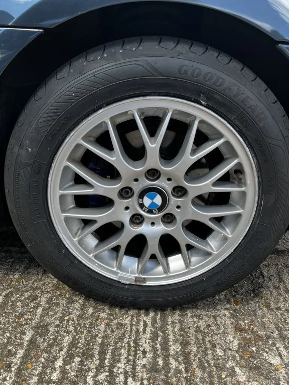

Hi @Tony Francis ,
I did 300 mile round trip the day I got them and yeah very happy with them, with excellent grip and drives like on rails. Huge transformation from my previous mix of budget tyres ( Sailun and Trezanno) which were on the car when I bought them. Huge difference in handling . Comfy ride too. They have excellent wet grip also (from my research on them) Highly recommend.

Hi @Tony Francis ,
Thanks, sounds very positive. I had a set on an MX5 some years ago and liked them, going to be on my shortlist (I have exactly the same wheels as you which is why your picture caught my eye 😁).

Z3 1.9 Orinoco
you’re welcome. Some on here swear by Michelin Pilot Sport s. That’s another option for you. Avons are great tyres too. I’ve heard good things on Uniroyal Rainsports as well. So you have plenty to choose from. 😊

I see you have gone for Goodyear, how are you finding them? My Avons are starting to crack between the treads so new tyres will be needed soon 🙁
