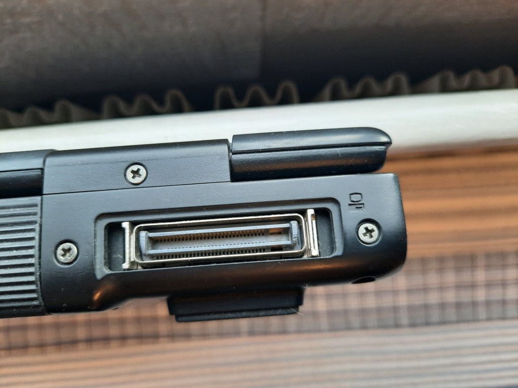

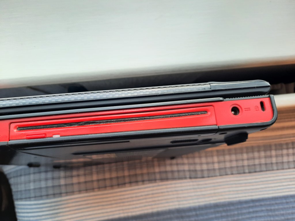

A picture of all the ports would clear up any doubt?
That laptop you posted the link for will probably only have usb ports think you need one with old style serial port due to age of your car to connect and run software
I’ve asked for photographs of the ports and will continue to look this evening. Thanks for highlighting this Tony. Much appreciated.
