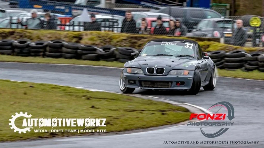

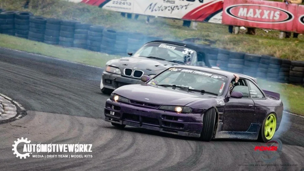

Got the car all finished last night and took it to be dynod today ,
We started at 280 hp and got to 340hp before the wastgate seized open so we had to end the session their , I'm rather happy with it though here's some pics I will upload the videos on wifi later

Wow that looked very dramatic Tommy, looks like the extra power will come in handy. Donuts will be no problem at all. The car will spit out ///Ms very easily. LOL
