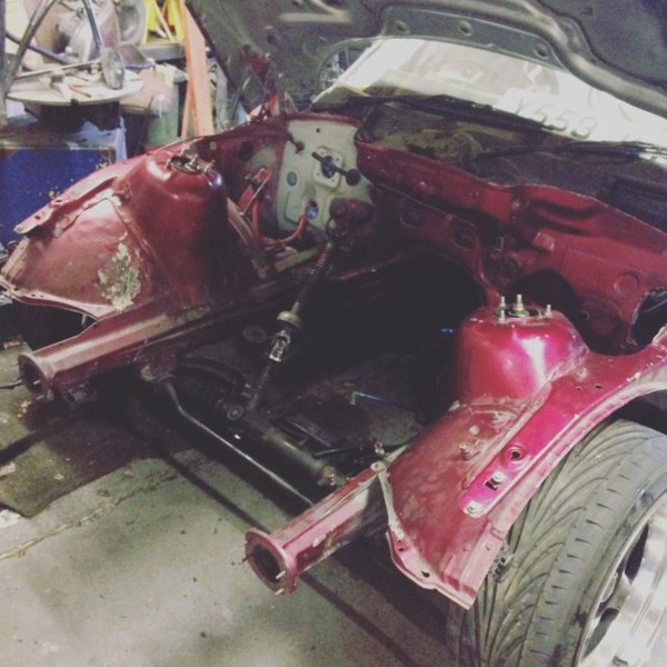

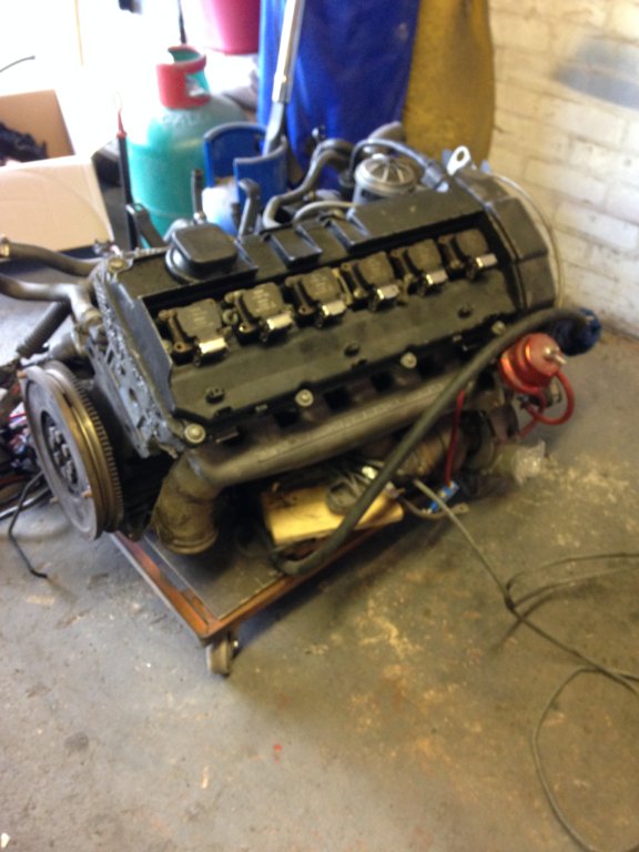

Next we started stripping the front ready to get the m50 out
I did a little time lapse video of me stripping the engine out
View: https://youtu.be/24G3rriYI4o

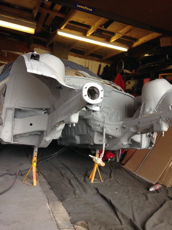

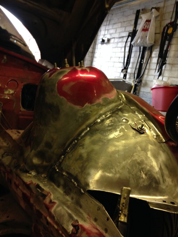

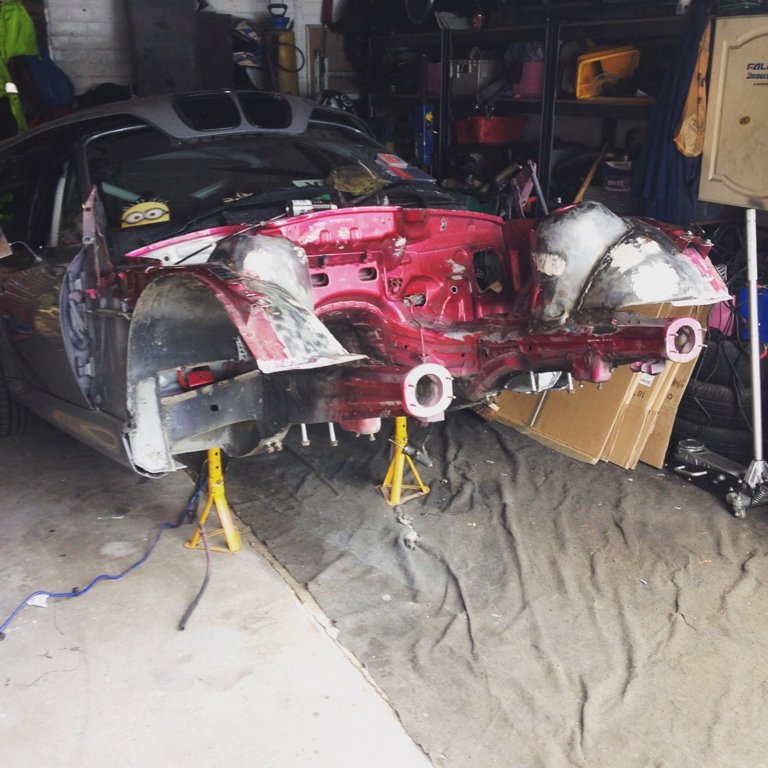

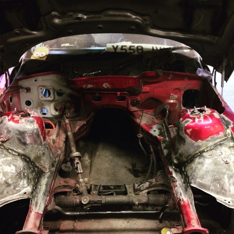

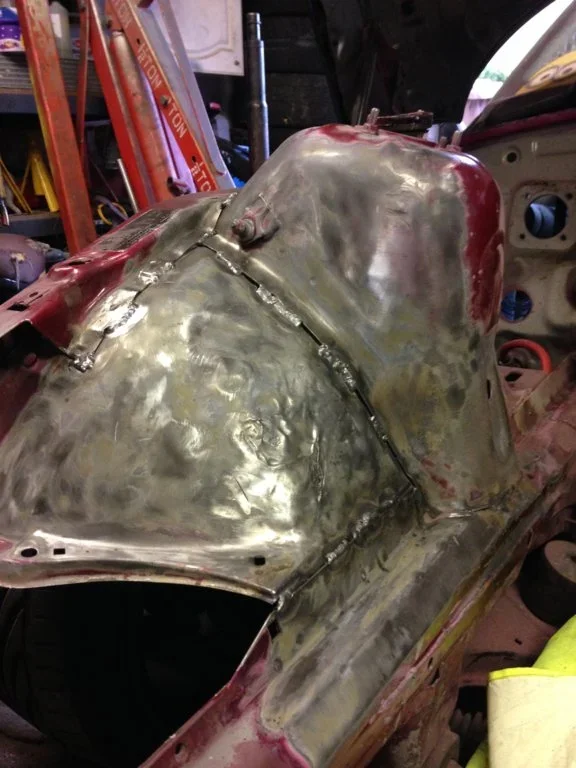

Stitch welded around the shock turrets for extra stiffness

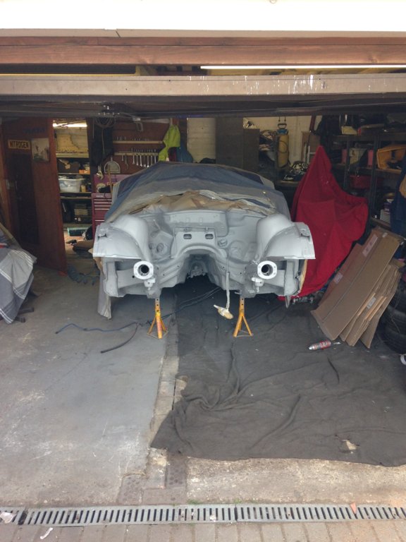

Primer time

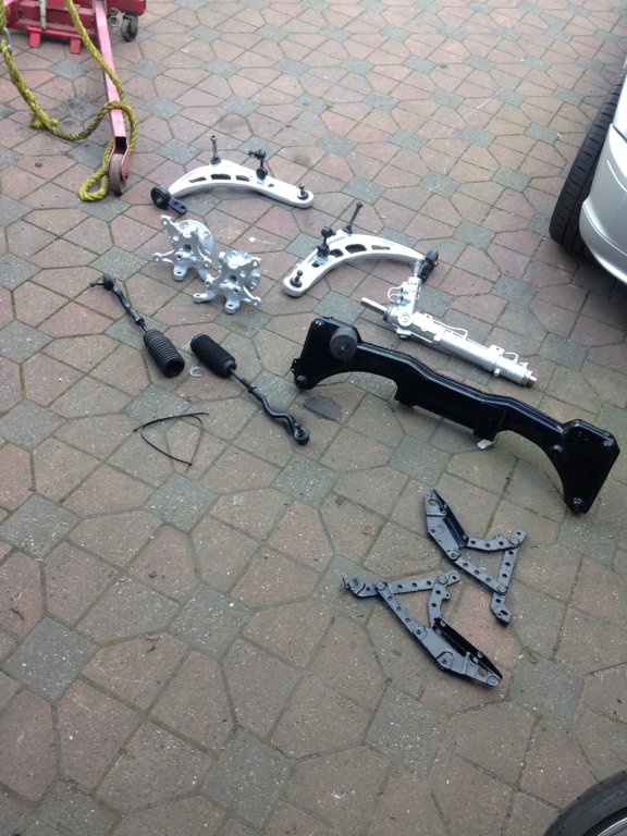

Decided to do all underneath aswell

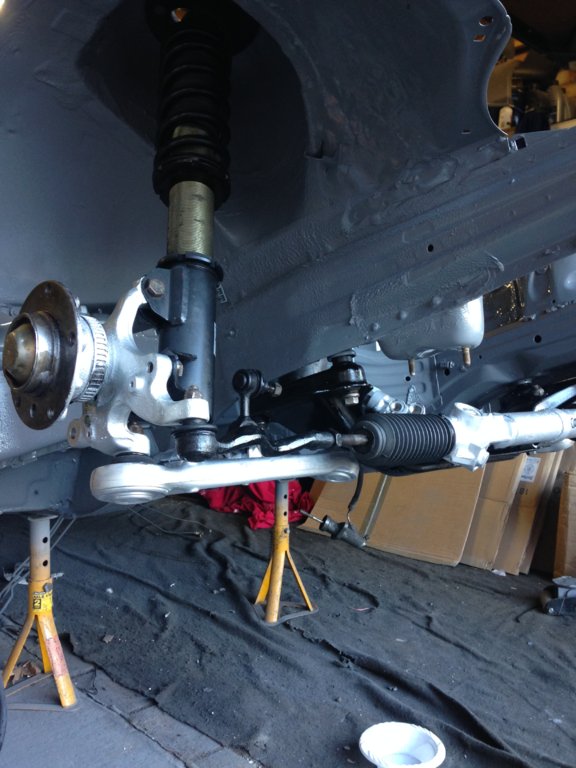

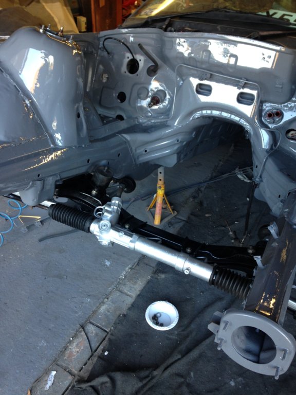

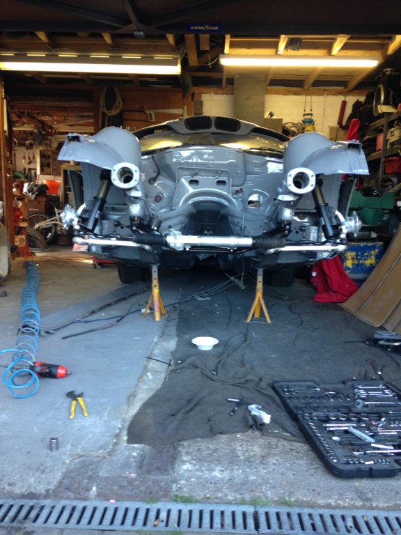

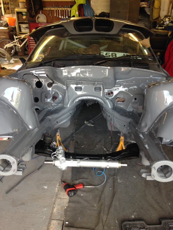

Didn't think to take a pic before I started building it up , as you can see I freshend up the subframe and rack aswell
And that's where we at so far

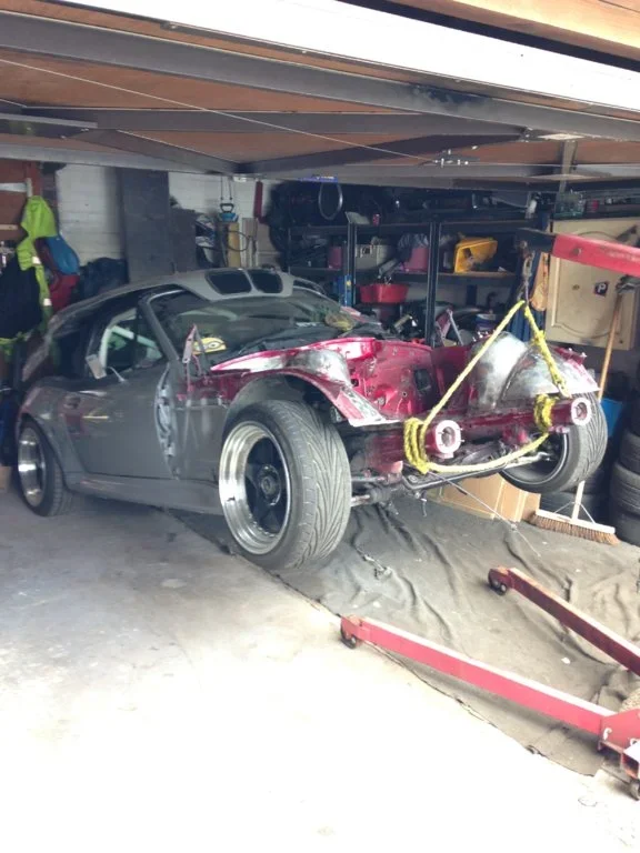

Once the fronts all done il do the same on the rear as that's needed some attention for a long time
And then il work more on my custom body kit (yes I sed it , some of you may not like this part lol)

Some of you may not like where I'm going with this
Theirs afew ideas if the style I'm going for
Here's where I'm at so far, personally I've never liked the standard skirts on z3s and the aero skirts are like rocking horse poo so I thought I'd steal some off a 200sx , These are dmax skirts and I'm going to modify the bumper to match

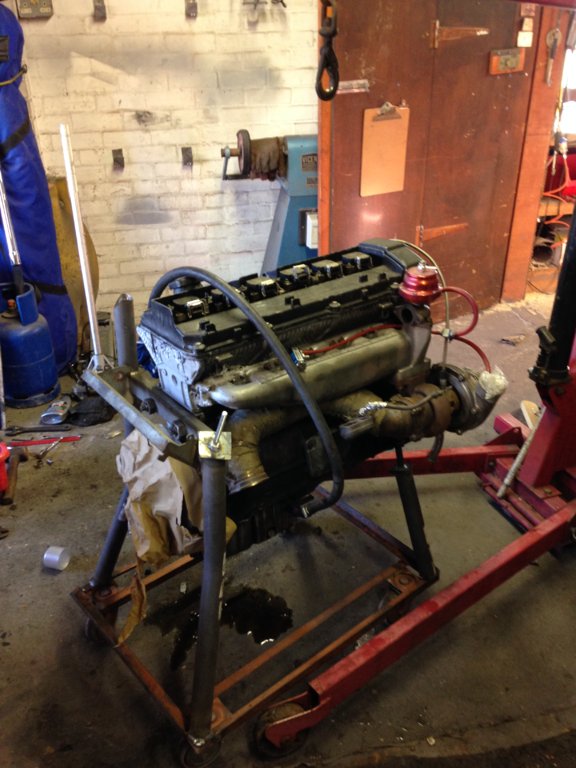

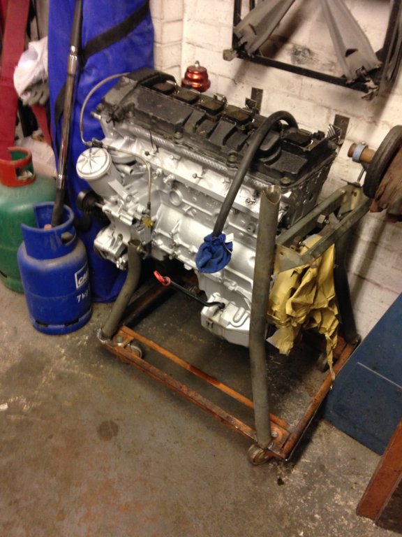

Made a little progress today , striped cleaned and painted the inlet side of the engine and also made a little engine stand because it's such a pain working on a slanted engine on the ground it just wants to fall over

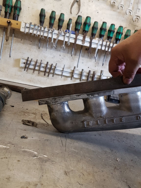

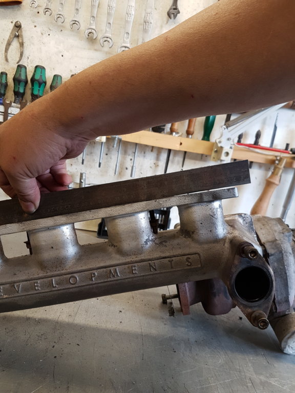

Seem to have a habit of warping manifolds , anyone have any idea what caused this to happen ??? I'm no expert when it comes to metal properties
This was blowing before I removed the engine and it's easy to see why now
5harp3y
Jul 10, 2015
168
Basingstoke
2.8
Two main things can cause / exasperate warped flanges
  • no relief cuts on cast flange
  • flange not thick enough so cant take the heat (that doesn't look very thick)
My best guess would be it could be down to how you tighten the fixings Tommy.i would start at the centre and work outwards. Do you torque these or do it from experience mate?

Got it back from skimming
The guy who did it found a heat patch where the downpipe has been heating it up , and it's twisted from that patch so I need to remake the downpipe and engine mount so I can go under it
I did torque them mate but it warped so bad it has pulled out the threads on the front of the head for the manifold so il have to Helicoil them
Can't moan to much though it was kind of a untested setup and this is the only issue I've had and it not going to be to hard to sort
