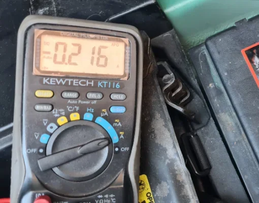

Afternoon all ... well.... I think I've found it.... but no spoilers......
Today I dug out my Kewtech meter that can go up to 10A.... hooked it up in series with the Battery negative lead. Set to 10A.. and rested it on the rear quarter so I could see from the engine bay.
As you can see.... current draw was 3A !!!... with nothing on and no key in the ignition...
What the hell !!!???... that's something biiiiiig !

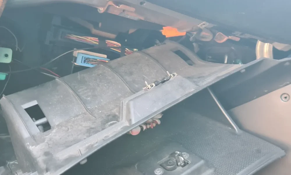

Anyway I pulled every fuse and relay individually, including the 40A one behind the glove box....
and my readings were between 2.78A and 2.9A.. so nothing of any real significance. so it's got to be big, right ?
Tested the resistance of the earth strap and I got between 0 Ohms and 0.1 Ohms, so it's not that.
Let's try the alternator yes ?... connections on the back are easy to get to .... Positive is 13mm and negative is 10mm
and would you Adam and Eve it !!..... 216 mA !!!
still didn't want to fire, I put it in limp mode (by disconnecting the ICV and TPS) and it fired up for about 3 seconds.
So what's next is to fully charge my brand new battery which is a 640 Cold Crank Amp battery and see where we go from there.
