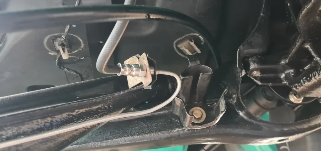

it was time to button up the brakes at last.... put on the last spring clip for the rear trailing arm brake hose..

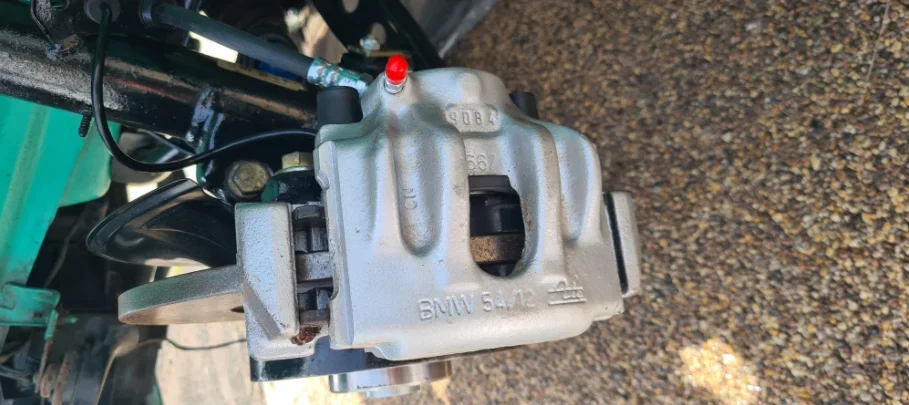

Then onto the front calipers. FAR easier to build them up on the bench, carry the whole assembly out including pads, and just slide it on the disc
Then on with my zinc plated anti rattle springs....

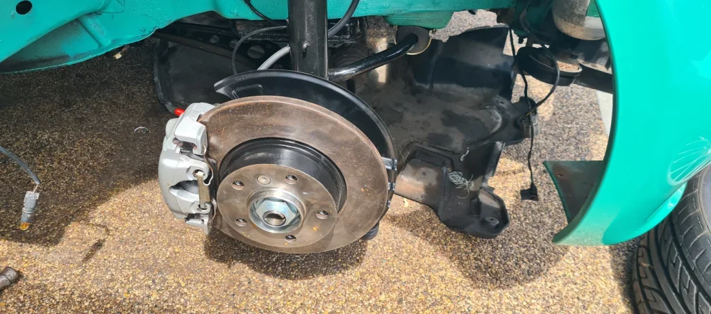

Then it was time for the offside....

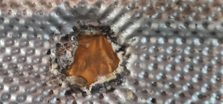

Talking of trim.... thought I'd address another heat shield casualty.. this is the one that goes under the prop shaft....so as before, you need to hammer flat the area of concern
Then dug out an old tube of jointing compound that must have gone off about 30 years ago !!.. cut it into sections to make repair strips
Glued both to the back side of the heatshield
and a quick squirt of Hammerite silver spray... job done

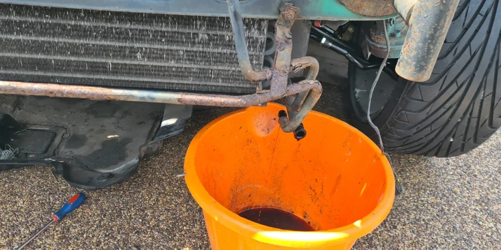

I then turned my attention to the power steering cooling hoop... now is the time for that to go !!... I hate those crimp on clips, and was tempted to go with jubilee clips out of sheer spite..
As it's mounted on rubber supports, the bottom right one was just a petulant child and wouldn't come out unless I undid the back nut as well as the Aircon radiator is in the way.. I was going to replace all of them until I realised they were about 12 quid each !
So no that and managed to clean them up on the brass wheel and a light coat of optimal thread paste.

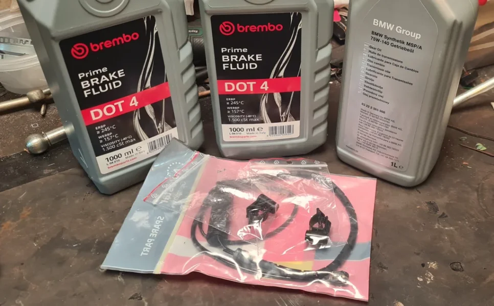

The plan was to bleed the brakes, put the Diff oil in and connect up the brake pad wear sensors and sensor clips....

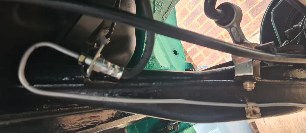

First thing to note while the system was under pressure... two of my new ABS connections were weeping out fluid
So that's the two new ones that go to the Rear Trailing Arms... lovely...... now... I did make these lines long, just in case I needed to redo them..... and I did .
To add to that.... EVERY connection on the rear subframe was dripping. Enough for me to put pots on the ground to catch it..
I could have used the drips as a ticking clock....
When I think back, all the connections that were dripping were ones I did on the vice brake flaring tool. All the front ones were bone dry, and they are the ones I used the hand flaring tool on...... a pattern here I think !
so I remade the flares on the ABS pump..... et voila
I remade the flares on the offside rear Trailing arm pipe, as there was enough material to just make one more flare.
The nearside got too tight after I cut the flare off, so I ditched it and made a whole new pipe with fresh unions.....

Replacing brown liquid with another form of brown liquid ! =))
