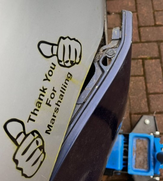

The internet states only a 25mm/1” difference but on mine it’s almost 35mm at the wing edge.View attachment 346333
Are you replying to me? I know the wings are different - I was asking if the trunk lid is a different shape (apart from the licence plate)?

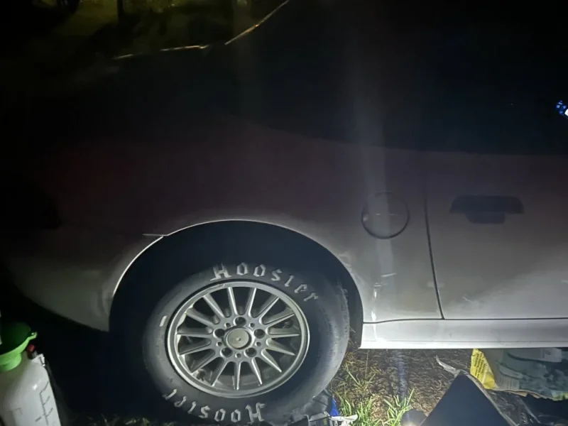

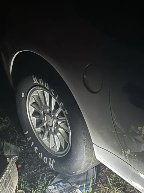

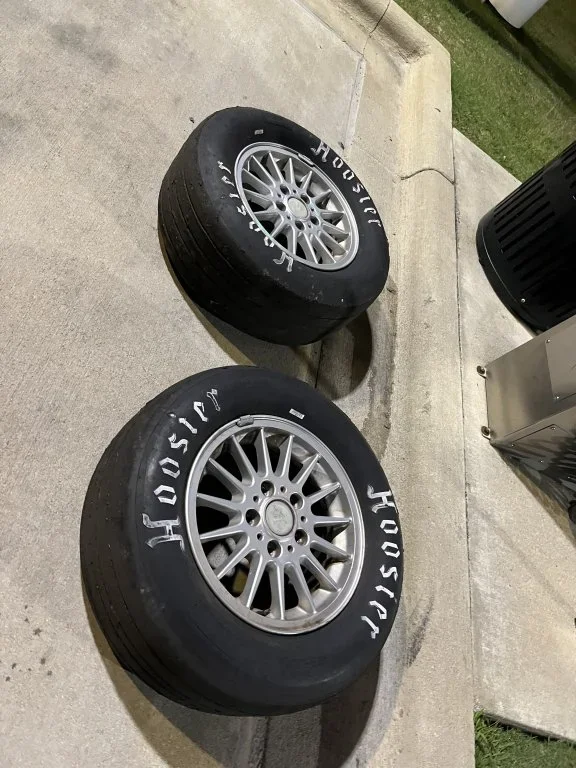

Also I found the most American fitting solution for my traction issues (haven’t put the front set on but I do have matching wheels and a set of tires for the front)
I’ll send more pics in the morning but hoosier drag radials and style 32 wheels clear PERFECT
