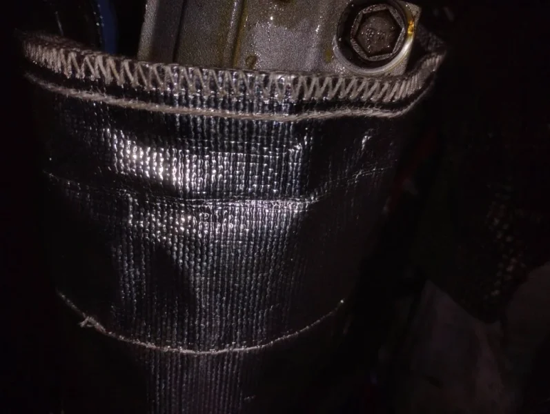

Exhaust is welded up and mounted just need some short mufflers to add later on and to wrap the actual pipe with heat wrap and add some more heat shielding , that being said pretty much every last thing besides the throttle cable and general tidyness is done in the engine bay got the right size vbelt and have the water pump and alternator installed as well as the fuel pressure regulator and lines from yesterday
That being said all that's stopping it from running right now is the fact it's pouring rain and I need to buy a new battery, will send updates latest by tomorrow about it but all that's left on my list of things to do it pretty much
1 install my diff adapter and get a custom driveshaft
2 reinforce subframe
3 install my throttle cable
4 plug the clutch slave cylinder line in the brake fluid reservoir since it's an auto
And after that probably just wrap the exhaust and add mufflers
