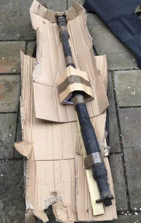

Another prop arrived, the front of that will need shortened and balanced when I figure out how much longer the 6 speed box is.71E3DECB-4649-41B3-AD42-48B51B0F1EEF.jpeg

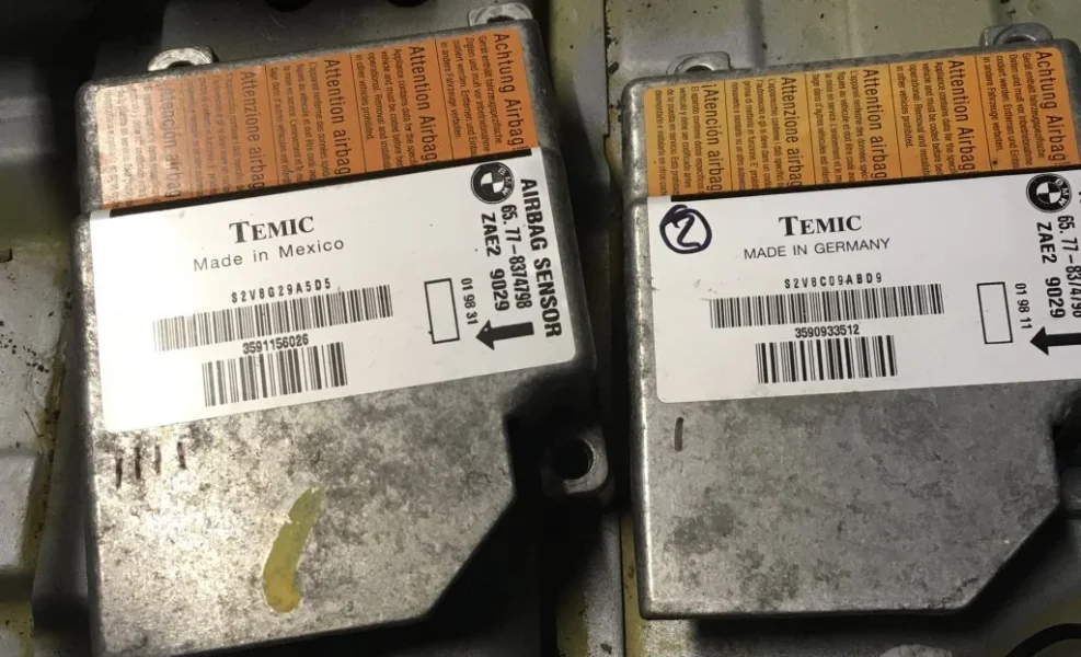

Need to get the airbag light off, except I now also have the asc and pad wear lights on too. The pad wear turned out to be a broken rear sensor, which was weird since I hadn’t been near it.

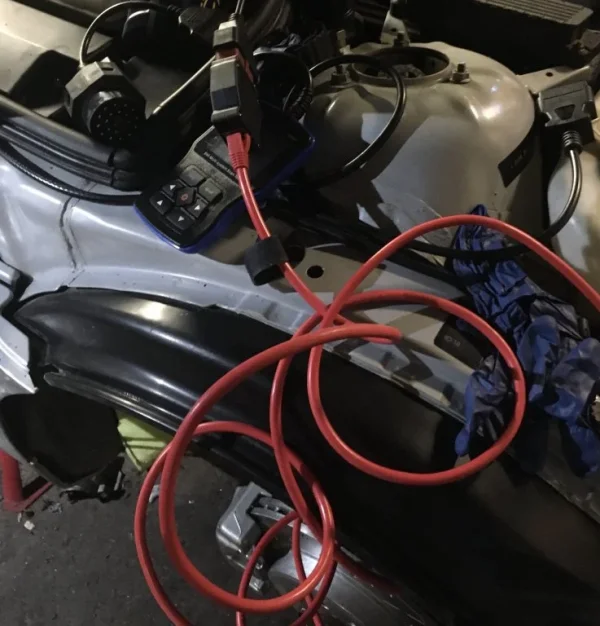

The car only has the under bonnet connector, tried a variety of scanners, none would connect.
Spoke to the super helpful Carl at www.northernautotech.co.uk who had a variety of BMW Z ecu on his bench. He managed to reset it, had 3 events recorded which, after discussion, were likely shorts from water under the seats and probably the steering wheel. I sent him another from eBay as he could clone the original. £80 all in, including all the recorded delivery twice, I think that’s not bad at all.
The hash marks are how many times the ignition has been on.
Original on the left, light was on and the scanner still gave a connection error. Tried 4 times, as you can see, nothing. Tried the clone and bingo, light went off, but, I still had a connection error. Who cares though, the light was off. Until I disconnected the battery. Soon as it was reconnected the bloody light came back on. Bought resistors and fitted them to the seat connectors. Light still on, thought, I’ll try the airbag and found the horn now doesn’t work either. So the slip ring is now the likely culprit.
Bought a s/h laptop to dual boot, then install inpa and Jaguar’s sdd, the abs on the Jag is also kicking my arse.

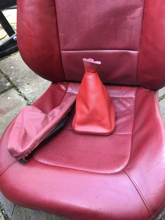

Spoke to Furniture clinic and ordered leather colour BMW Montana Tanin red and a few other things.

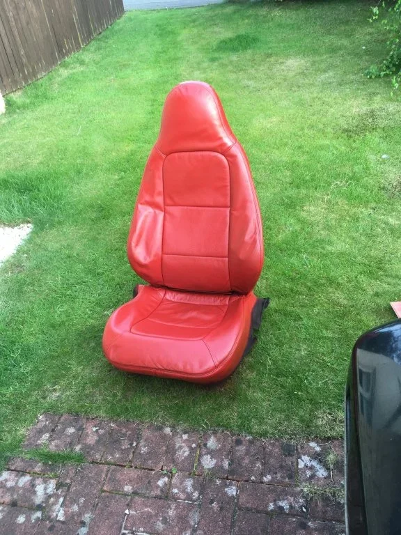

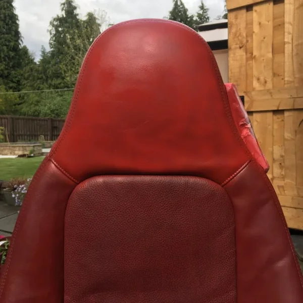

Fired up the airbrush and Ooops! My tanin red seat isn’t tanin red. The new hand brake and gear lever tanin red covers don’t match either the seat, or the colouring agent. Feck it, just colour everything.
F09E6A35-95A6-4B16-917C-0A43519036A0.jpegI
I thought I had a pic of the black seat, needs another coat, but looks great.

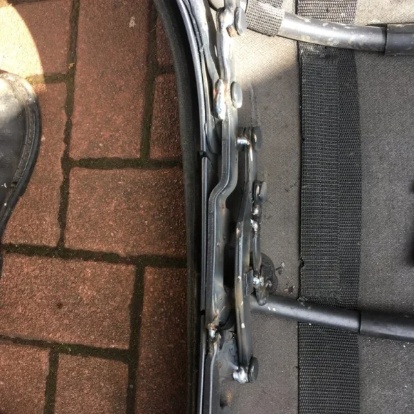

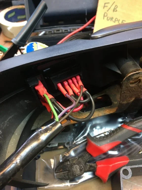

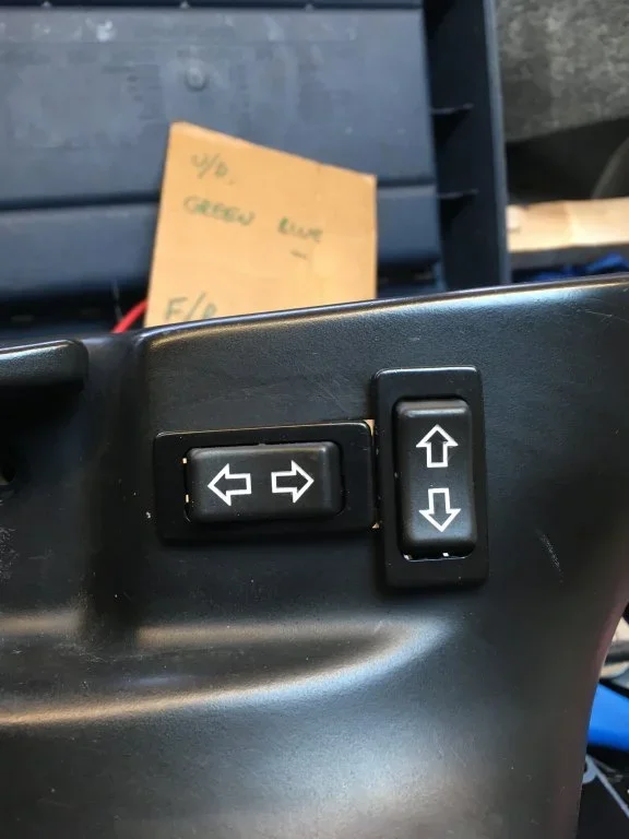

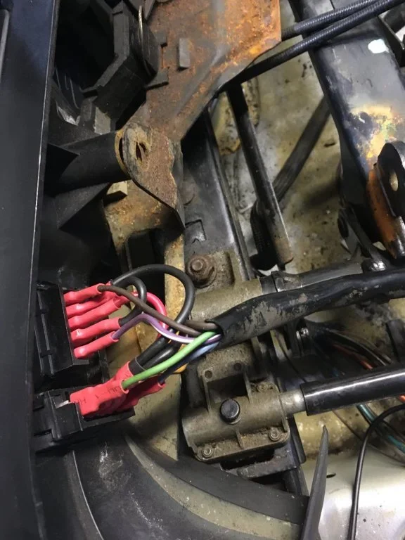

I the need to make the mechanism work, the covers on both switches are broken off and one of the pins is broken on the drivers seat. Bought a few rocker switches, fairly easy to set up.
Have you spotted the grevious error though? I completely forgot where the seat has to go!
51668F9F-39A2-4008-8C5B-06CFACC2C76E.jpegI
I need to see if I can get some flag connectors (right angle), either that or I relocate the switches.

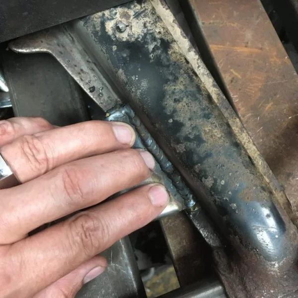

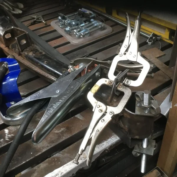

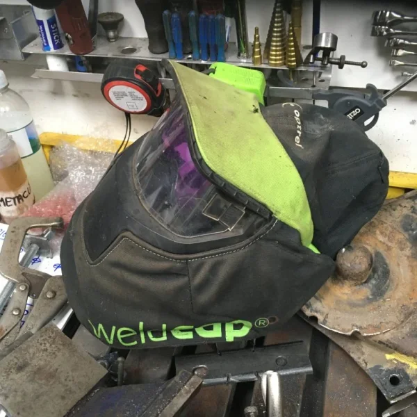

I had a new roller for the mig arrive, so I had a play with the welder and some scrap offcuts. It’s only 1mm sheet and no one will see it except the Mot tester, went a bit mental with the dimple dies, just for a 😂. I really don’t like that Ronseal metal paint though. Took about half a dozen coats and shows all the brush strokes.

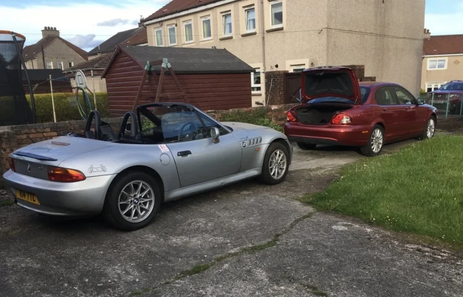

My Ignis Sport went on Sunday, so space on the drive for the Z.
Tried yet another BMW specific scanner and it can’t access the airbag ecu either.
Tried from the laptop and there’s something not configured properly. Disconnected the airbag ecu. It can get transported like that.
Fixed the Jaaag though, problem was the new abs sensor replaced last service (not by me).

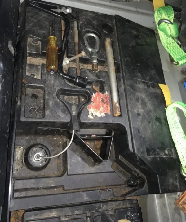

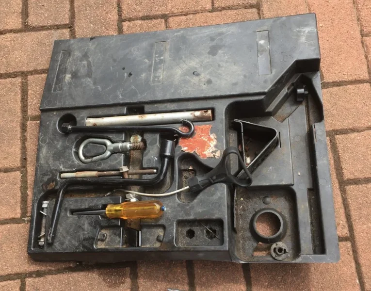

Decided this abomination is going in the skip, pointless waste of space. I can put all the tools in a roll in the corner and free up maybe 5-6L of space. Doesn’t sound much,but sometimes I carry mountains of stuff.
Getting rid of that tray will give a flat floor too, much neater. Something else to make, floor panel and insulated battery cover.

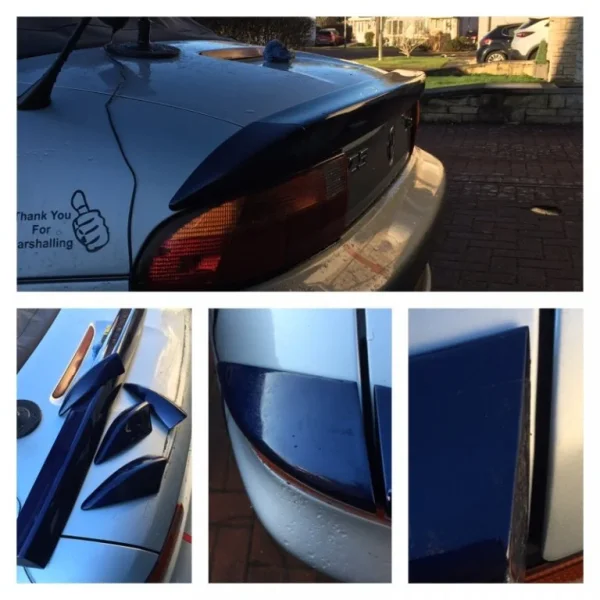

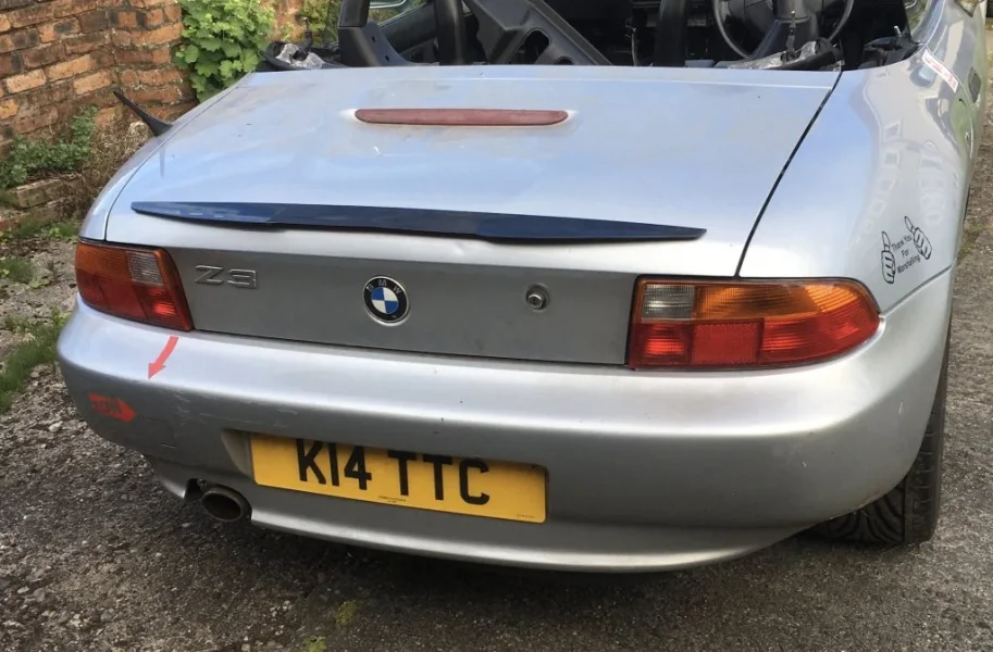

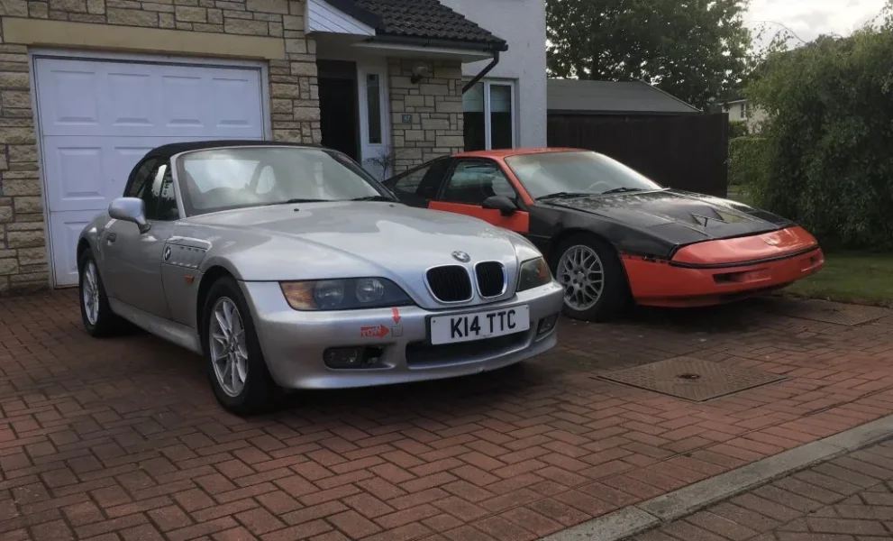

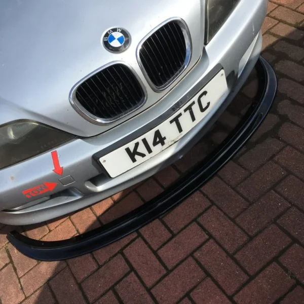

The X type flew through its Mot and came up with me to polish clean and sell. The Z came down off axle stands and made its way outside. The last time it was behind the X it was being towed.

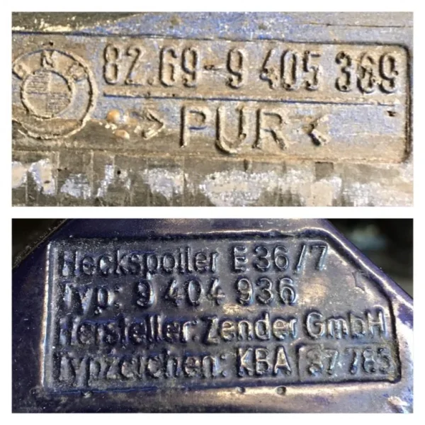

That spoiler thing is so unbelievably hideous! I absolutely love it!C094FDCB-89B4-4A8D-9437-386EFAF395E2.jpeg

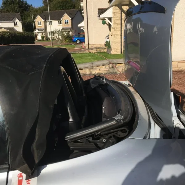

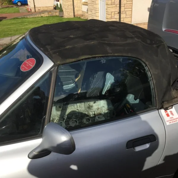

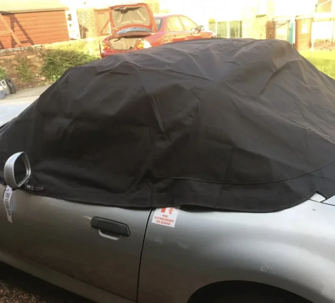

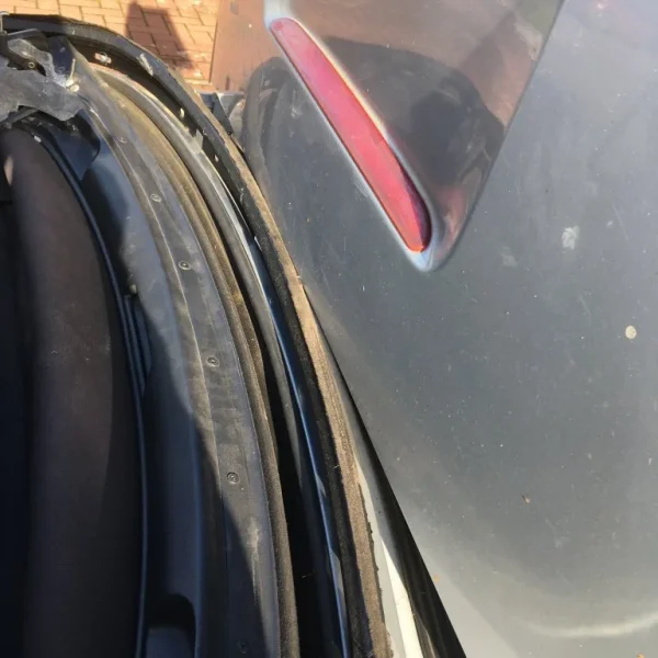

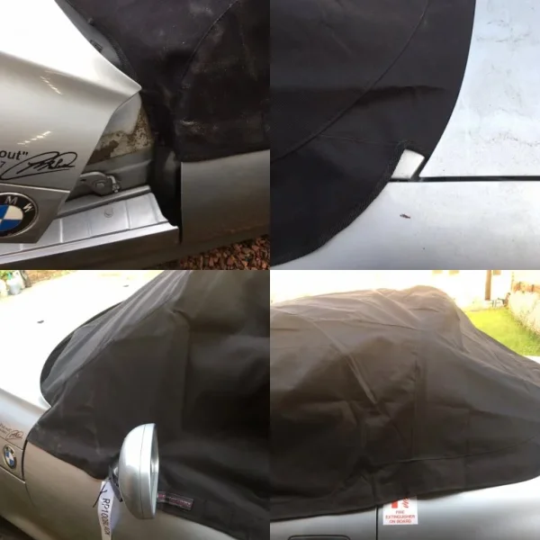

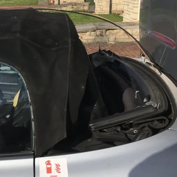

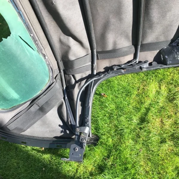

This little bag arrived from Custom Covers. Contains a waterproof hood cover.

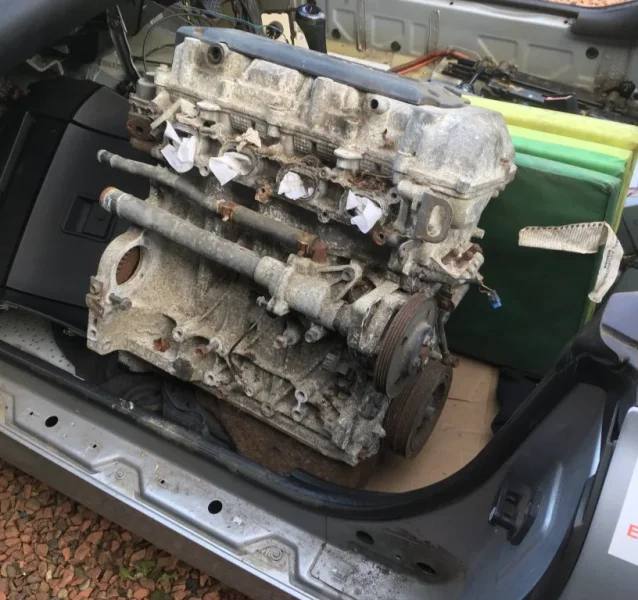

First though I had to load this engine for transport up. I must be getting weak in my old age, struggled to get it in there on my own, Suzuki M15a Ignis Sport motor for another project.
Up with the hood and I tried the cover. Very neat design, once it’s on it can’t be dislodged or stolen. Locked in place by the bonnet and boot lid, sides are held down my magnets. Very impressed.
It looks a bit baggy, it’s just because I’ve pretty much thrown it on as a trial fit. Very well made.

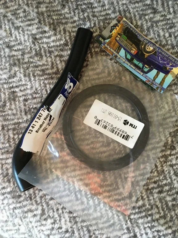

Rockauto in the States had a special on parts, so five oil filters are in the air somewhere and this gasket arrived today, £2, I really need to cure all the oil leaks.

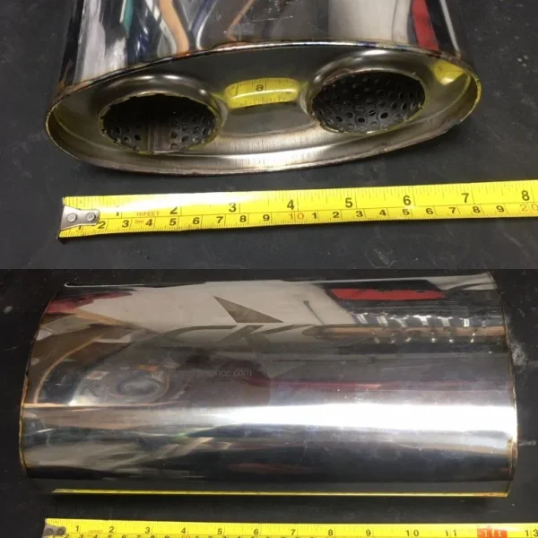

Stainless centre box, yes, yes, I know the 1.9 is single pipe, mine won’t be. The twin 1.75” pipes are near as makes no difference the same area, twin pipes into the biggest back box I can make from scratch.

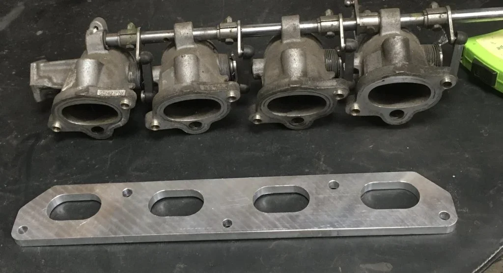

So, why are mates bastards? A couple or three months ago he dropped off some pistons and rods to balance. And spotted the V10 throttle bodies I had lying about, “Those for the BMW?” “Nope, Fiero”, “so that leaves 6 spare then!”
A little research and

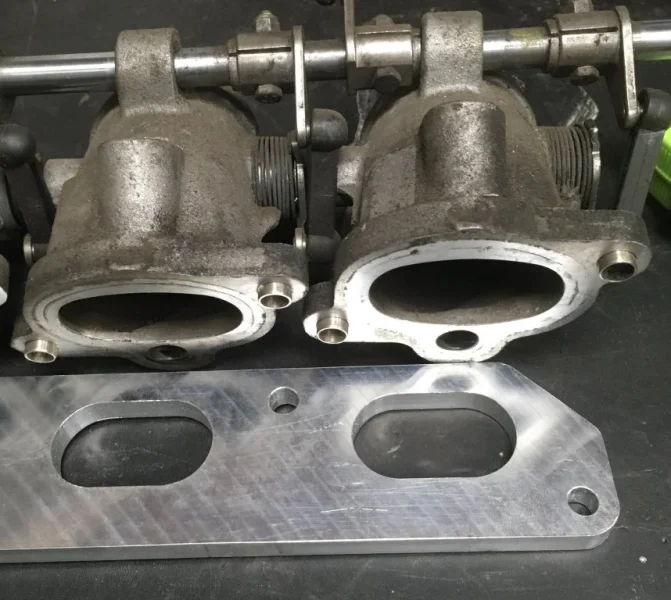

https://danstengineering.co.uk/ supplied this
The V10 bodies are a little larger

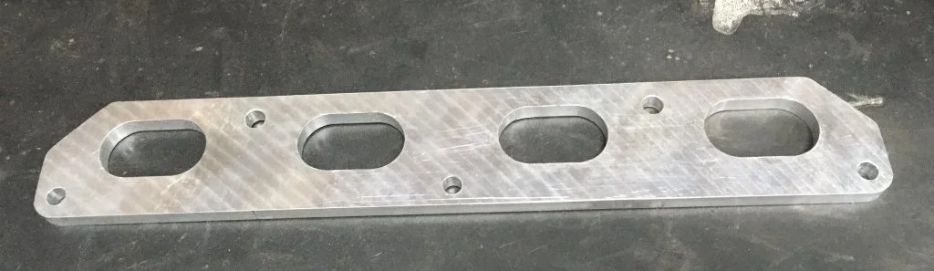

Which means a spacer, that’s not brain surgery, time consuming, not hard. An air box, that’s moulding, simple.

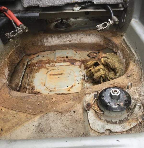

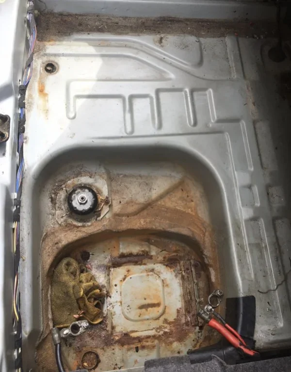

Completely emptied all the crap in the boot today, quite surprised how much trim, junk and tools I had in there.
This is set aside to go to recycling, I’ll find a newer one I wouldn’t be scared to fit.
The tool tray thing came out easier than expected,
9B4C5DF0-BF8A-4F63-B212-107E5839C597.jpegto leave what is quite a lot more space,

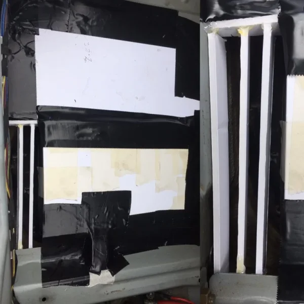

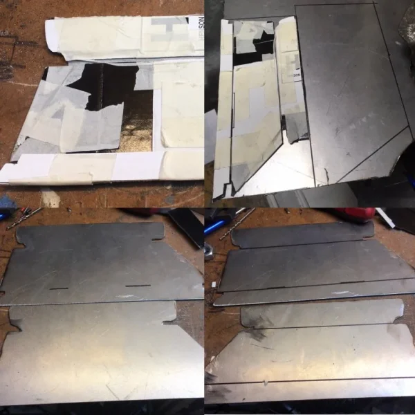

Now I need to make pattern, actually two patterns, one for a battery cover and one for the floor. All the tools will go into rolls, far easier to store/access, and, you can lie on them if you have to.

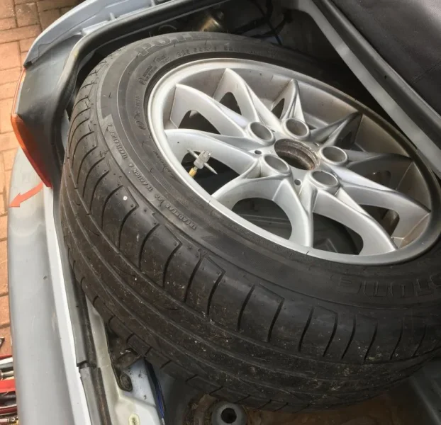

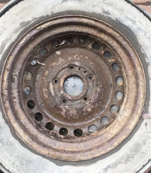

I had to try a wheel/tyre, it’s a 225, I reckon the original cars 205 section tyre would just fit.

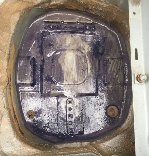

Strange that it’s set up for 3 sizes of battery.

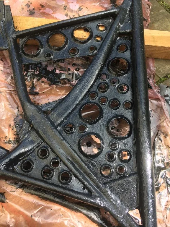

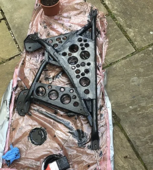

Cleaned up and coated with Jenolite rust converter, I’ll overcoat with silver Smoothrite.

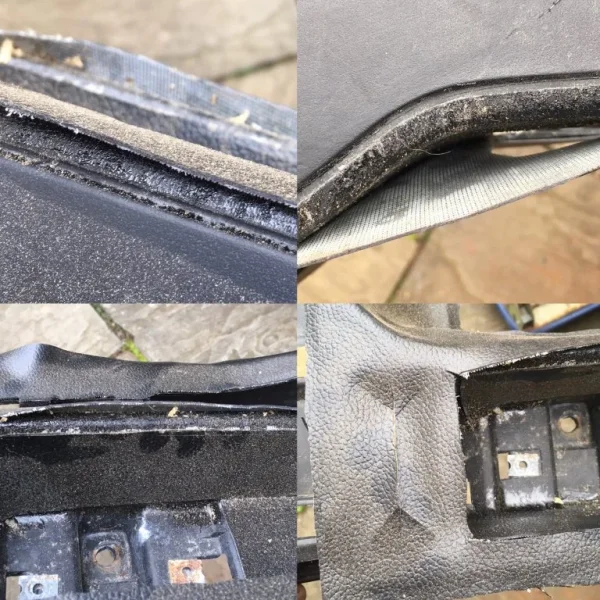

I’d bought oneof the little chrome lifter for the boot lock and went to fit it whilst I had the Jenolite out. Could I find my big step drill though? Nope. Job for another day.

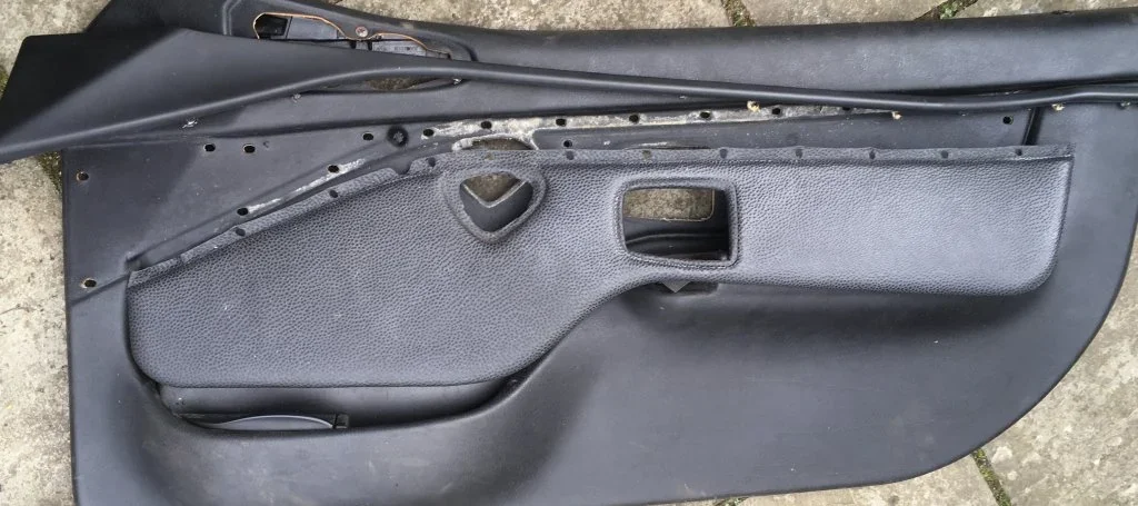

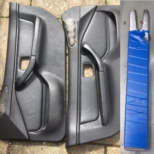

The drivers door card was loose at the top, decided to remove both as I wanted to sort out the speaker covers, been painted silver, badly, with overspray everywhere. With my garage now jam packed with all the extra stuff from my father in law’s place, I couldn’t find my panel tool so had the quickly make one.
Top tip, if you have to use insulating tape, cut it, don’t tear it. Tear it and it stretches, then it doesn’t stick, unravels, makes a mess of your hands etc.
2nd Top tip, BMW use biscuit (really, that’s what it’s called), rather than the formed plastic, or hardboard, used by some other companies for door cards. If you lever with a screwdriver rather than something which fits both sides of the plastic stud it can break up.
I wanted to spray the leather to match the seats, almost just masked it, but noooo, I just had to be a smart arse and remove the leather panel. Muppet. It’s not on with screws, the plastic studs are melted on the reverse. A countersink bit made short work of it, that was when I realised the edge of the leather tucked under the trim piece above, that had to come off too. Should have just masked it.

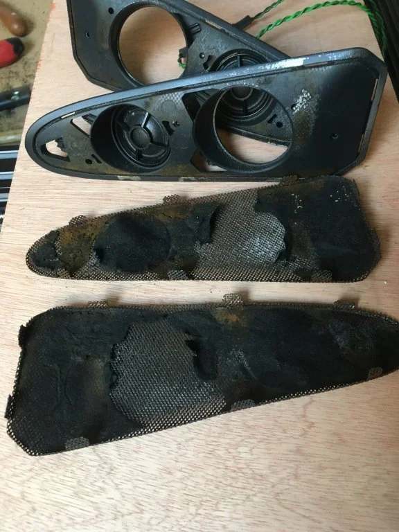

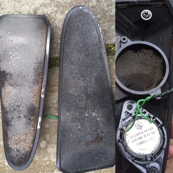

These speaker covers are a mess, ordered some stainless mesh, try saying that again. Quickly. If it doesn’t look right I’ll micro blast the originals and repaint. Space on the back for speakers I don’t have, I’ll see what I can find to go in there, and I’ll need to see if those tweeters actually work.

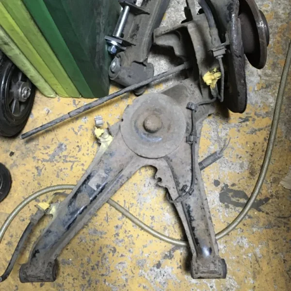

Picked the wrong weekend to drop the rear out, weather forecasty app says 90% chance of rain Sat and Mon, 100% on Sunday. Lovely.
I can work a ratchet in the rain, but fibreglass is a bit more tricky, so attacked the boot floor mat whilst it was dry. Once I’d fought my way into the garage. With the amount of stuff that’s come up from Airdrie I can barely make it in the door.
A serious parts cull/eBay/skip sort is required.

5 oil filters from those helpful folks @ rockauto.com
Look at those prices, just look at them! The carriage was twice the cost of the filters, but still came in at £3:60 a filter 😂 And I got them quicker than from Europe with noCustoms hassle.

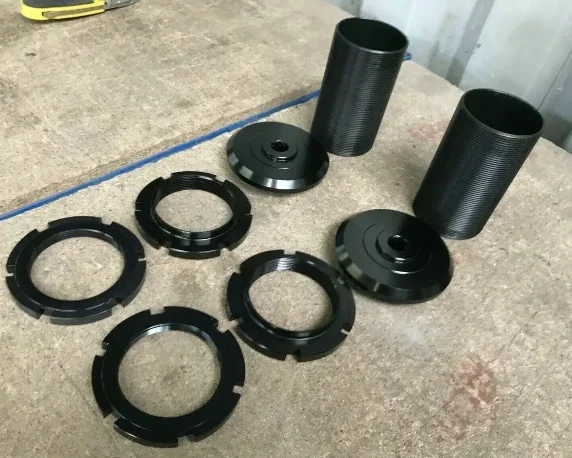

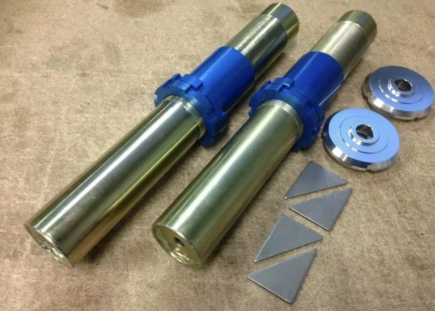

Then these:

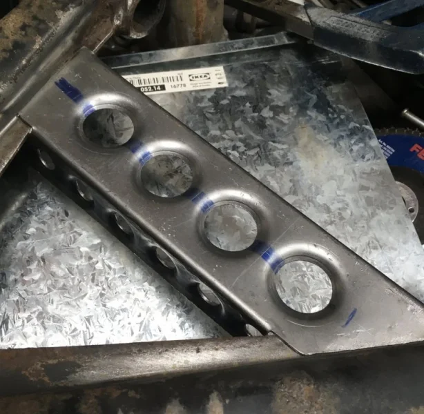

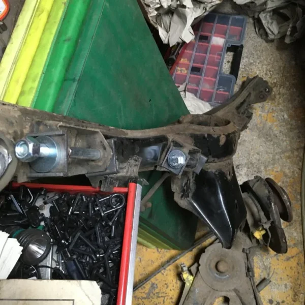

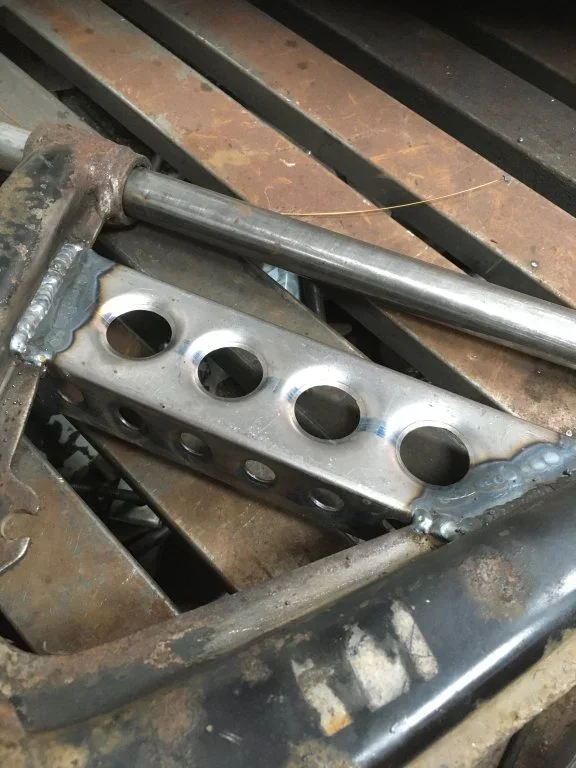

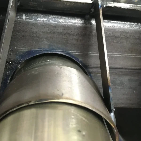

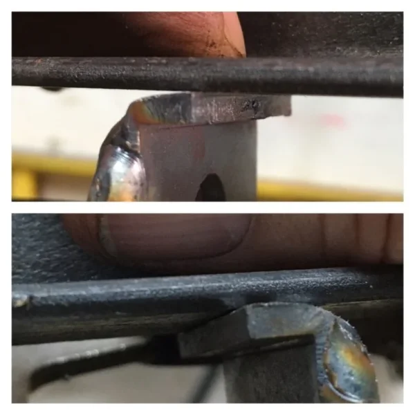

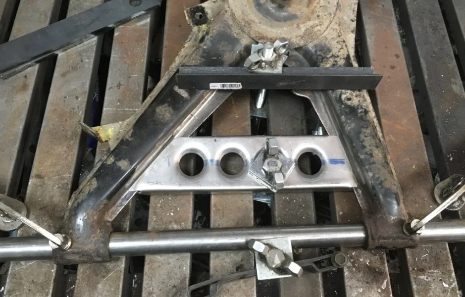

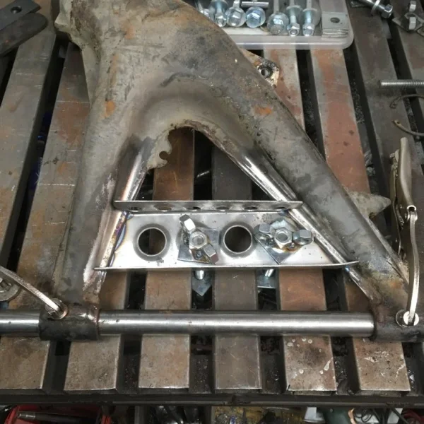

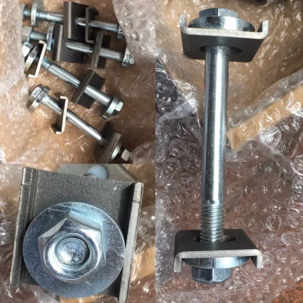

Once welded to the subframe, these allow the camber and toe to be altered. I can lower and play with the suspension to my hearts content. There’s another version with serrated plates, those should be more secure in the event of smacking kerbs, sliding sideways etc. Should also be a helluva lot more awkward to adjust on my own, so the cam bolts will do the job. If necessary I can drill and roll pin it to secure the toe.
Grinding and welding the the rain, love it, I can see a tarpaulin hooked to my garage and bungee’d to the front of the Z in my future.

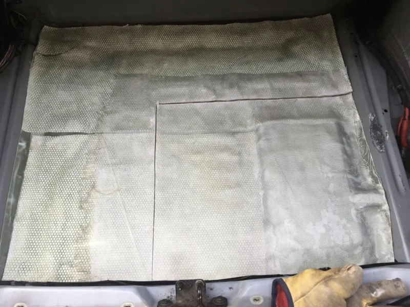

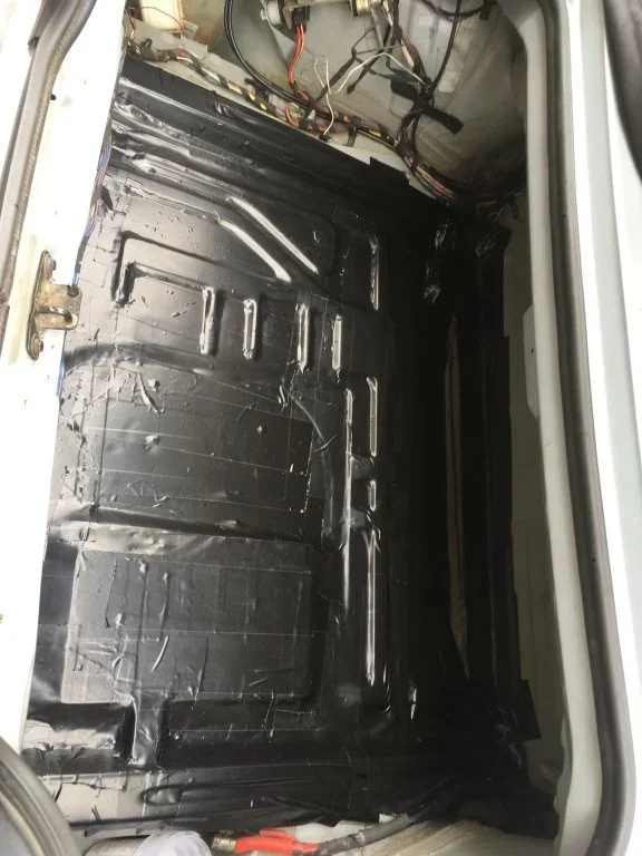

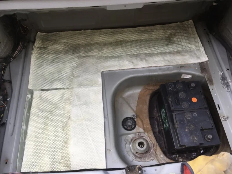

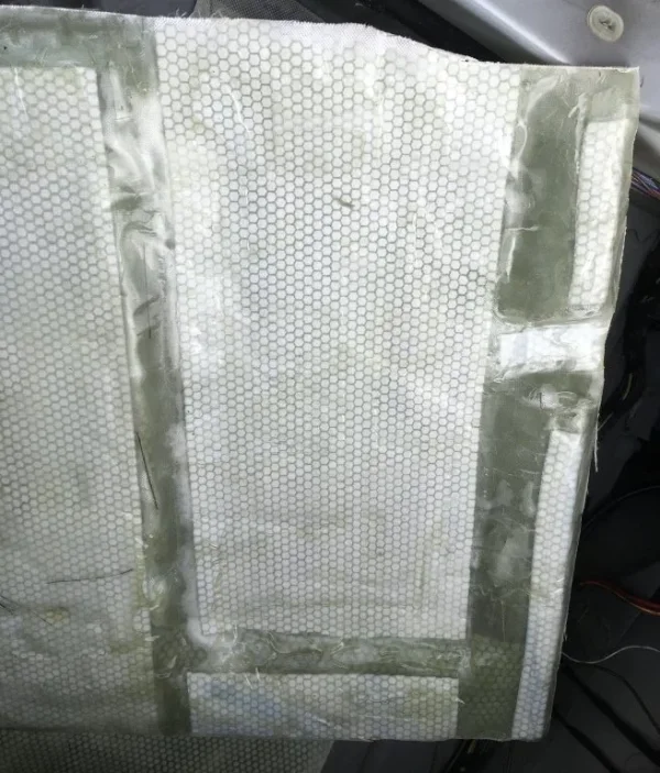

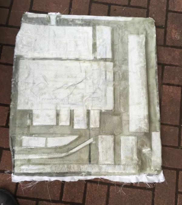

In the meantime I tack ragged the boot floor, installed the battery and stuck 2 layers of foam board on as a spacer. Filled in the voids with more foam board, hot glued reinforcements, then covered the whole floor in polythene tape. Resin doesn’t stick to poly tape, but I took the precaution of giving it a couple of coats of Easy Lease release agent to ease my paranoia.
Eww, and after that my pics have gone blurry, so anyway, laid down a couple layers of woven cloth, layer of core fabric and a few more layers of cloth. I have over 50m of woven glass cloth and it’s much easier to work with than CSM (chop strand mat).
Tomorrow I should see how well it’s worked.

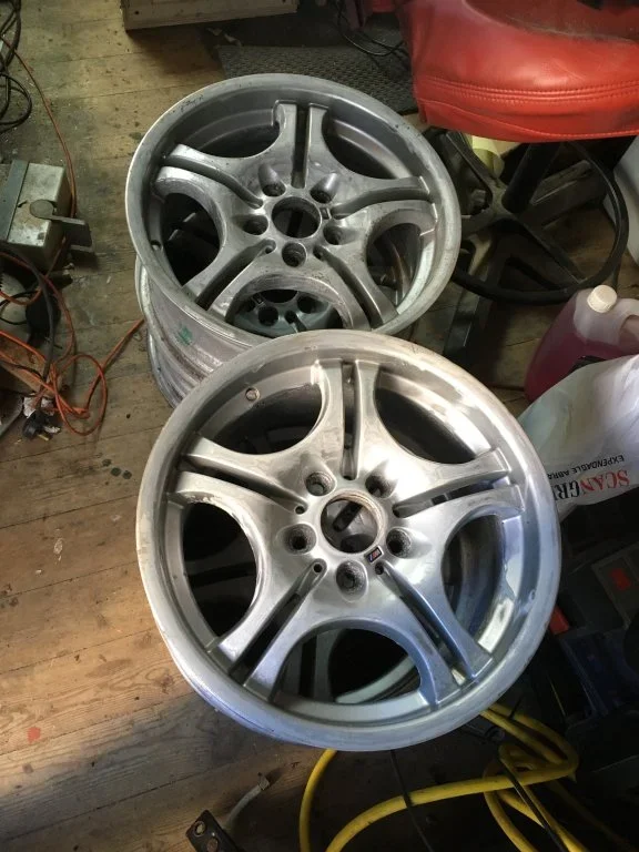

Picked up a Style 5 in 8Jx16” to try, but looks like I’m out of luck. That’s only a 235 but it already looks a bit Carlos Fandago (ask your parents, or Youtube), never mind with the 245’s.

Made a mistake with my boot floor mat. I should have put a 5mm spacer at the front and rear. The rear wall narrows as it rises, so the damn thing wouldn’t come out, I had to bend it slightly, which damaged a corner. Easy fix.
Trimmed the edges, wear gloves at all times, both sharp, and an irritant. If you’re daft enough not to use a good quality mask, you’ll only do it once as you will be coughing up razor blades for a week.
Marked (badly as it turned out), where the the battery box is a cut that panel out.
With the battery cover on.
I’ll trim and round the edges, then cover in some sort of carpet. Somewhere I have a roll of soft rubber for the base.

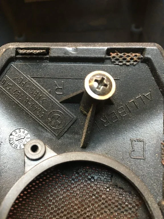

The stainless mesh I ordered for the speaker covers arrived, but won’t do the job, so I folded back the tabs and carefully pressed out the old mesh.
Very, very easy to distort, I ended up using plastic wedges to lever it out.
I’m not even sure what the black papery stuff is, it’s thinner than any acoustic cloth I’ve seen. It’s completely disintegrated anyway. I’ll microblast them with alumina and spray satin black.

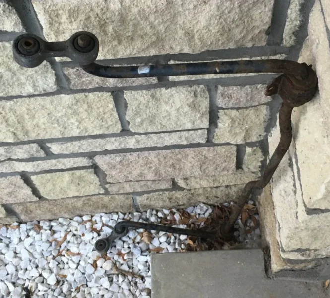

Ebay supplied another rear anti roll bar, I have two different ideas in my head to make a rear bar adjustable. Not sure which method I’ll go with yet.

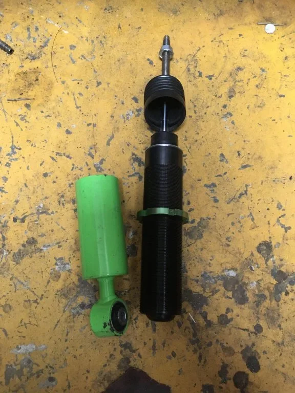

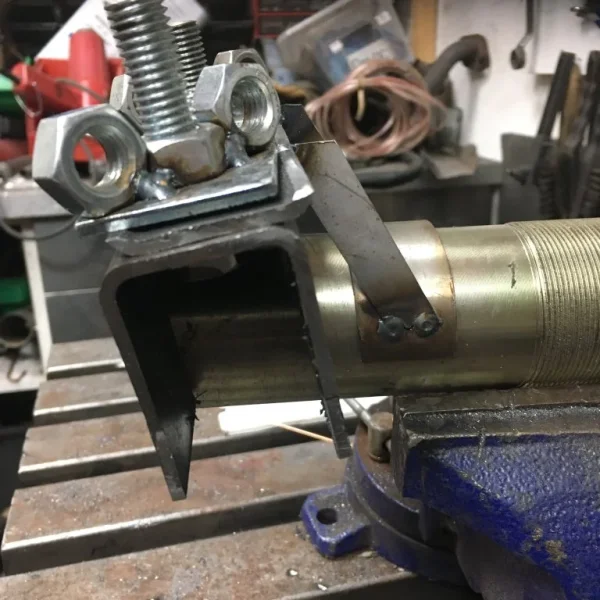

Waiting on weld on spring platforms to arrive for the front struts, decided to convert them to adjustable coil overs. Actually wondering if it’s possible to go that route at the rear, I know some of the Compact Cup cars use them, though expensive custom items.

The sleeves for the front coil overs arrived and I’d ordered the wrong ones so had to go back, like these
Been trying to decide whether to continue that route, or just get new tubes
Tubes obviously need brackets, that’s not hard. The old struts need a brake bracket remade, another repaired, new seals, the de bushes seem fine, then finished and painted. New tubes are only £25 more expensive. And writing that out, it seems obvious now that new tubes are the way to go.

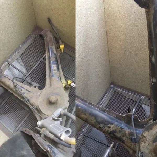

When I built my blast cabinet I wanted to do wheels easily, takes the arm with ease.
Im impressed with how well the paint has lasted.

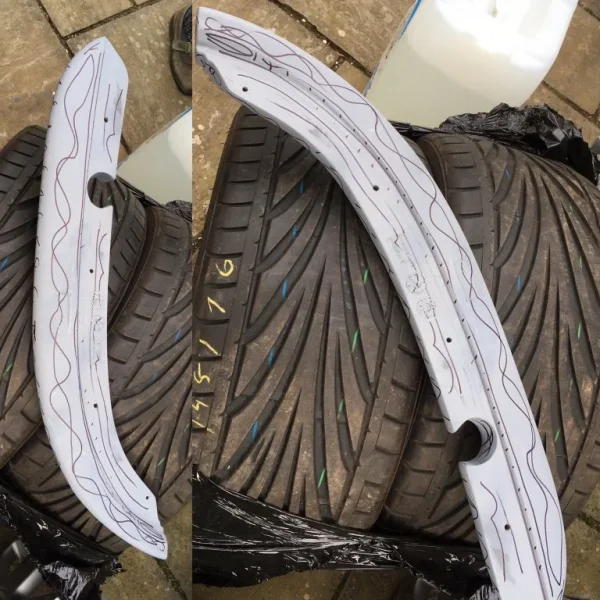

Bought a splitter, not realising post facelift bumpers must be a different profile, goes nowhere near it. Oops!
So spent ages with Trnio trying to make an STL file of the one corner splitter I have, without success
It’s too smooth, not enough surface detail, I get lots of artifices I can’t get rid of. So, yet another project, make plugs for a pair of corner splitters from mdf.

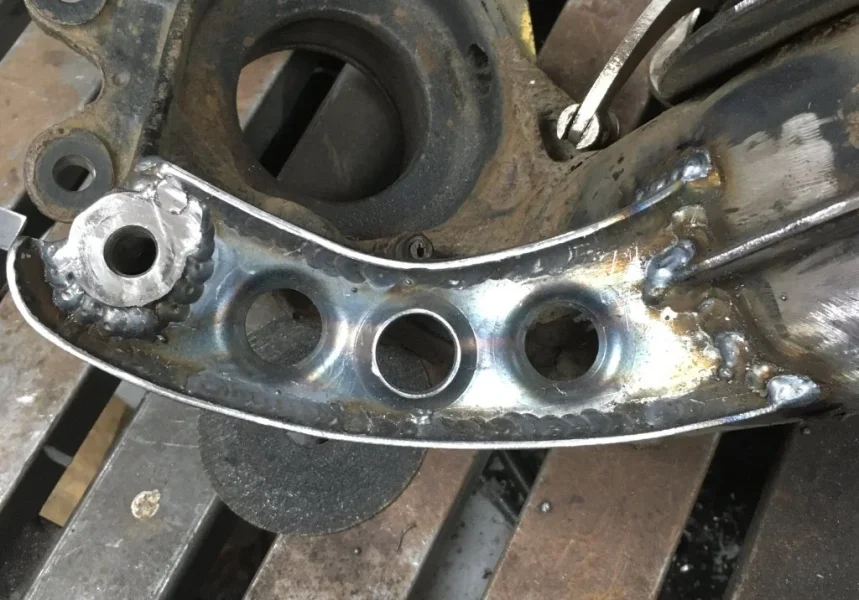

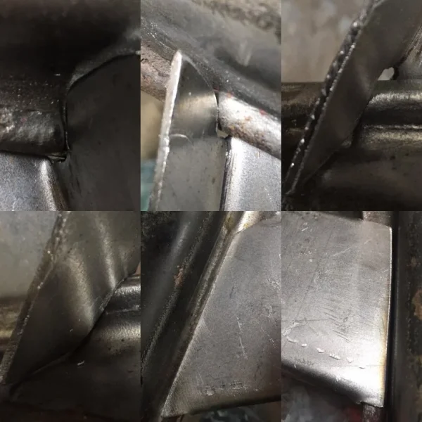

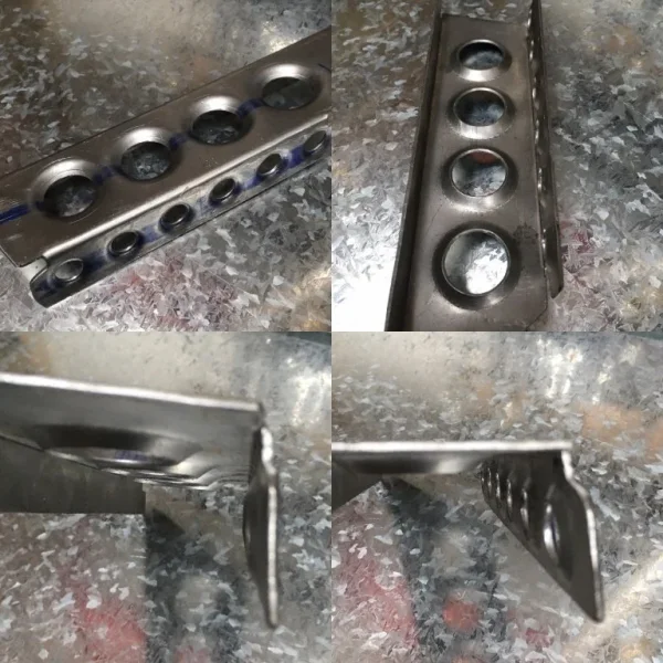

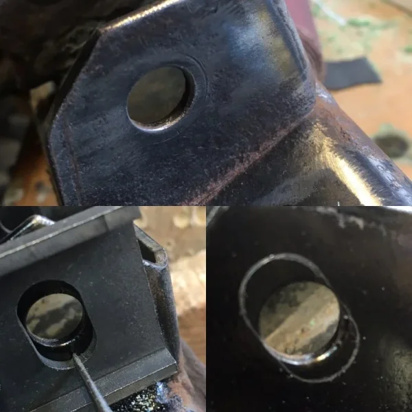

Removed the bushes from the beam and started on the adjusters. Contrary to popular belief you can adjust the standard holes if you can weld. No, it’s not using an Imperial bolt, that way is madness, old back in the day method of selling a car with bent suspension. I know first hand having to help fix such a car a friend bought.
Normally you want to weld the tab on before cutting the excess out with a tungsten cutter. That’s how you adjust “non adjustable” suspension. I’ve made a little cobalt chrome fixture though, so no chance of nicking or marking the tab.
Once I fit this to the car I can do my own for someone who can’t weld.

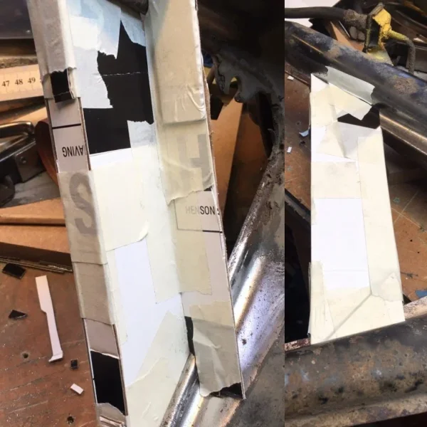

The later trailing arms have a brace, started on making my own. Card and masking tape. Don’t bother trying to be super accurate in one go. Use small bits and simple tape them together. Transferred to 2mm steel sheet.
Only needs one pattern, you just have to remember to flip the pattern before it’s bent.
Fits nice and tight. Once it’s finished you can make a paper pattern to save time on the other one. Then keep it for future use.
If I’m going to go custom, feck it, I’m going to go CUSTOM. No one will ever see it, except the Mot guy. Hopefully. I know it’s there though and it’s my car.

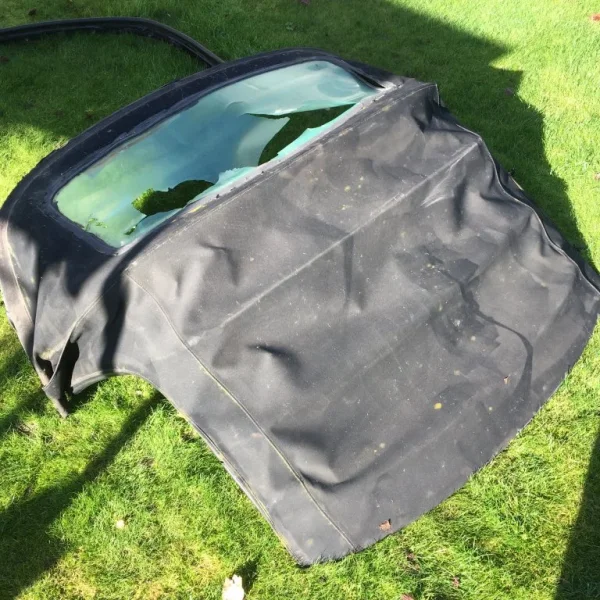

I’d recovered the rear bits where the bars mount, then the console, in vinyl. Discussing with a friend, “ hope you didn’t use Screwfix, their adhesive is no longer high temp”.
Indeed I had.
Stuck the console in the shed window, full view of the sun. This happened.
All peeled off. Lesson learned.

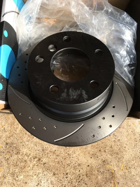

More bits arrived, hose from Rockauto, rear discs from eBay.
Even with carriage the hose and oil seal were half UK price. Thankfully, no oversize pistons in stock.

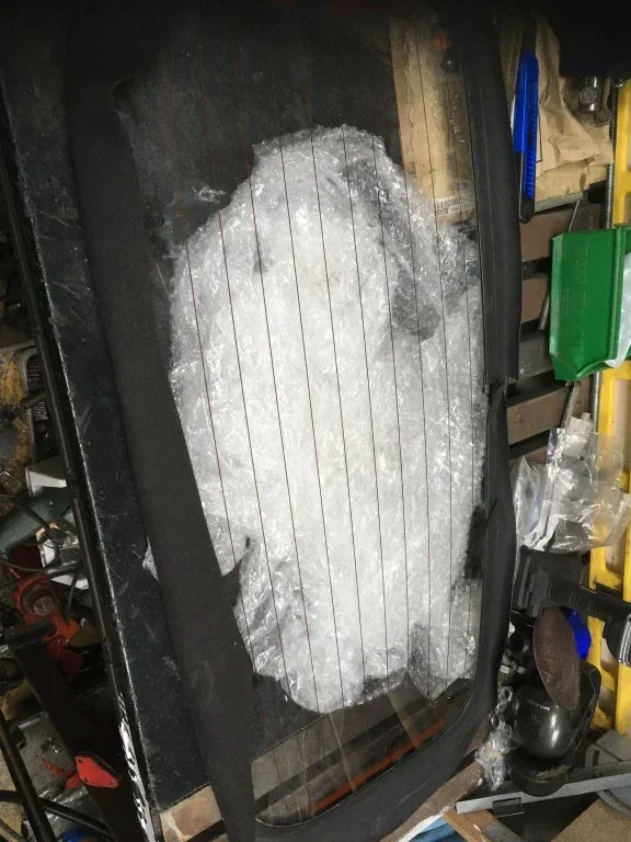

Started my hardtop project. If I rush I should have a buck before the end of November. Will leave it like that until next year.

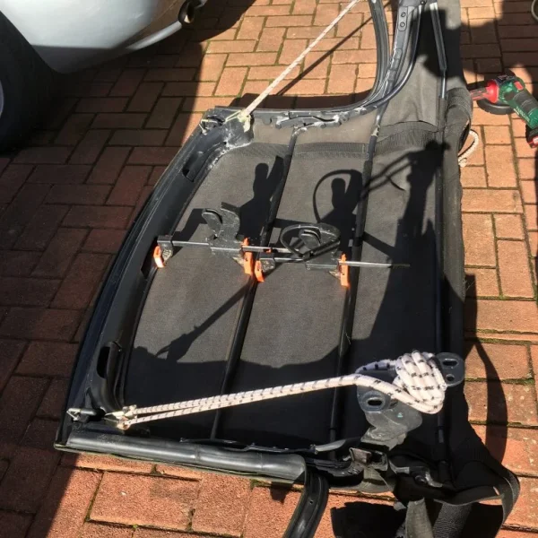

Cut off the rear and tension it, weld all the pivots.
Remove brackets and tubes getting in the way.
Lift onto the car
At this point think, “ooh, 2 piece Targa”, then think, “ shut up unconscious mind, you’re a p*****”.
I did think to open the boot and check how much clearance there is to play with.
Just as well, I had planned on using the metal spreader/seal. That’s not now happening. I’ll need to make a template, then, I think, a hardboard base ( because of the shiny side).
Metal rods, or strips, as guides.
Then chicken wire skinned in fibreglass. And filler, and lots and lots of sanding. It can sit like that until I make a mould. I only need it November to February. I don’t need a rear window, I leave and return in the dark, a rear camera will be fine. A plastic window would be light, but then I’d legally have to clean it. Scraping ice off at -10C ? Wouldn’t last a week.
I want the whole thing light enough I can quickly remove it on my own for the days I need/want to use the car. Yes, hood down. In winter. That’s what heated seats are for.
Under 25kg is the aim.

Acquired a staggered set of 68’s. Require powder coating. I’m not sure whether to fit them to the Z, or use them as winter wheels on my wife’s coupe, putting the BBS RC’s on the Z.

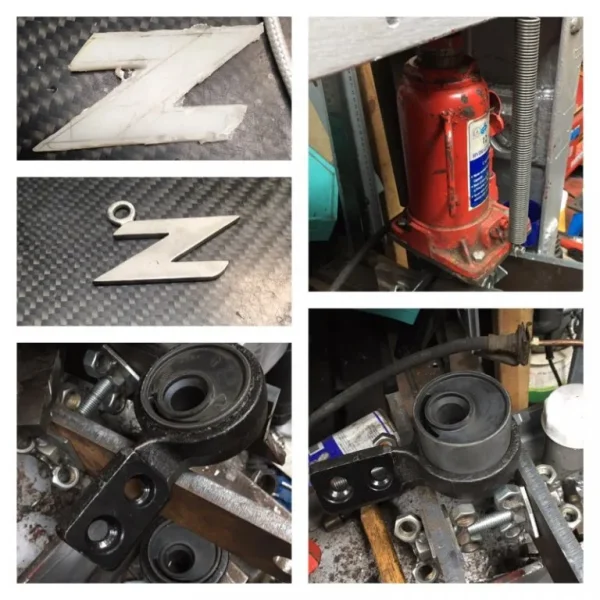

Spent a while stripping some wishbone bushes out for my son to fit poly and me to press in M3 bushes. It’s strange that brackets with bushes fitted are cheaper than bare brackets.
Anyway, I have a home made hydraulic press which made an easy job of it.

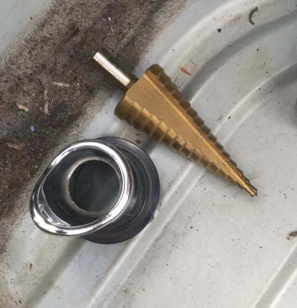

The Z is a cobalt key ring I made at work. I like to have Custom key rings for my cars. As you do. Didn’t turn out as well as hoped, not enough sprues I think, so have a contraction crack in the middle. The 3 is in the finish, bead blasting, brushed outer rim and polished edge. I may heat treat to to give a black outer rim.
Though I liked the utter hideousness (if that’s a word), of the Chinese spoiler, I found two corners for the original BMW/Zender spoiler. Planned on making the Center from scratch. Of course then the full lot turned up, so now I have lots of options.
Not actually the greatest fit, I can’t decide whether to just fit it, or adjust it to fit my car and make a mould. The fact I could finish it in carbon and not have to paint it, is probably swaying it in that direction.

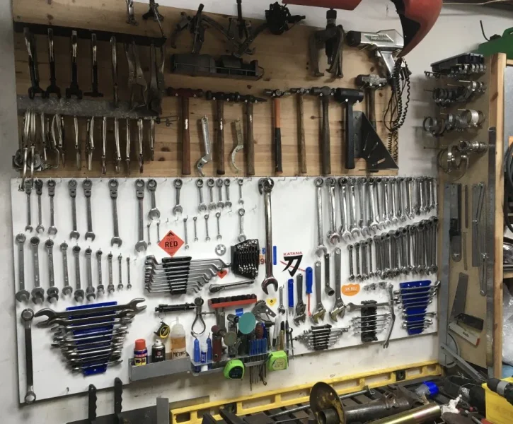

So much stuff and tools came up from my in laws I ended up completely rearranging my spanner wall. It was Lidl/Aldi plastic panels, it’s now mdf and clips. Highly recommend it.
I used to use two roll cabs and a top chest, totally useless in my tiny garage. Sold them on and now use intermediate chests in IKEA Ivar shelving, the wall, and a small tote, definitely wouldn’t go back.

Reinforced the trailing arm
If you’re doing it, the bush diameter is 27mm, that’s not commercially available as bar. I used 25mm with 1mm sheet wrapped round. Zap and chill prevents warping.
If you think it doesn’t work, I’m touching it 30sec after welding, if it were seam welded I’d be in the burns unit.
Ok, so I may have gone a bit mad, just a bit, but what the hell.

At the front I’m working on the new casings for the Bilsteins, that’s proving to be a time consuming pain in the arse.
After measuring and measuring, even more measuring, it still doesn’t fit. I’m on version 2, which is now much closer.

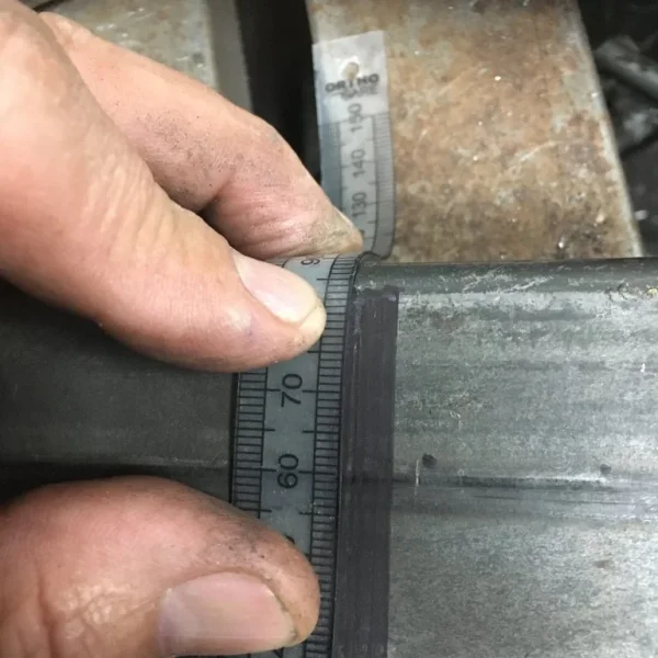

I always see people struggling to transfer lines from one face to the adjacent. Here’s an easy, totally fool proof way, use a plastic flexi ruler.
I’ve been asked several times in the last couple years about welding gear friends should buy. This is my number one, an Optrel Weldcap
I really can’t recommend this thing highly enough, it’s light, super comfortable, let’s you get into super tight spaces and the vision is superb. They’re about £100 ish, but so, so much better than any of the cheaper helmets, none of which cover your full scalp, or let you into tight spaces.

I have bits of Z all over the house, in the shed and so much in the garage there’s a tiny space to shuffle up to the welding bench. That’s after three car loads of bits to recycling.
Likely going back together with no carpets, just so I can mop up any leaks.
