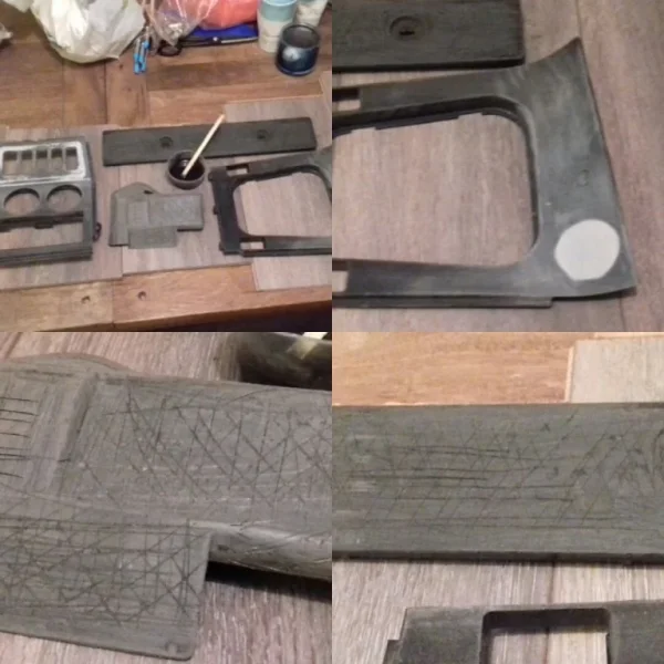

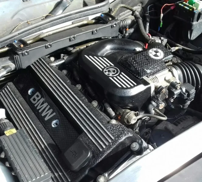

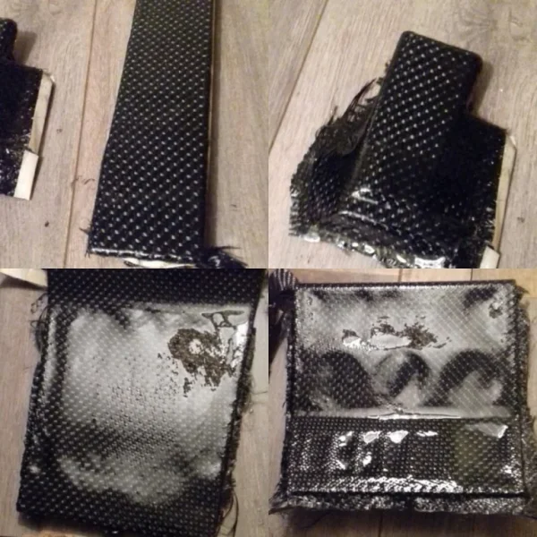

Soooo, in amongst everything else I'm attacking the carbon skinning.

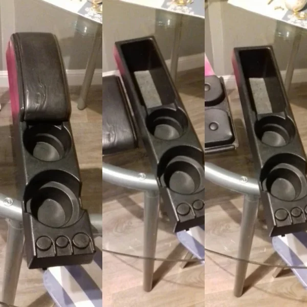

Oh, and I scored this off evil bay, I'd never seen one with the little pad before. Won't fit mine now I've modified it, but I have a use.
The coil cover didn't work, couldn't get enough definition on the 'BMW' so I stripped it, which took a fair bit of effort, nice to know. Removed the letters with a sharp chisel. This is it, and a few other bits, ready for another go. Thin flexible plastics you have to score deeply to give the resin something to grip. It's not seen once the fabric is on.
The lighter socket annoys me, will be relocating to the passenger footwell. Filled it, though had to do it twice, the plastic was cracked so the filler was moving during sanding. Ended up removing it, drilling round the recess and inserting a few screws so the new filler stays secure.

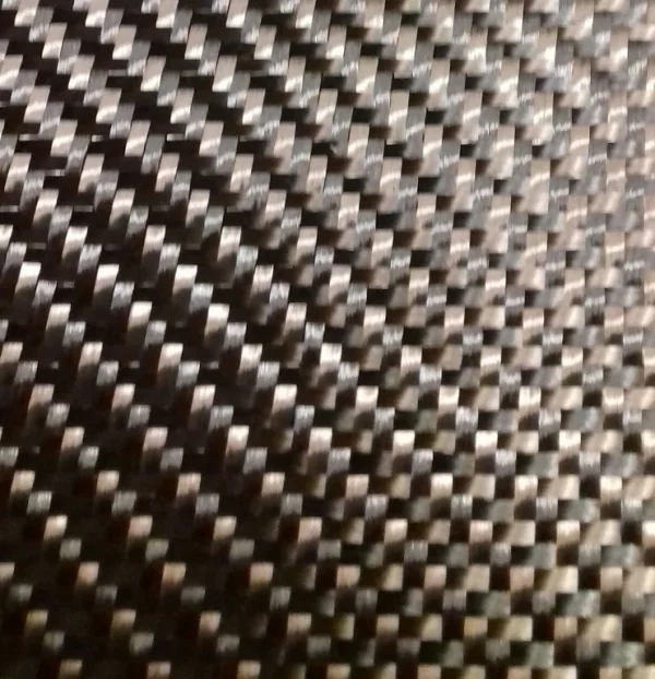

The Pro Carbon material is lovely, specifically made for skinning as it has extra binders in it, I'm trying the fuse box cover in that. The rest I'm trying with carbon/black twaron. Twaron is the generic name for Kevlar, which is a DuPont trademark. Black twaron is dyed, carbon isn't really black, it's brown/grey depending on how your colour vision is. Carbon/black twaron gives loads of contrast. As a decorative fabric it's pretty much Super Carbon. Perfect for the interior.
Trying it in about an hour once the black resin coating gets tacky.

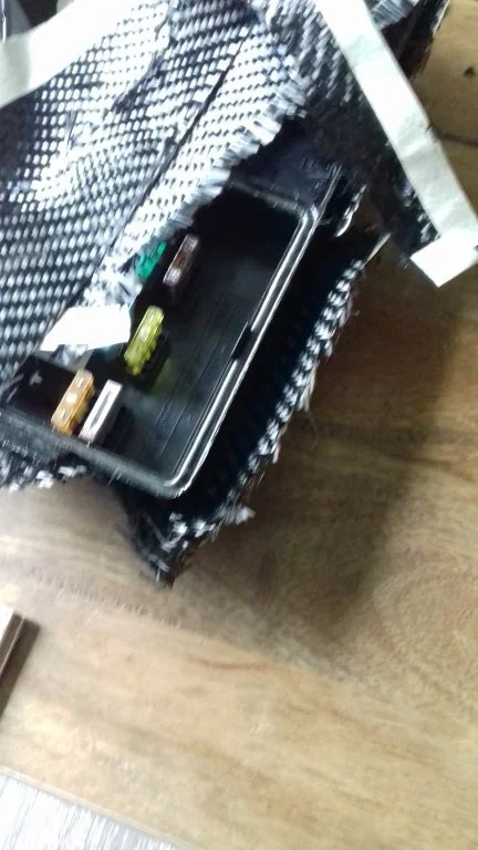

Only one disaster, I cut the fabric for the fuse box cover a little too neat, didn't have enough excess at the edges to fold them over and hold with masking tape. They sprung overnight, stripped it, I'll need to do that again.
Everything else turned out well, now on its second coat of resin. Tomorrow I can properly trim all the edges, do a little flatting, then another 3 coats of resin on Friday. You have to recoat at the tacky stage, about 2 hours.

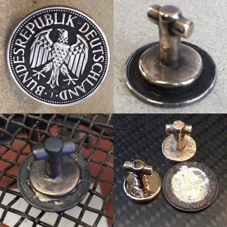

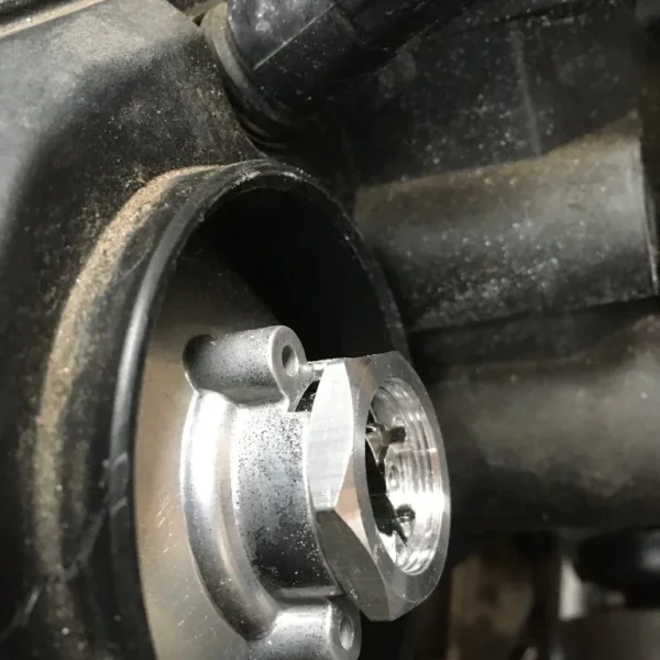

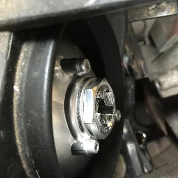

I tried making the retaining clips in chrome and it was a total disaster. Ended up using 1dm coins. That actually worked really well. I just have to drill a small screwdriver slot. That has to wait until I rescue them, dropped them behind my drilling machine and I can't move it at the moment.

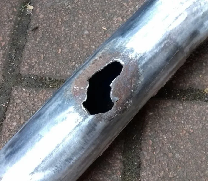

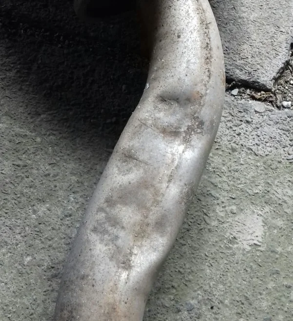

Managed to get the exhaust a nd few other things off in the summer.

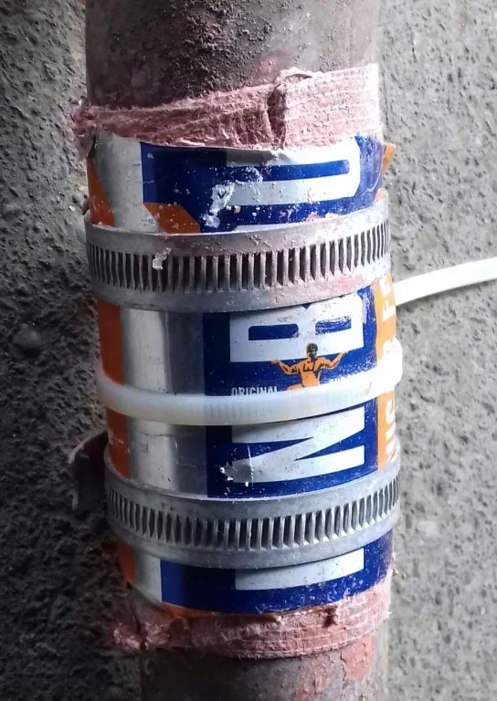

The quick Irn Bru repair worked well.
All zap with a flap disc showed why it was loud!

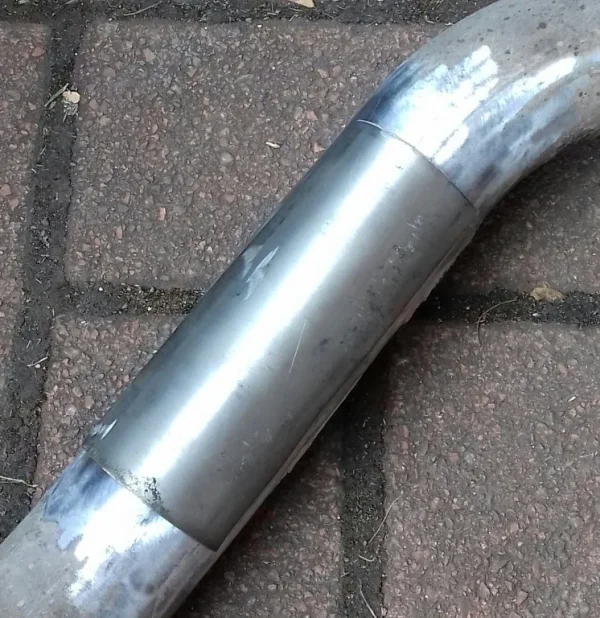

I have a few bits of stainless tube, didn't take long to make a repair patch.
The center support is missing, obviously hanging down, so, rather than just using a bit of baling wire, it was taken off and the crap beaten out of it. I really don't understand some people.

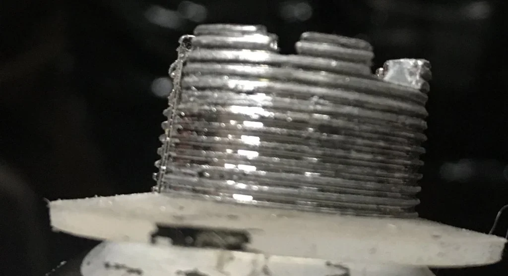

Whilst battering the crap out of the exhaust, chummy also managed to put 3 cracks in the boxes. I elected to just weld them up since the exhaust isn't really in bad condition.
I'll add something to hold the center up later.

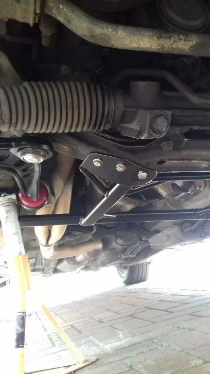

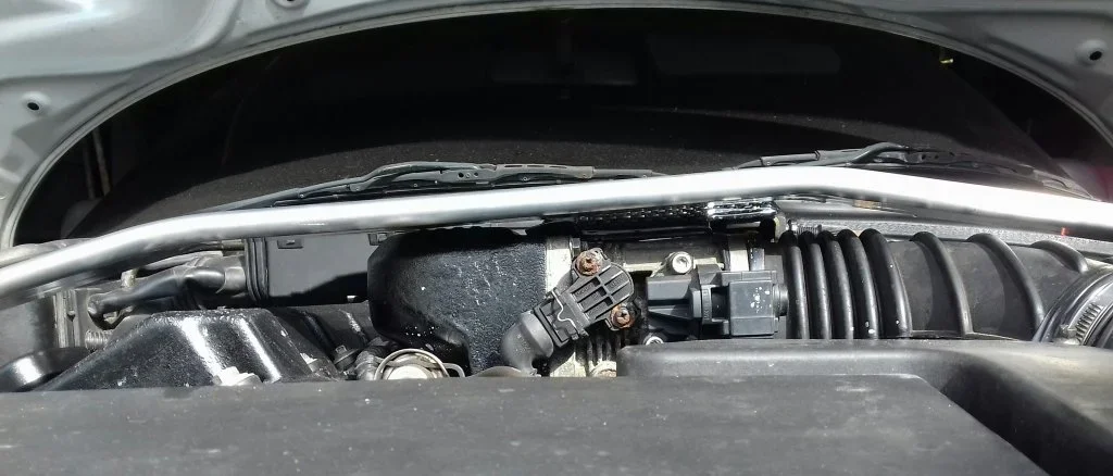

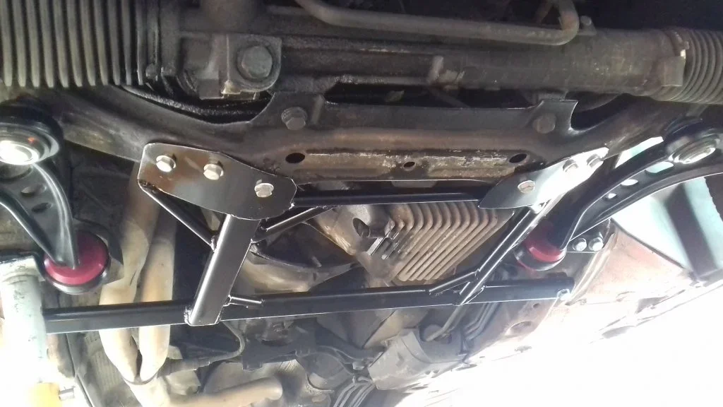

When my son was home after 1st lockdown I made a lower brace for his touring. Really wish I'd made a copy for the Z, much more robust than the standard item.
I'd bought a strut brace from a 6 Cyl just out of curiosity, but it was far too far out, I'll get round to making one eventually.
The X-brace you made looks a fine piece of work Iain:thumbsup:

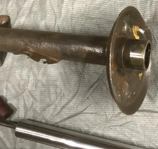

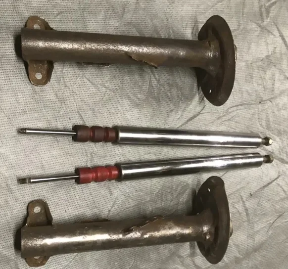

I acquired these before Christmas, e36 Bilstein struts.
40mm inverted monotube inserts. The seller stated one was past it. Not had a minute to have more than a cursory look, but nothing like as bad as the advert stated.
One pipe bracket needs remade, dead easy, and one of the platforms needs repair. Again, dead easy. The bushes seem ok, though the seals are shot.
Undecided whether to keep the platforms or, cut them off and weld on adjustable platforms.

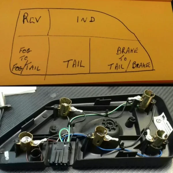

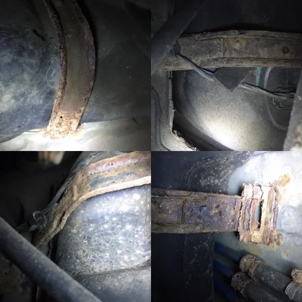

The tank straps aren’t spectacular, but useable. I’d like to drop the full rear when it’s mot’d and I get it back up here, if I do I’ll make new ones and a new mount.
I followed a couple of Z3’s the last 2 winters, not a fan of the pissy wee lights in the deep dark and rain. I drive a lot in the deep dark and I’m not impressed with the twonks on the A9 who now think overtaking at the very last second is a wizard wheeze. Don’t get me started on the clowns who don’t even bother to change lanes. Had a good think and decided to do the same as we did to the back of my sons Touring, repurpose/rewire the rear lights. Easier on a Z3 as its wires and holders, not a board.
The fog becomes tail/fog and the brake becomes stop/tail giving 3 tail lights. I’d rather have 2 brake lights but Construction and Use regs demand 10cm distance between a fog and brake light. Can’t achieve that in the standard housing. If I can eventually find a small and neat enough led strip, the fog will be relocated above the number plate.D89DD535-86C5-44FC-ACDA-4FFE448DA0DC.jpeg53C91ADE-31CB-454A-A81C-E613AF078E01.jpegF1D1D310-0801-46C9-A40B-FBD81E1178FD.jpegADF17D37-7904-44F1-B53D-B57CA8160B11.jpeg

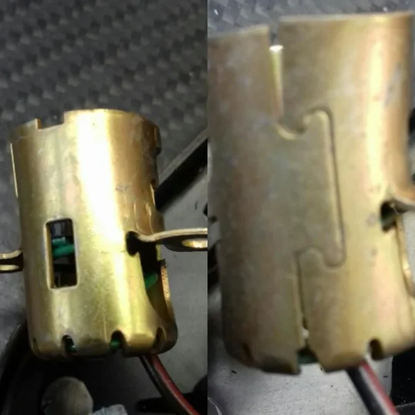

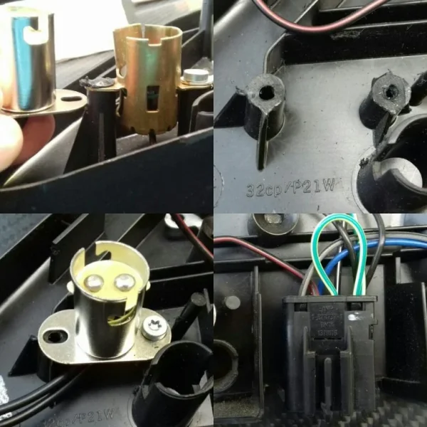

Just waiting on new rivets. Oh, and some new screws. I did think of recutting the holders rather than replacing them, but it would be quite time consuming and I’d need to remove them to do that properly anyway.
I doubt very much that anyone would pick up on the fact there should be 10cm between Rear Fog light and stop light. How did you come by that piece of info? So long as lights illuminated when switched on and tell-tale lights worked I would bet it would pass an MOT test.

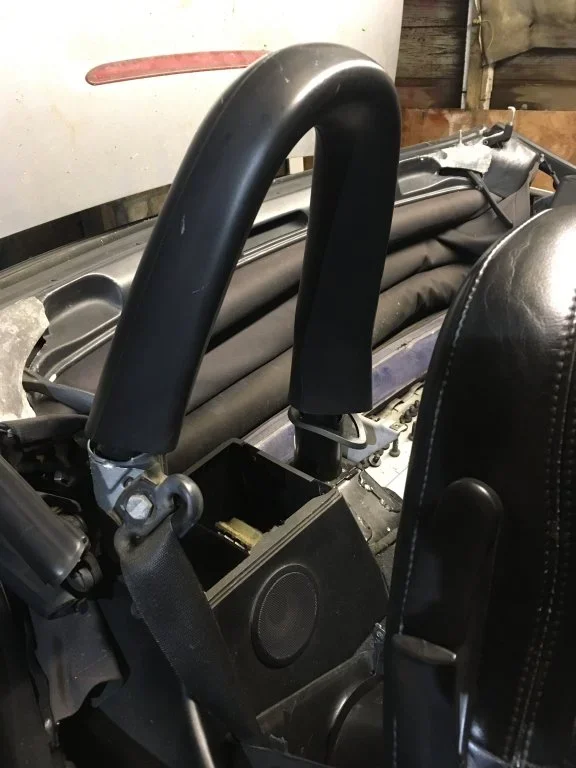

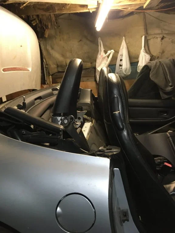

I wanted to do a few track days, that didn’t happen at all last year, we’ll see what happens this year. I’m also planning a Sprint or Hillclimb. So, Rollbar (or rop, roll over protection). I couldn’t come up with a design that would meet MUK rops regulations, yet clear the seatbelt mount and still allow the hood to fold properly. Rops isn’t mandatory on road cars, rollovers aren’t common, but not unknown, I’ve come close before. I’ll come up with a design eventually.

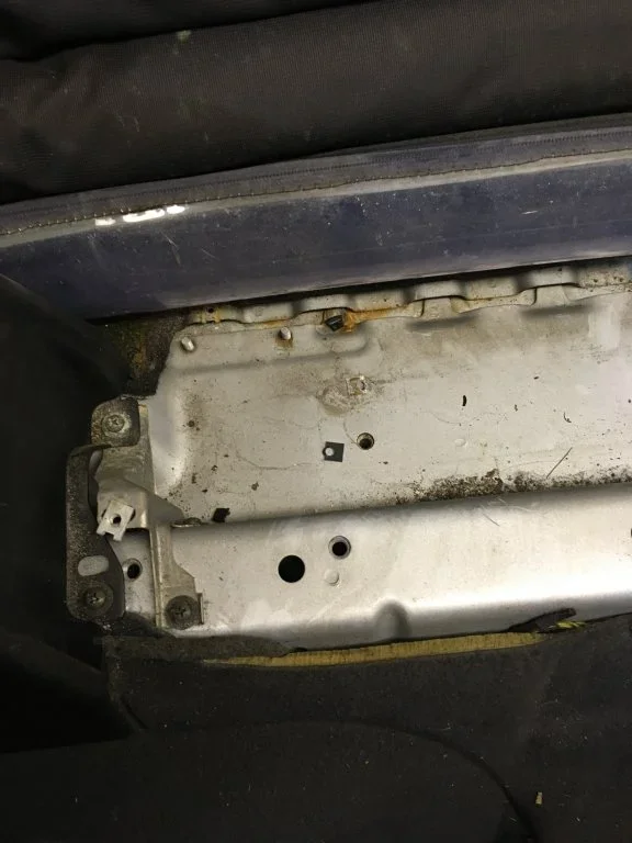

Which leaves the standard sissy bar things. Better than nothing. Maybe. I mean they come with a built in fold point for goodness sake.
I couldn’t believe what they were going for on eBay. £300 min for all the bits. Feck that. I got a pair with brackets from the States, £77, £146 all in with Global Carriage and tax.
The plastics in this car aren’t for bars. Good thing I have a decent saw and plenty of epoxy.

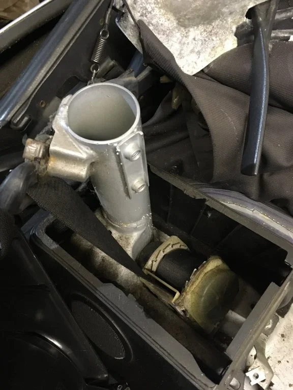

252E1E97-C14C-4B7A-8613-3754AC7A4538.jpeg4B3888F3-6D3D-4692-BC9C-7BA5420FD86F.jpegE14E6265-3BC0-4386-A8E0-9EEE44AF7705.jpeg48F79D0E-04FE-4DD0-B5D6-CD6911D56B00.jpegAF41D970-9BBE-4DBA-AD10-1DBDAD74A4CC.jpeg6A3EFD3A-102C-4799-A51F-FCD012A40044.jpeg
With a lid on there’s really not going to be a great deal of clearance, I may have to go to a race seat. Five layers of clothing don’t help, -2C when that pic was taken. I plan on losing another 7kg off me. I need to figure out where to fit harness mounts.
And the roof isn’t low, the car is as high as the jack stands go.

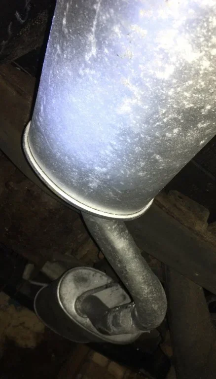

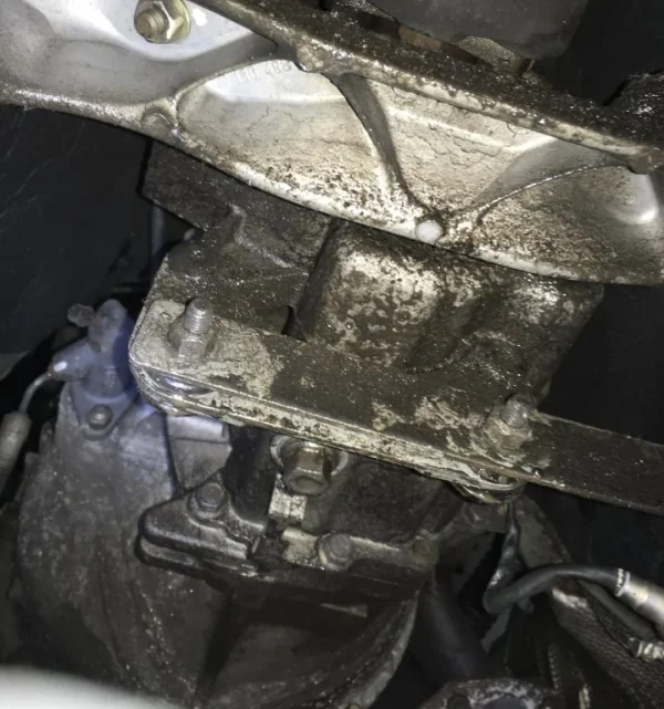

Got the exhaust back on, I can’t push the center up, I think the whole thing is bent. It didn’t ground on anything last year so should be fine for the moment. If I can get some 45mm stainless tube I may run twin pipes instead of one standard one. I only have the one die for my tube bender, will see what I can find.
if you’re wondering why I’m making a distinction between tube and pipe, tube is sized on its o.d., pipe on its internal diameter. You can’t bend pipe with a tube bender, you can bend tube with a pipe bender but it mostly kinks and flattens.
Spotted I have a gearbox leak. It’s only slight, fine for now. Perfect excuse for a 6 speed conversion in the future. The clutch was shuddering badly when I moved the car from the open garage under cover. Luckily my father in laws drive is long, booting it and dumping the clutch cleaned it a little, still shudders but should be drivable. A lightweight flywheel should complement the 6 speed. Both will wait until I track down all the parts.

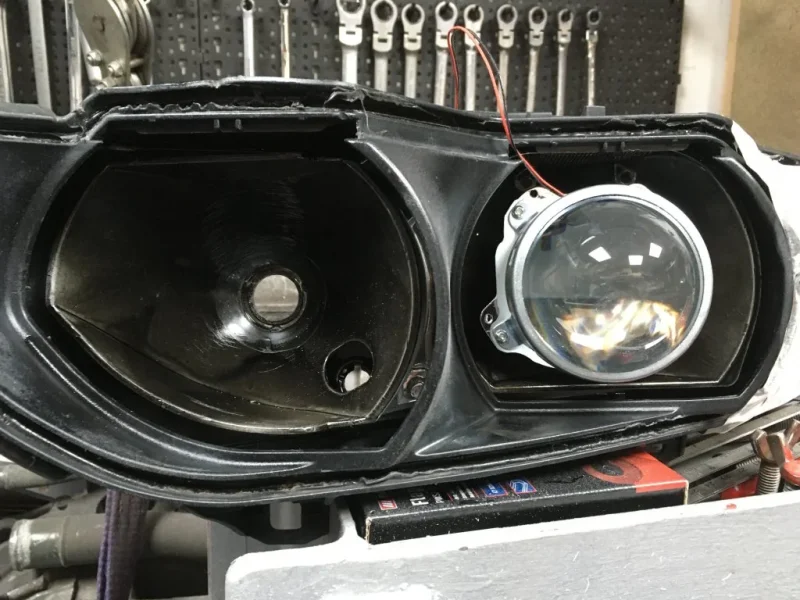

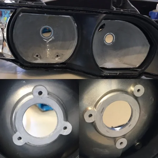

Removed the headlights, I have some projectors to fit in them and they need polished anyway, easier to do that off the car.

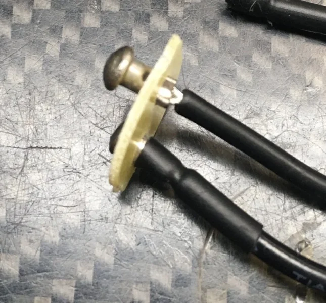

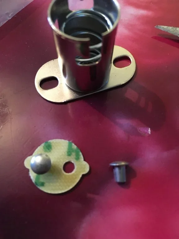

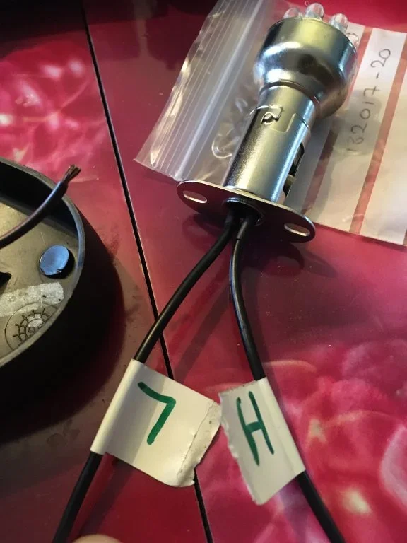

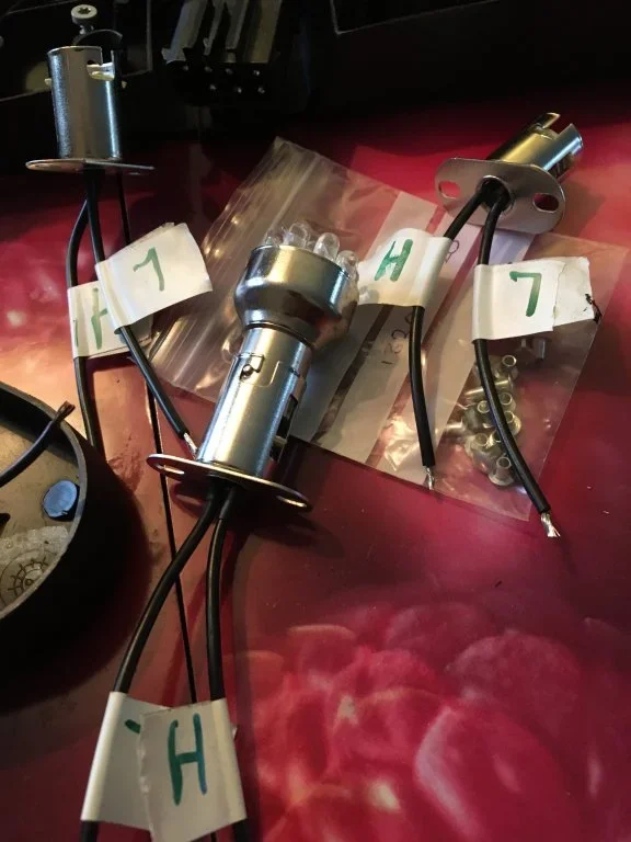

The rivets I need for the bulb holders arrived. I could have just joined wires but it’s messy. Checked and marked each bulb holder . . Because I’m a Knob . . I mix things up. Tried soldering the old wires into the rivets but the wires don’t clean enough to tin, even with several chemical cleans. So, crimped them.
Now thinking of replacing the terminal supplying the taillight. I have spares somewhere. Then I can solder that properly.

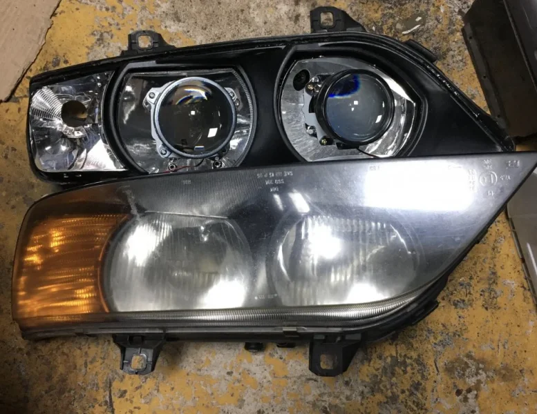

Attacked the headlights, have one cover off to be repolished, I’ll do the other tomorrow night. Bought a 2 1/2” bi-halogen kit just after buying the car, didn’t have time to fit that before it went to my son, they’ll go in the main beam. A 3” bi-halogen kit will go in the dipped headlight position. The holders need trimmed to allow a nice tight fit, which will be Loctited and epoxied to death, I don’t want anything vibrating or loosening. I really should have taken the back off the light too, that’s how you get the glass out. I just snapped it, with modified holders it couldn’t be reinstated anyway. I’ll use the glass as patterns to make carbon trim pieces.

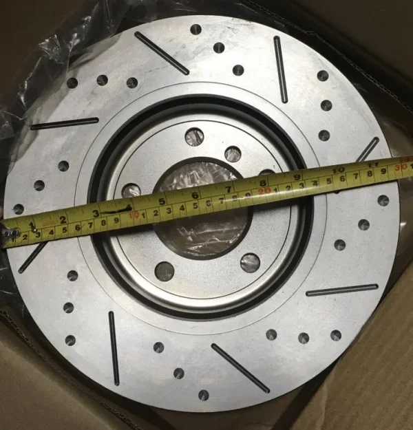

These arrived today, 300mm diameter of vented, dimpled, grooved, stoppy goodness. Just have to get the correct brackets.

Spent ages with the newly wired rear lights chasing a fault only to find it was the brand new, straight out of the box bulb, both filaments intact, but dead on both circuits. Never come across that before.

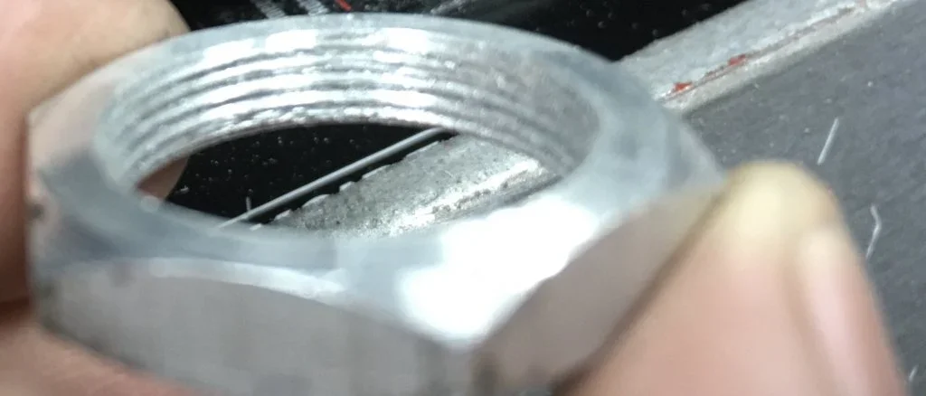

Tried to take them apart to route the wiring, uh oh, don't come apart. Much cursing later I had main beam out, the alloy nut had distorted when tightened. Totally pan bread. Tore the housing to bits too. Measured and ordered new steel half nuts. Which don't fit. It's some 'not quite' size. Arrrgh.
Not quite sure what I'll need to do now, somehow make that wrecked nut work I think. Started on the mould for the indicator lense, but at this stage I may be buying another headlamp and put this on the back burner, yet again, until I get an Mot.

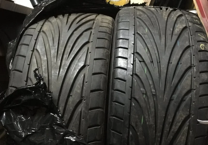

Spotted a couple of 245 tyres on ebay cheap. Checked my wheel stack, yep, two 8" wheels, tyres arrived and went to fit them. Ohh, ohh feck, these are 8" wheels for an Audi, same fitment as my Pontiac. Shouldn't have been in the BMW stack. Ooops. . Oh well, I now have 2 tyres for the Fiero Project. Admittedly, that one, is not the Bimmers fault!

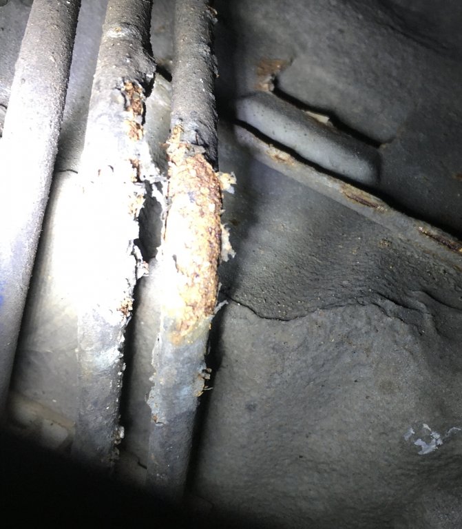

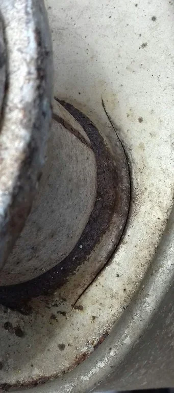

Seat out, the area below is full of water, so passenger seat now needs to come out to get the carpet out. It has no motor, a broken seat gearbox and, I simply can't remember how I operated it the last time. Arrrgh part 2.

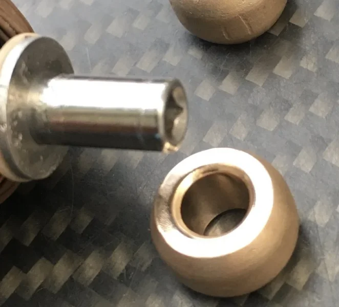

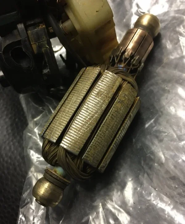

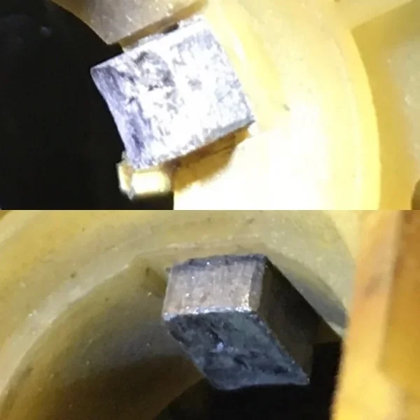

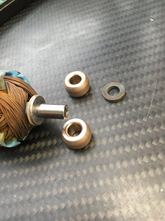

Taking the motor apart, it's obvious why it doesn't work, the brass bushes are completely seized to the spindle, the weird feeling was them rotating in the plastic housing.
One of the brushes is breaking up and was jammed in the housing. The other is not much better.
I should just buy a S/H motor, but I tapped at the bushes with a plastic, then brass hammer, got them to move, eventually twisted them off with pliers. At this point, if I can make the thing work at all in the short term, it will be a result.. I really need a passenger seat base, there are 3 breaking in and around Glasgow, I'm off a few days next week, need to have a phone, see what I can acquire.
Alumina blasted the spindle, bead blasted it and the bushes, then polished both with soft rubbers for gold.
Now spins beautifully. The little dents and the tool marks on the outside of the bushes are of no consequence, they go in the housing. Can't get the correct size brushes so ended up buying a couple slightly bigger, I;ll sand then to the correct size.

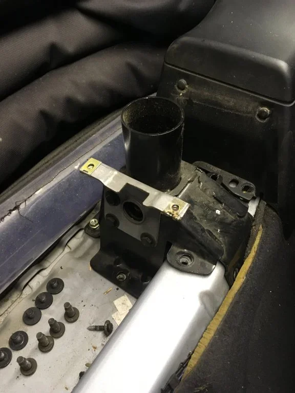

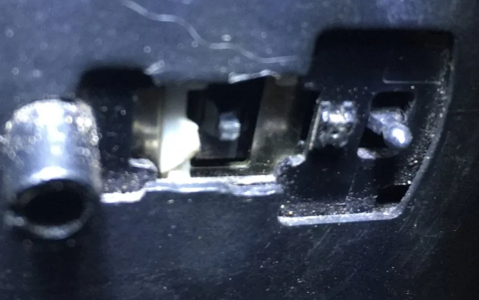

With the seat outI spotted the tip is broken off one of the switches.
I think rocker switches are in its future.
To top it all, I can force the recline mechanism. That in itself is an Mot fail. And dangerous. Bugger. One more thing to fix.
