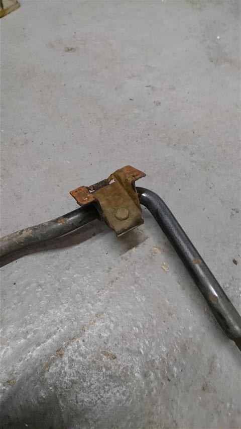

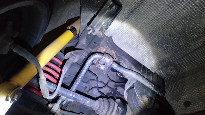

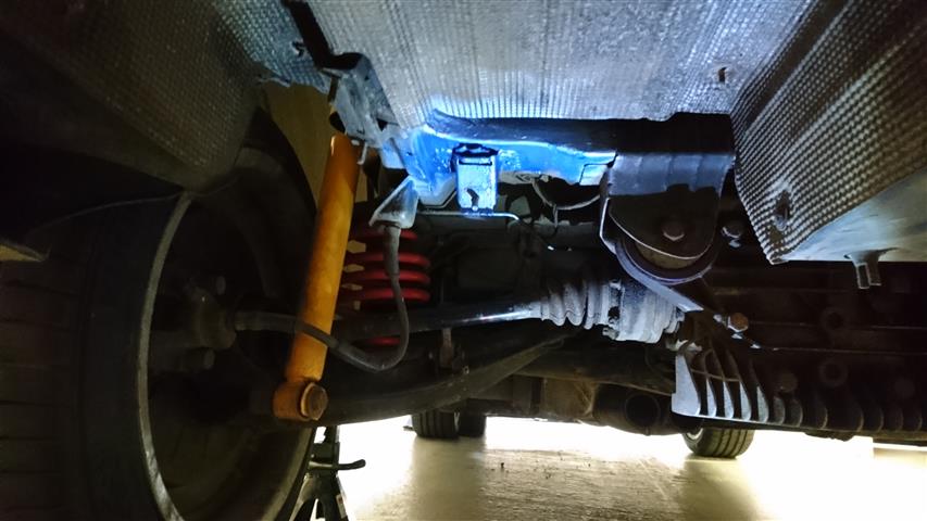

I had a shocker a month ago where I had a bump and suddenly there was an awful knocking noise coming from the rear. When I got home, I jacked up the car to find the near side anti roll bar bracket had sheared off. I took the ARB off, and the bracket came off with it.
It looks like they are only spot welded on, so with 19 years of corrosion and the stiffer H&R ARB it’s not surprising. Anyway, I cleaned it all up and welded it back on. I also cleaned up the other side and welded that up as inevitably that will fail as well. Whilst doing this I replaced all the exhaust rubbers as they’ve needed to be done for quite some time. However, with the new, stiffer rubber the near side exhaust started to rattle on the ARB. I’ve spaced the exhaust down by 5mm and now there’s enough clearance.
