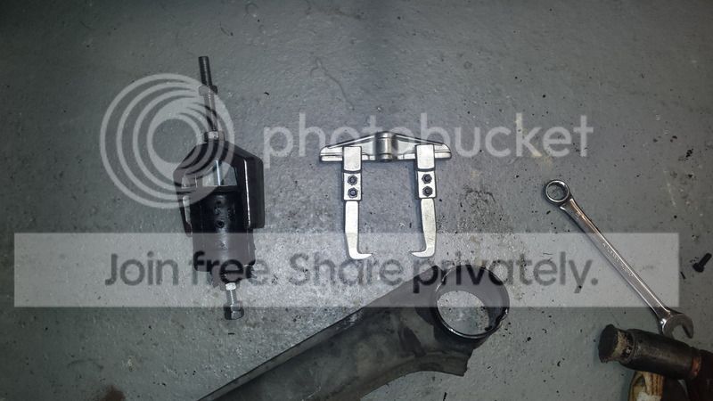

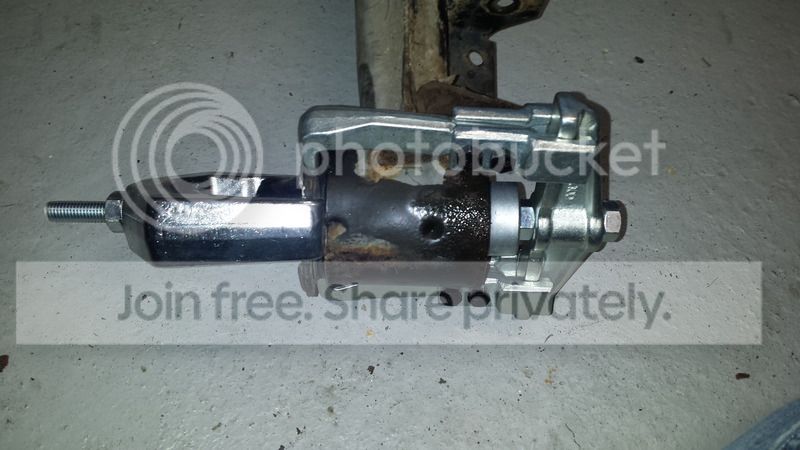

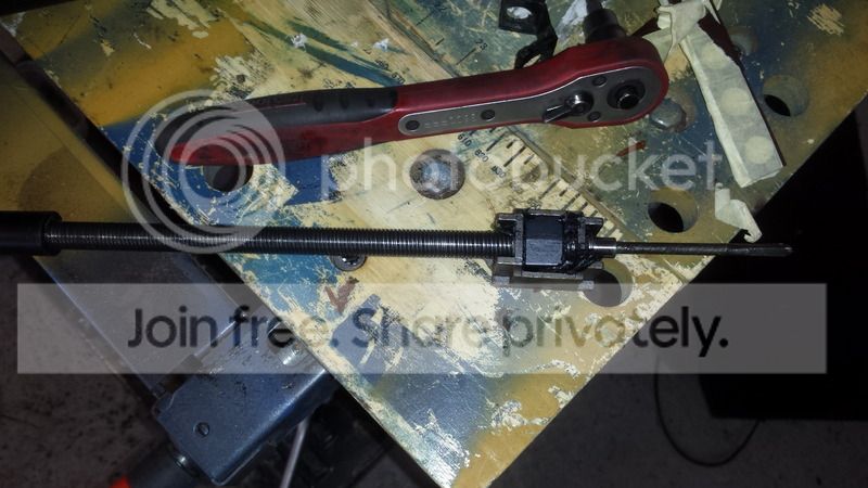

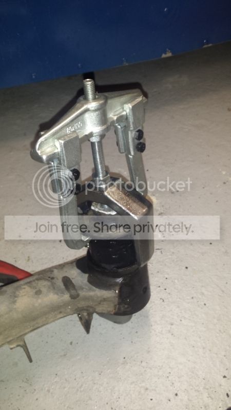

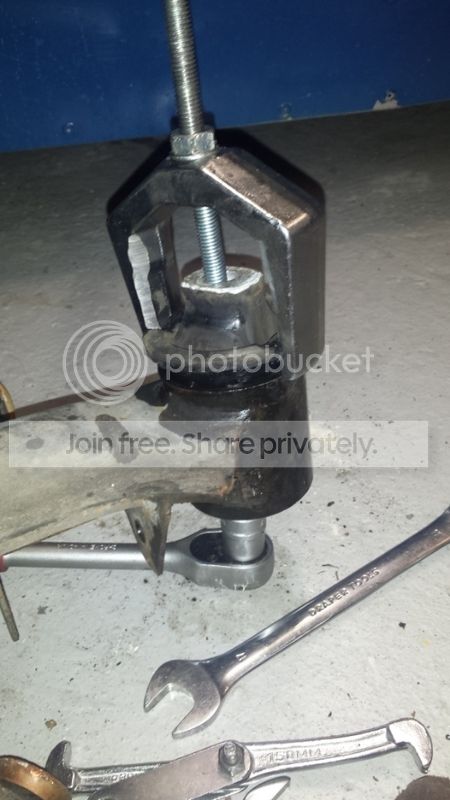

Had some massive progress this evening. The beam bushes are now out. It certainly wasn't easy though. I did some research on the intorwebz and found someone had modified a pitman arm puller and combined it with a gear puller to get the bushes out. I thought I'd try something similar.
One of the problems when trying to get the bushes out, is that if you just try and pull them from the far side there's large amount of movement in the bush and it doesn't really come out. I tried using the method I found online but unfortunately the gear puller kept on pinging off. Instead I tried pulling from one side and pushing from the other.
The pitman puller is on the left, a piece of threaded bar passing all the way through, pulling on the bush against a socket, then with the gear puller pushing on the steel lip of the bush.
This kind of worked, but actually it was the pulling which was doing most of the work. I replaced the socket with an offcut I had which filled the inner diameter of the bush housing. Lots of WD40 was added and then it start to come out:
I then put the gear puller back on to help pull it out. This final configuration worked a treat!
This was what I used:

Yeah, burning them out was going to be the last resort but I once I'd got the method sorted on one, it only took about 10 minutes to get the other out.....and no smoke, mess, or horrible cleaning up to be done.

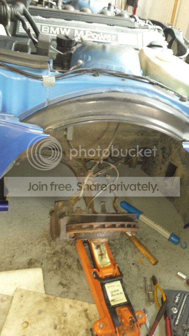

I've been super busy over the last few days as I have 'enforced summer holidays' with my job meaning two weeks off in the summer! Anyway, there's loads of photos as I wanted to track everything I did.

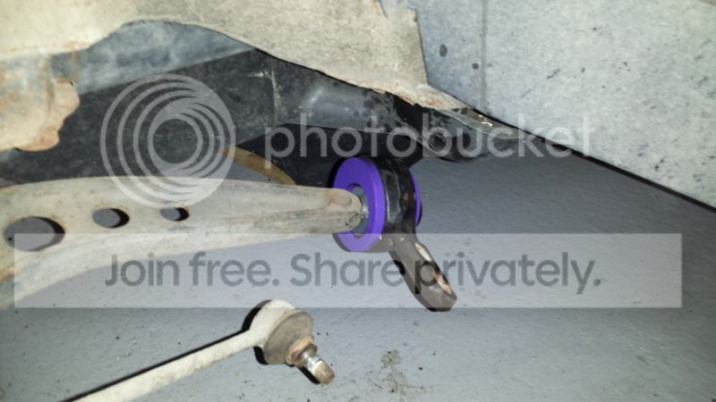

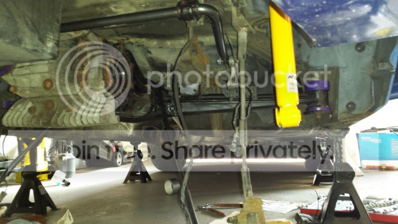

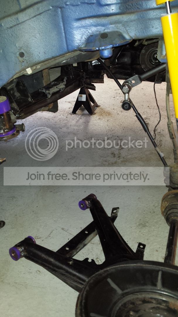

Rear beam back in with the diff - I decided to put it back together in pieces as the whole assembled subframe is way to heavy to do by myself! I'd also fitted the new rear ARB, shocks and poly bushes.
I was worried about putting the handbrake shoes back on as I'd not paid much attention taking them off. However, it was very easy, and with new cables.
And the other side......I decided to wire brush everything an paint it to prevent further rust.

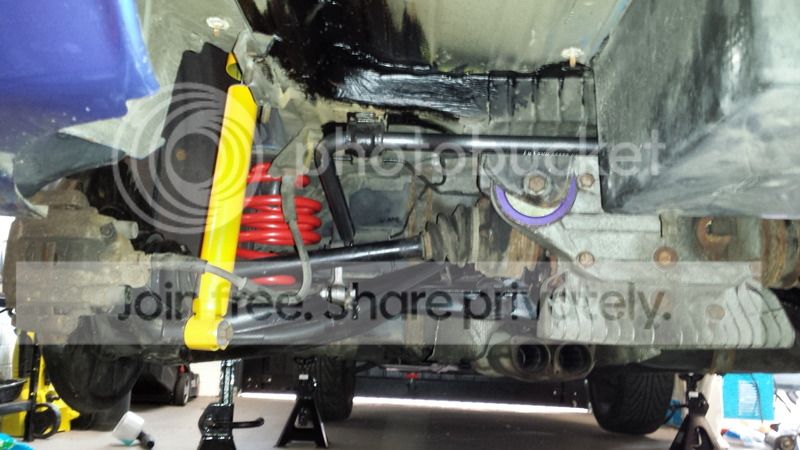

A pic of it all in before fitting the exhausts and heat shields

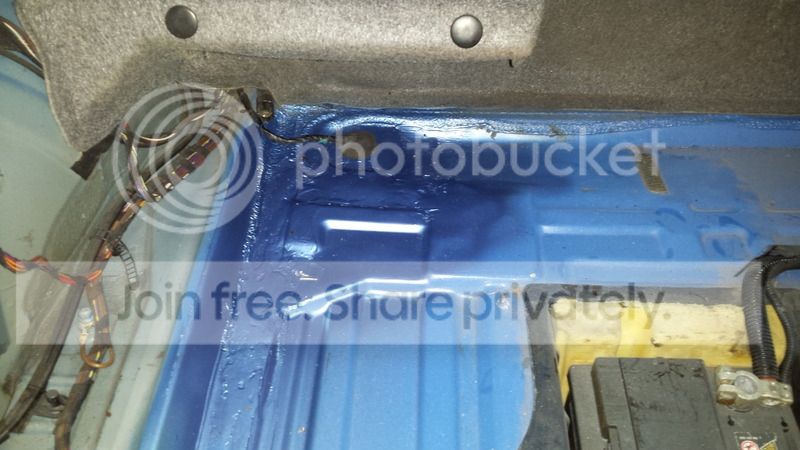

The boot floor fix was reasonably successful....my welder started packing up half way through though :-(
Progress! Back end basically complete, time to move to the front.

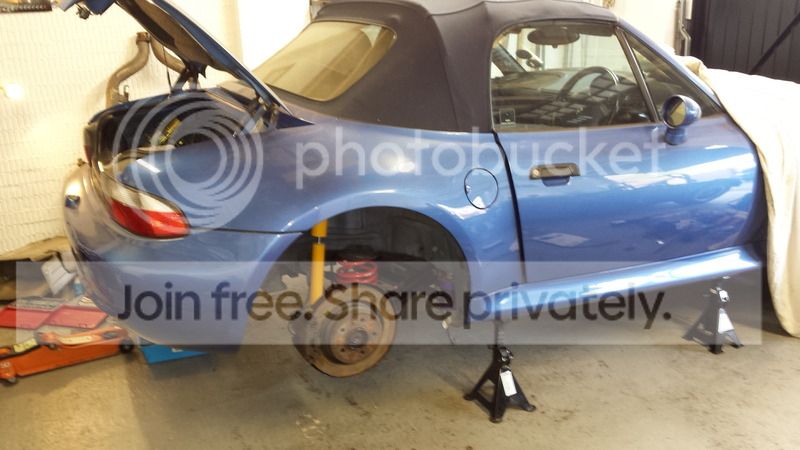

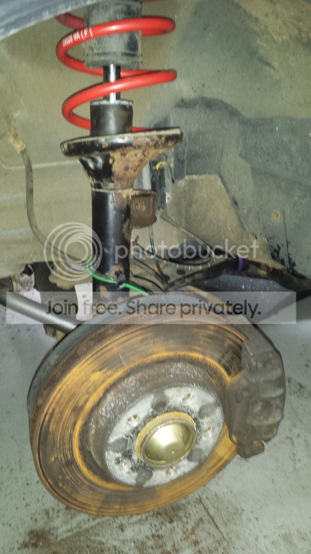

Front shocks out, and front bushes - the front bushes were really easy to remove with a load of WD40 and the 2 arm gear puller. No need to burn anything!
Front polybush in

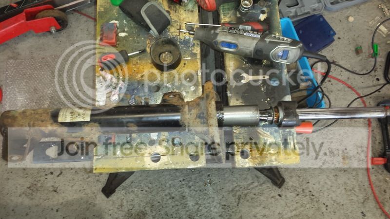

I cut the top of the strut off to allow the fitting of the new insert

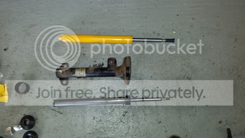

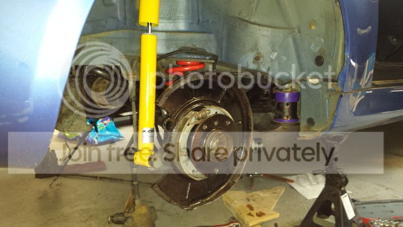

Old damper and new KONI \adjustable damper
And fitted with the new springs. I probably should have painted the struts.....that's a job for next time, I really couldn't be bothered after doing all the rear subframe.

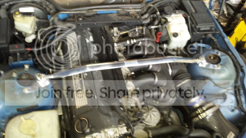

Weichers strut brace - sorry about the crap quality picture
My seat had some play in it and I was horrified to find that on this side there wasn't even a bush, just a load of silicone sealant...all sorted now
and finally all done!
I really like the subtle drop, makes my S3 look HUGE!!
I took it in for it's MOT, but it failed on an airbag light and emissions. I've booked it in for next wednesday to get these sorted. I can't wait to take it for a proper spin. Just driving it to the garage felt awesome, all the upgrades have made a massive difference. I need to bed everything in, check everything is all still tight, then I can take it for a proper drive!
