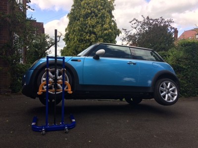

My comment about being good for working on the corners/suspension of the car was aimed at mini lifts not tilters.
you need to re-read your post, that's why I gave the reaction I did.
Hasn't someone on here got a tilting ramp?? @gookah ??
The trouble is these things really restrict access to the underside. They are more for working on the wheels/suspension at a comfortable level from what I can tell.

The access comment was directed more at the mini lifts.
But I stand by my assertion that a tilter does not give the type of access you need to remove a gearbox and exhaust easily. I wouldn’t think it’s easy to manoeuvre an awkward lump like a gearbox or exhaust with the car pointing skyward. And if it’s in the level position the working height is not that great.
And since it doesn’t give unhindered access end to end, side to side then it’s not ideal for underside treatment either.
But I accept it can do more than put the car at a more comfortable height to do corner work. That comment was aimed at the mini lifters.
