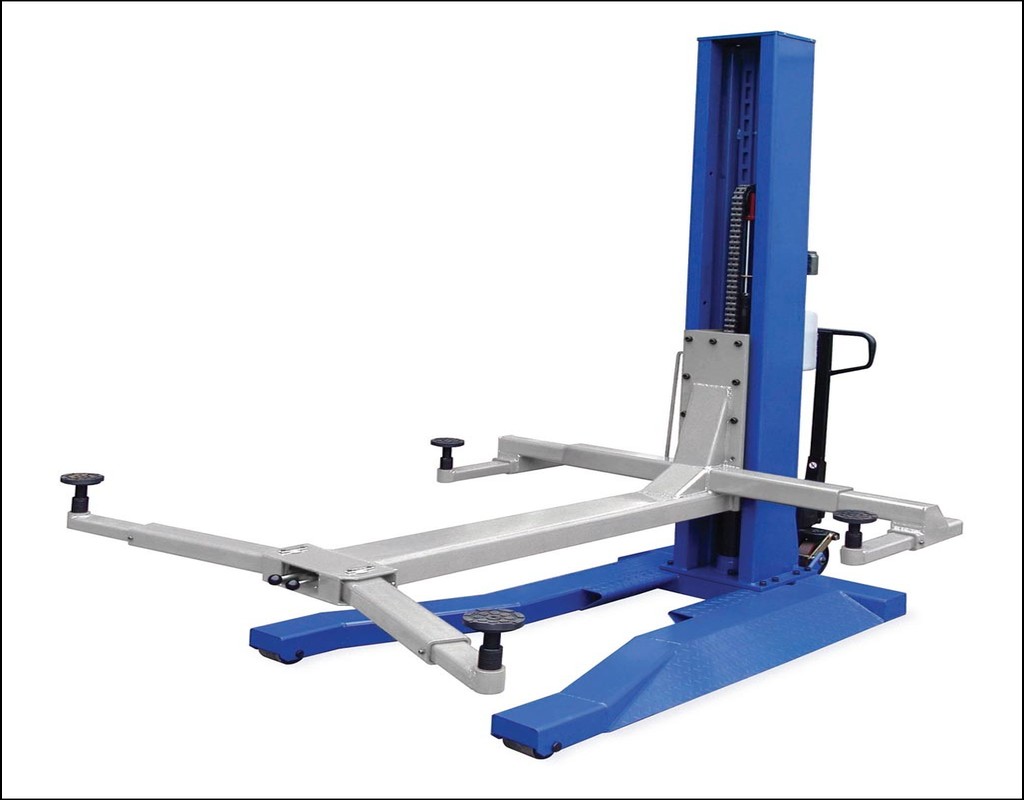

The trouble is these things really restrict access to the underside. They are more for working on the wheels/suspension at a comfortable level from what I can tell.Hasn't someone on here got a tilting ramp?? @gookah ??
The only way to get good access to the underside with the wheels off, apart from axle stands and as far as I can see is a 2/4 post lift.
One of those bonkers side lifts will work too but the wheels have to stay on. Or a ramp system like a see-saw at car dealerships or a low rise system like the MR1. But again wheels have to stay on.
I’ve been looking again at lifts the last 2 days. And my conclusion is 6 ton axle stands and a high lift trolley jack are as good as anything without buying a 2/4 poster. A 2/4 poster is financially viable for around £1,000 either new lightweight or secondhand heavy duty. But they are very heavy to transport and require permanent installation bolted to 5” + of solid concrete. Which is not your average garage floor.
