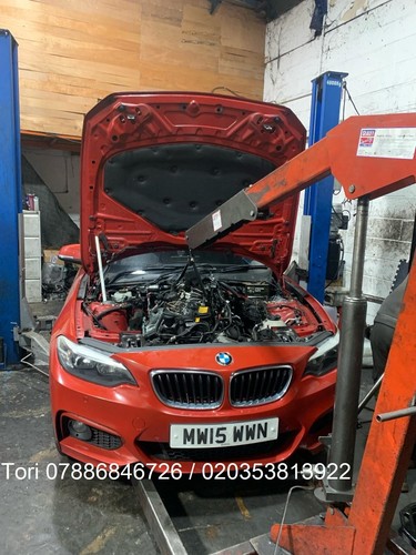

Food for thought Shelly.
The advert does ask for you to contact them before buying.
It’s a reconditioned engine, description in the advert
That’s just seems too good to be true..who skim heads and regrinds cranks and fits it for less than £2k?
