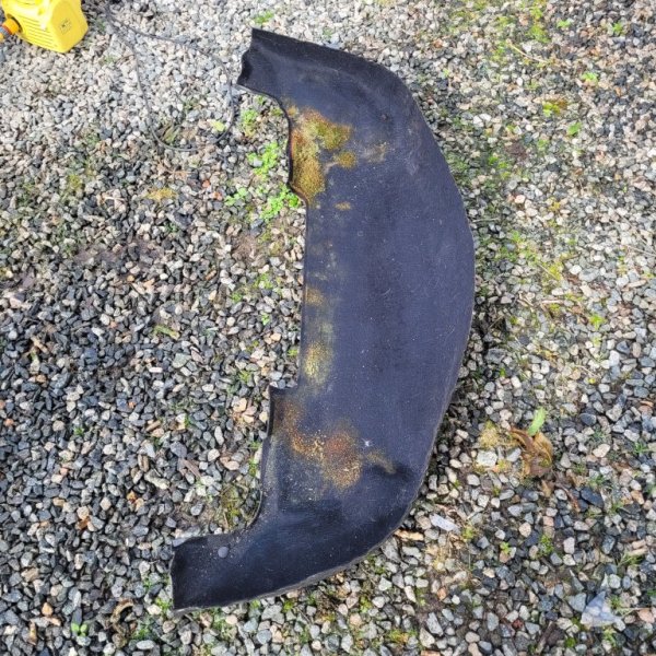

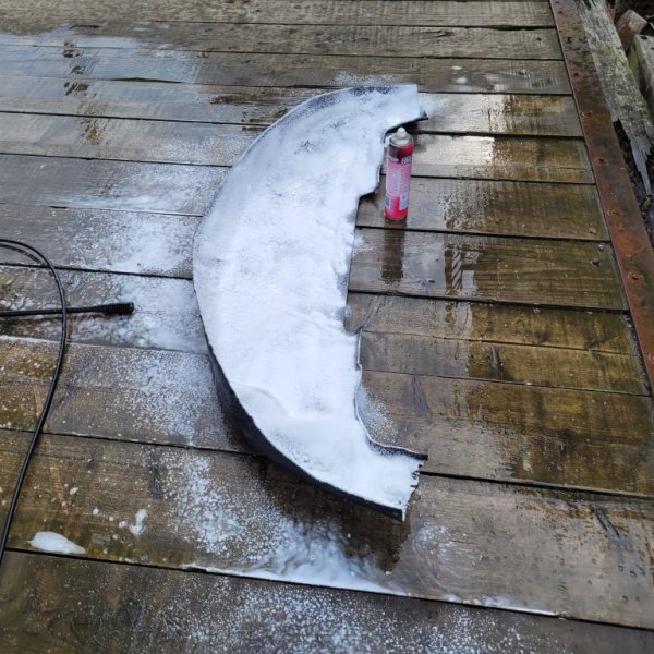

I've started to clean the interior up a bit. There was a pool of water on the drivers floor pan under the seat. I've pulled the carpet and shampooed it up. I'll need to get the smoke machine out as the roof looks good, I am suspecting a window seal maybe. I also removed the rear parcel shelf carpet as it came with a garden.
