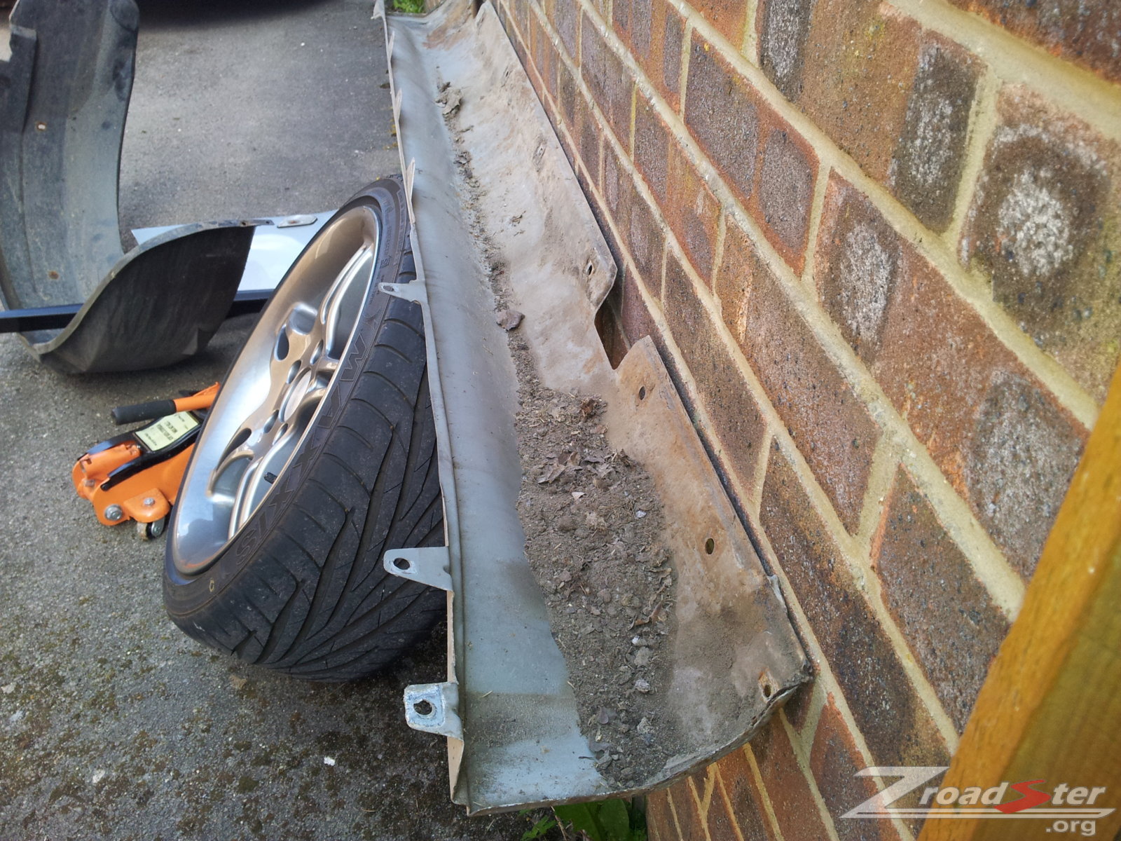

Oh, just found this picture as well showing how much crud gets behind the door sills. Something I think a lot of people don't realise...
Mine were a lot worse than that, they were completely clogged with mud, hence the excessive rust in the chassis. It's strange, the rest of my chassis looks okay, my Zed must have lifed on a farm at some point!

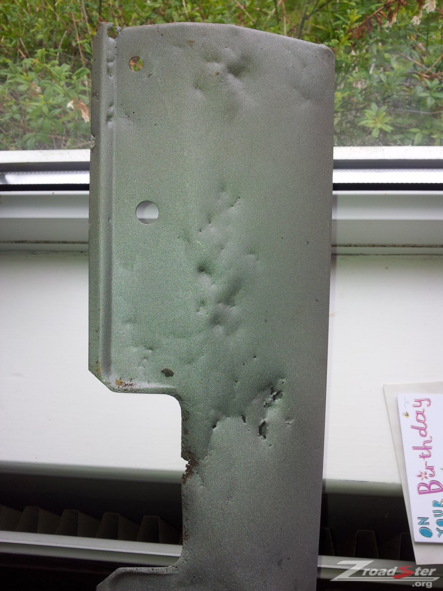

We have commenced the chassis work, we started on the worst which is the front left jacking point and its ready for welding in Brians replacement piece tomorrow which has been shaped and fits snug. also ground a little bit off the other corners to explore the extent of the rust... first thoughts are , it is not as bad as first though, im thinking that we are not going to have to replace all the jacking points, but we shall see tomorrow if thats necessary. its probable that we will only replace little bits on the corners that arn't too bad...
anyway. Brians replacement chassis parts are thicker than mine! very strange, the metal is definitely a different gauge. @Brian H if you could chime in as to why this is or let me know what model the z is that we used as a donor it would be good to know why its thicker than mine?
I believe this is why my jacking points are particularly bad. when the car has been jacked up using the points it has bent the thinner metal increasing the amount of rust... obviously this is just a contributing factor. but i would deffo like to know which models have thicker and which have thinner chassis's. if anybody could shed some light it would be grate!!

IIRC Pete, I think Brian's donor car was a 3.0? Sound like good progress mate.:)
Brian H
205
Killin
E36/7 3.0i - E85 Z4///M
As Tony say it was a 2001 3.0i that they were taken off, really interesting that they are a different gauge.
