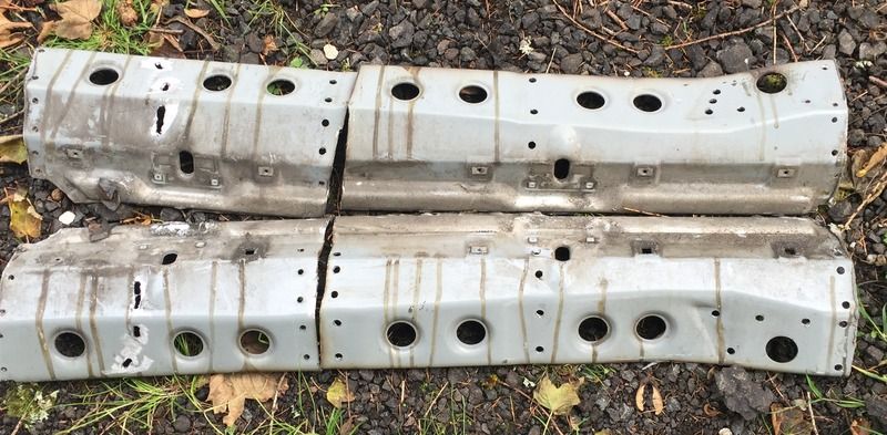

Wow! that is bad - when you took the sills off were the drainage slots clear as that looks as if it has been swimming in water for some time.
This was mine after ~12 years
Completely clogged with dirt, yeah there bad, but till get fixed :)

Don't feel too down though, that bit of welding is a straight forward job for a welder / fabricator. It's great that you can replace the bad bits with bone fide bits from a doner Zed and will be well worth the effort and expense once you are driving her again.
There are plenty of mobile welders who will come to you too.
Best of luck mate
Yeah I have somebody to do the job already, I know plenty of people that can get the job done :)

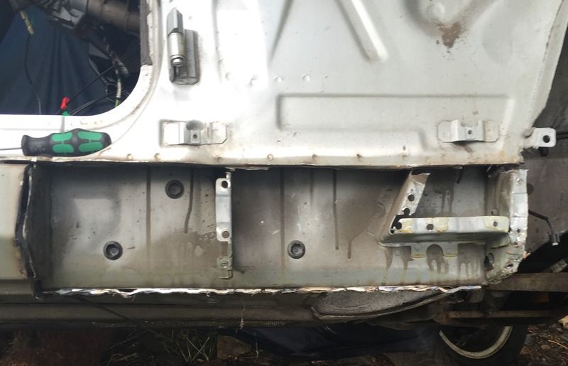

Repair panels cut......what a bas&@rd that was.
I'll get them posted on Monday for you :) @PeteZ3
Cheers, Top Bloke, If you PM me your paypal ill send some cash your way :)
My zed cant wait for them, shes looking very sad at the min!!

Well done @Brian H . Interesting to see what's behind the sill in that last photo. Presume those circular items are rubber bungs accessed from the footwell. I've squirted Waxoyl in through the front one before but didn't know about the others. Thanks - see you finished in time to watch the match ;)
You truly are a gent Brian, drilling out all those spot welds wasn't easy, I know! Good on you mate. If the Blyton track day comes off and you go I will do my best to meet up with you. It's only about 12 miles or so from our house.
Yes the bungs are accessible from the inside of the car, with the carpet pulled back there are a couple more further along too.
