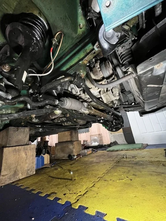

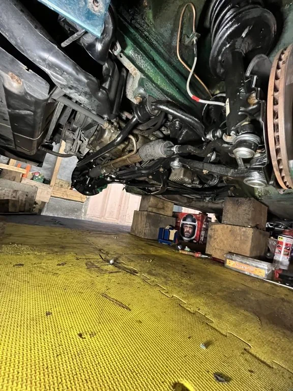

Work has now started on the front end more pictures to follow 👍

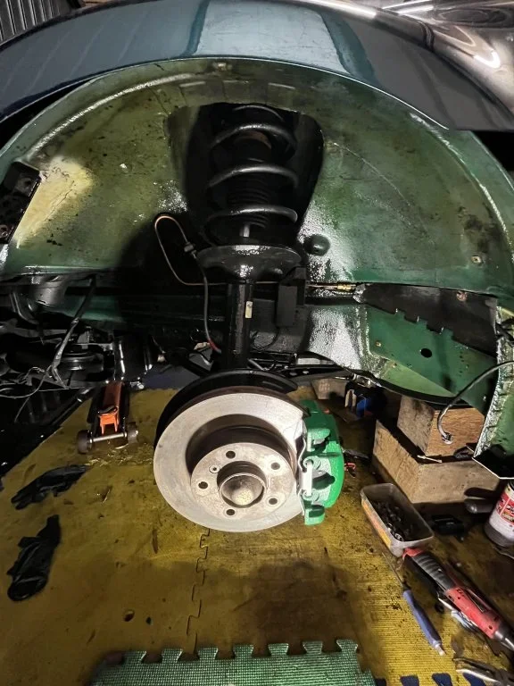

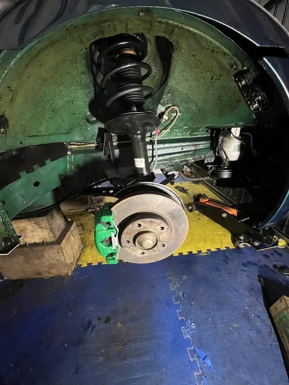

We got the front end stripped now, just waiting for parts to arrive, front brake lines 1st job after a good clean up.
