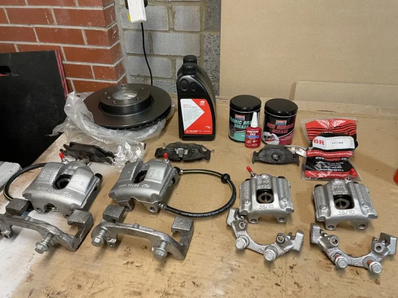

With the suspension done, next on the list is the brakes.

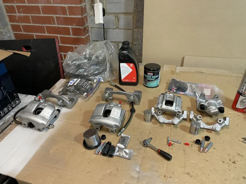

They’ve been working well enough, but definitely due a refresh. The pads to fairly recent, but the discs are looking pretty scruffy, and no doubt the seals, etc are all original. Was just going to start with the fronts, but with 2 weeks off I decided to push the boat out and placed another couple of orders for the gear to do the rears as well.
All 4 calipers now off the car, cleaned up, new pistons and seals fitted. Front discs are Brembro, rears on the way.
Hopefully everything arrives before the weekend, and I can get it all back together next week.

New front discs, hoses and refurb’ed calipers went straight on without a hitch.

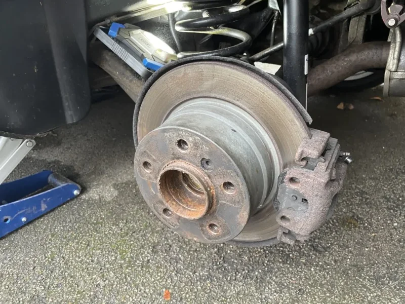

The rears proved a little more bothersome - specifically replacing the flexible hoses between the chassis and the trailing arm. Managed to get the driver‘s side done, but had to cut my brake line spanner down to get it in. Finally managed to crack them open and got everything swapped out.
The passenger side was a non-starter as far as accessing either end of the hose went - I didn’t really want to start stripping stuff down, so that one will have to wait for another day. The nut on the caliper end of the was also seized onto the copper pipe, and I was a bit concerned about damaging the pipe. Did it in reverse, fitted the hose to the solid pipe, then threaded the caliper onto the hose - luckily everything lined up without any kinks.
Next up a full bleed of the fluid. Used my new Sealey pressurised bleed kit, which was such a breeze I went round the car twice and pumped a full litre of fresh fluid through the system.

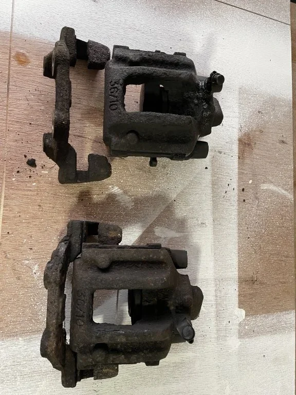

They are never the same calipers!? How on earth did you clean them up so well?
At the moment I am still at the 'fix what needs fixing for an MOT pass' stage with mine, but once it's through I did want to service, clean up and paint the calipers. I was actually thinking I'd end up buying new ones, but if you can share your secret, you just inspired me to have a go at a full refurb!
