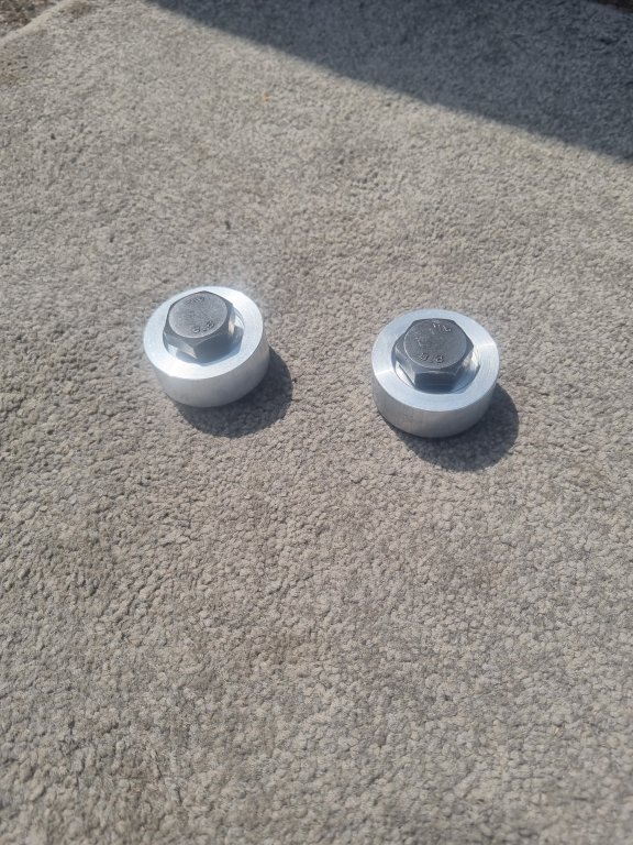

A previous modification had been made to the drivers seat but I've just fitted the seat lift brackets I purchased from @Southernboy the other month.
Very impressed with the quality and the associated result. I'm 6ft1in and find these prevent me needing to have the seat back pressing on where the rear speaker is mounted (not the bulkhead but what do you call that?) , they also make for a comfier driving position and make entry and exist much easier.
Must admit I also much prefer the Z3 standard seats to the Z3 sport seats. My previous 2 Z3’s had the sport seats but the standard ones don't seem to cause me as much back ache. Still I suspect size and weight has a big part to play in that conclusion ;)
