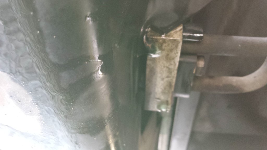

so gentlemen,
this is where the leak is finding its way to..its dripping from that point pictured,
at temp, steam is coming from around the expansion tank area and what looks like the maybe even the cap itself..either way its not a hose, I think its a blown rad and maybe a crack in the expansion tank that I can't see..an there is a steady drip of coolant coming from under the front of the car.
on the plus side the oil is not milky or frothy and there does not appear to be any steam coming from the exhaust.
however the idle is rougher than usual and on an M44 that is saying something.
so what are your thoughts on my diagnosis?
any other possibilities?
I will do a bubble test in the morning when the car has sat overnight.
cheers
J

Hi Joey,
I think that price is reasonable, I have looked at the other jobs you have done and they all seem normal Z problems, I think your issue has been cost of parts, I have done nearly all the same jobs, and not spent anywhere near £1000.
Like Jonco said these cars are between 10 and 18 years old, I was aware of this when I bought mine, and although there were better examples body wise, they were all tired in the same places and needed some work.
I think if you want a plug and play car then a Z3 is not for you, and I don't think a 2 - 3 k roadster of any type would be, you ideally want a 10k car, but the problem with these is they are more modern and more expensive to repair.
I would say stick with it on the cooling front it sounds like the rad and/or expansion bottle. With regards to the lumpy idle, it is an M44 trait, and worse running can be a sensor , vacuum, or injector seal problem. All these can be fixed in total for around £150.
After that there is not much else to go wrong.
Sorry to be blunt, but this is the cost of ownership, the good side is you won't have to do it for another 16 years.

update....
its been an enjoyable day working on the car but not with the outcome I would have liked!..
plus as the car is an auto there were some unexpected surprises,like having to disconnect the transmission hoses to remove the rad from the car..then those O rings needed replacing so down to vines of guildford and the outrageous cost of £ 1.61..:)
replaced the rad and all seemed well at first but once up to temp and driving up the road the leak re-appeared along with the overheat...
on closer inspection it looked like the steam and leak was coming from the radiator cap..! it was very hard to see exactly where from originally so I had concluded expansion tank or rad..
it seems I may not have been right..and have remove a perfectly good rad for no reason...it was fun though and at £50 well worth it!
another job done..
so in the morning I will top up the coolant and bleed the system again and try with one of the two rad caps Barry had spare.
having inspected mine there is a nick in one of the O rings and the other one I have has springier and fresher rubber.
fingers crossed this is the cause because if not I am clearly in head gasket territory..:nailbiting:
Barry turned out to be just as nice as he sounded on the phone and has been a top bloke today, so a public thanks and thumbs up to him for all the help,
any other suggestions on what it could be much appreciated at this point as its getting a little strange!

It sounds like you're becoming an expert yourself Joey. I hope a new radiator cap is all that is needed. Good luck tomorrow;)

PMA - it will be the rad cap...
