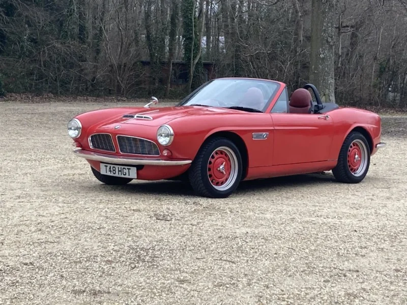

Before I place my tribute order I would really like to see a 507 kit in the flesh, doesn't need to be completed, is anyone near to Reading, Berkshire?
I live near Beaulieu in the New Forest so you’re welcome to come and view mine,
Dxbolton
Jun 19, 2020
119
New Forest
2.8 auto
Not cheap but the yellow one is very nicely presented.
Blue one looks good as well.
Looks as if they've been built to sell- not diy projects.
If I’m being picky (which I am) have you looked closely at the seat stitching? It wobbles all over the place. Other parts are cleverly built, and put together.
I am sure they were built just to sell onwards too.

Yes you are !!! I'd give them the benefit of doubt around the side bolsters (camera angle?) but the most visible areas over the tops deffo show that.
Does that give them an artisan-build caché or have you spoilt them for me?;););)
Dxbolton
Jun 19, 2020
119
New Forest
2.8 auto
Whilst I hope they achieve their asking price, I could probably sell mine for less and still be happy with the upside.
I won’t mention the other things that niggle me because once seen, you won’t unsee them, like silver painted bumpers and grilles.
other parts are really good though like the bonnet bulge grille vents 👌

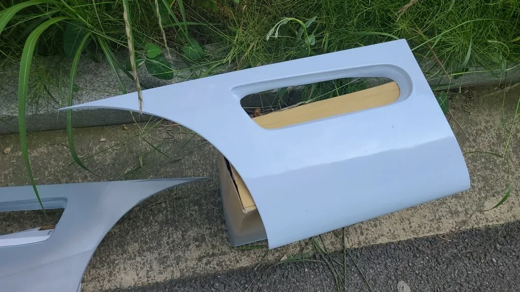

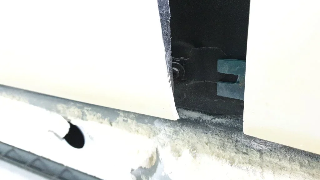

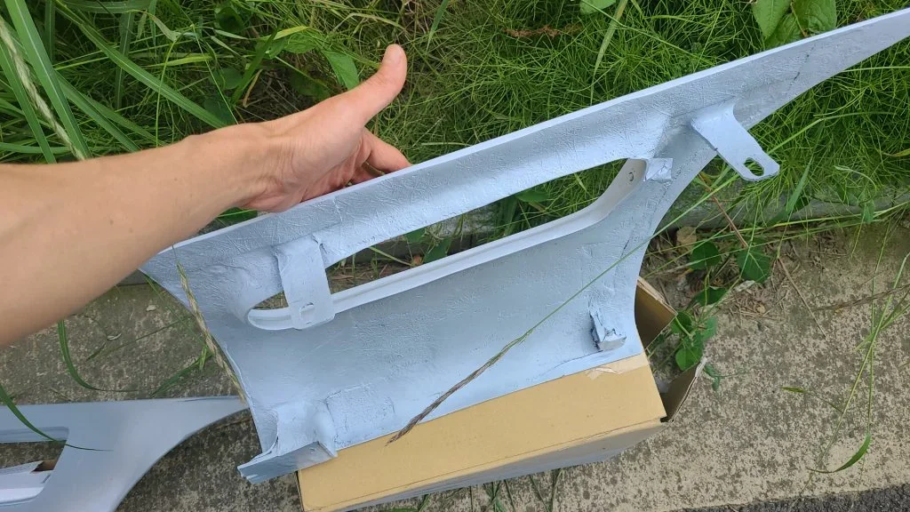

Panel gaps around the car were actually pretty good.
Except for the doors. Which are terrible
Cut away the gelcoat to expose the fibres and rough up the edges to give the new grp something to bond to.
Clag it in there
I had to move the swage line but I did that a couple weeks ago. Previous page.
The gap is now around 5 or 6mm so still pretty big but at least the front shell is straight now. The leading edge of the door isn't straight so that'll need a mm too. But also the way the z3 hinges work with the wider doors means the door swings forwards when opening and makes contact with the rear edge of the front wing so a biggish gap is necessary. Maybe 5 or 6mm is as close as I can get it.

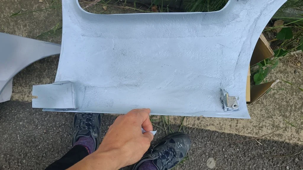

Another idea I'm toying with is to cut it across here just below the swage line
and bolt the bottom part to the metalwork just like the Z3.
The wiring for the turn signal is there by the A pillar. Also, lifting the front will be nicer on the wheelarch liner without that panel swinging forward. Also be able to have that panel perfectly aligned with the door panel and sill.
Won't be an easy cut because the panel is double skinned and the bonnet hinges are roughly inline with where I want to cut.
Need to think about this one but I do like the idea. Watch this space.
