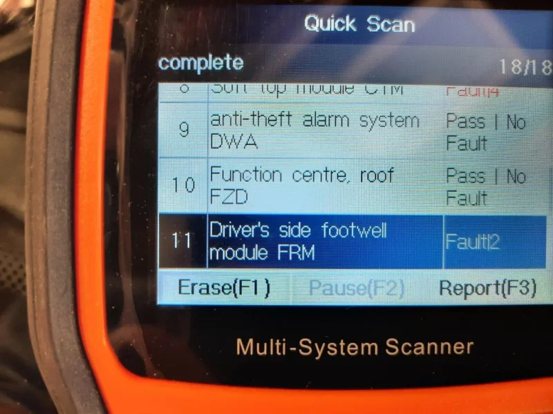

Gremlins appear when you least expect it. On Sunday evening I experienced one such as I parked at the Mandarin at Saxilby. The roof on my car raised, up to the part where the rear part closed. Pressed the button on the remote again and it finished the cycle. It happened again on Monday so after getting the Eos polished today I started looking into the Z4 roof.
Started with reading the codes. Some, possibly all obviously historic.
I cleared all the codes and went for a run round the road test loop. Re read the codes and nothing, as yet, has returned. The rear lights faults, I have receipts for 2 new rear light units. The radio fault, I have used the "hands free" with no issues (mic working fine). A/C is arctic so I'm guessing it was repaired too. Only possible one causing issue would be the "soft top module" CTM.
I've removed the module I bought when in the States because I hadn't managed to get it coded to the requirements I wanted, so it's back to "factory" for now. Hopefully a quick refit and "talk" to it this on Saturday.

What was the fault in the end / what was the final fix, if you dont mind me asking ? (thinking ahead for when mine fails, natural pessimist me)
Hubba-HUBBA !
It turned out to be the micro switch(es) on the rear deck Alex. Someone suggested through their own experience that it could be this, and as it is someone who's knowledge I have come to respect I went with that. 2 new switches from Sopers were under £30 so it made sense to replace both. I'm going to hook the module up to my PC tonight and try to see if any of the settings remain. The open/close via the key in the door which Keith kindly coded for me at Thoresby last year seems to have been erased possibly by me resetting the roof module with my Foxwell tool. I may change the switch on the O/S of the windscreen rail because apparently this can reduce the"slam" of the roof when closing.
