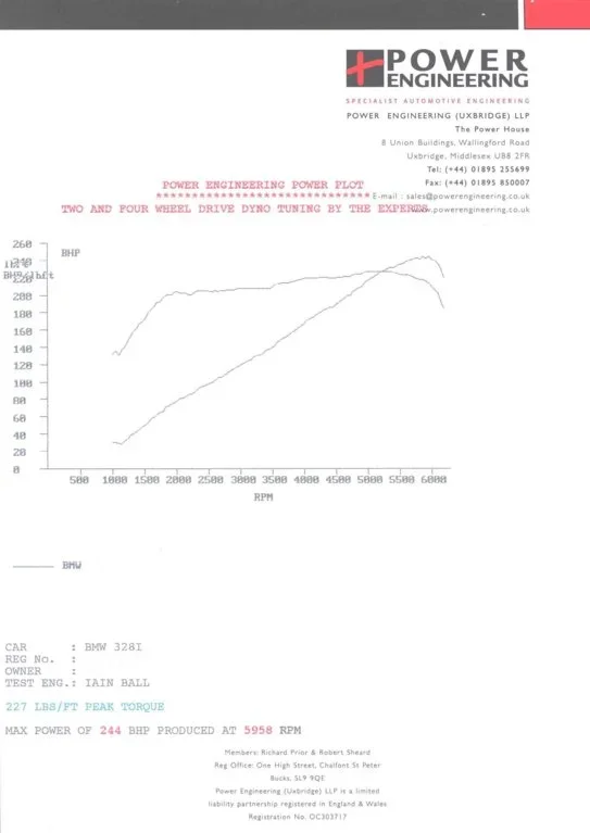

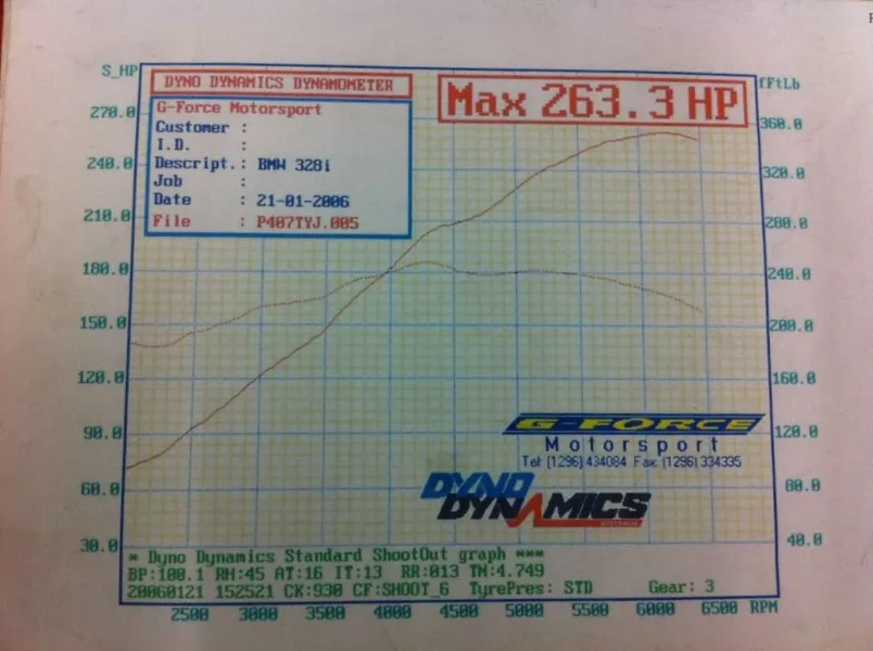

The kit I bought was a machined plate to attach the m52 throttle body to the m50 manifold, asc unit and throttle body bored to 68mm and 2 machined adapters to bolt the fuel rail to the manifold.
The adapters need to be a certain thickness so that the injectors sit at the correct height.
The manfold adds torque up the rev range allowing the car to pull all the way to redline, whilst the TB improves responseiveness - most notable in 1st and 2nd gear.
