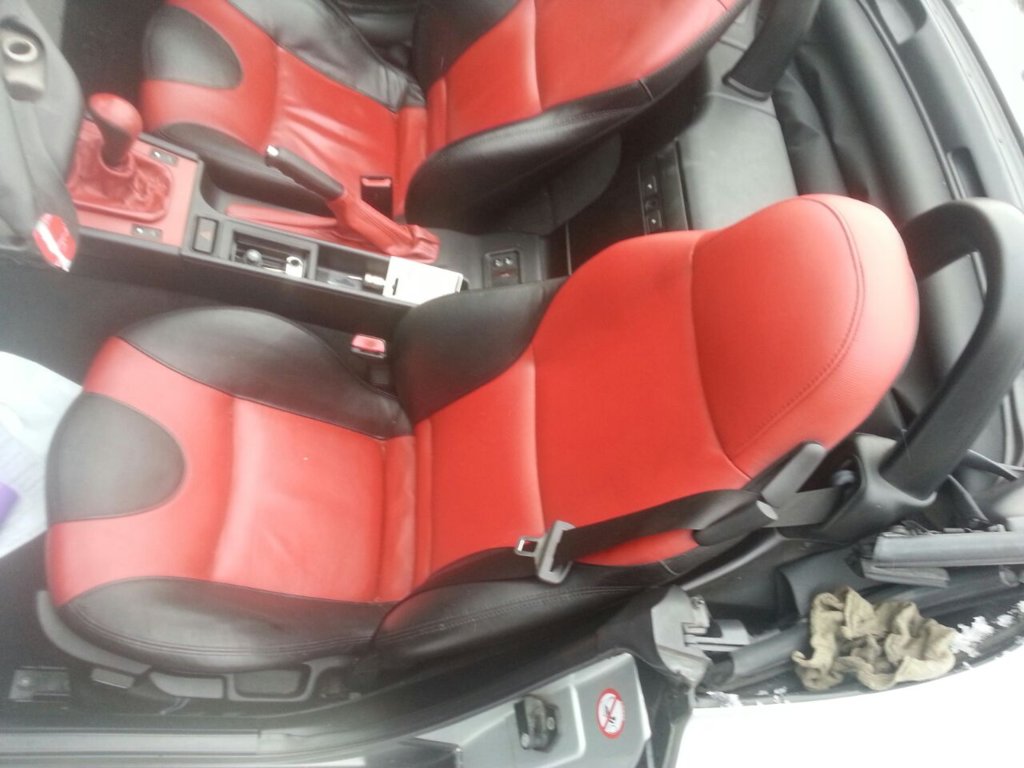

And then in a days work:
Replaced b&q compost bag (lol previous owner) door liner with BMW sound insulation - PN 51488410037 & 51488410038
Fitted new door cards
Replaced //M seats worn bushes to stop rocking
Stripped leather off drivers seat to repair the heated seat base wiring and reinforce the bolster, exactly same issues as in Gookah's guide
Fitted both new seats - loom adapter required PN 61106916218
Replaced the drivers seat belt tensioner loom with the loom from my existing drivers seat as the wiring was changed, possibly due to a BMW changing them over under warranty I think
Remove roll hoops and fitted rear stowage box, then refit hoops
Forgot to get the relay for the heated seats so I used the horn relay and currently just shout at other drivers
