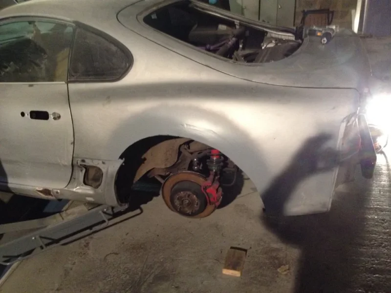

Spare time is usually spent walking the dog. And build my mates v8 supra (nearly finished) But soon all my time will be spent being a dad.
BMW 5 speed gearbox cut and mated to a Toyota auto bell housing. And yes it dose work.

So i have done no work to mine at all this year really partly because i have been helping with the supra. Its had a full body respray all new suspension body loom and heltec ecu. To run a 4.0l lexus 1uz v8 we have built a hybrid BMW/Lexus manual box with a tilton clutch and virtually everything has either had to modified or custom made to work. Engine mounts plenum injectors PAS system oil filter cooling system crank case breather and catch tank to name a few. Its been a whole year in the making with lots of highs and many more lows. But we got it driving under its own power this weekend :thumbsup::thumbsup:
